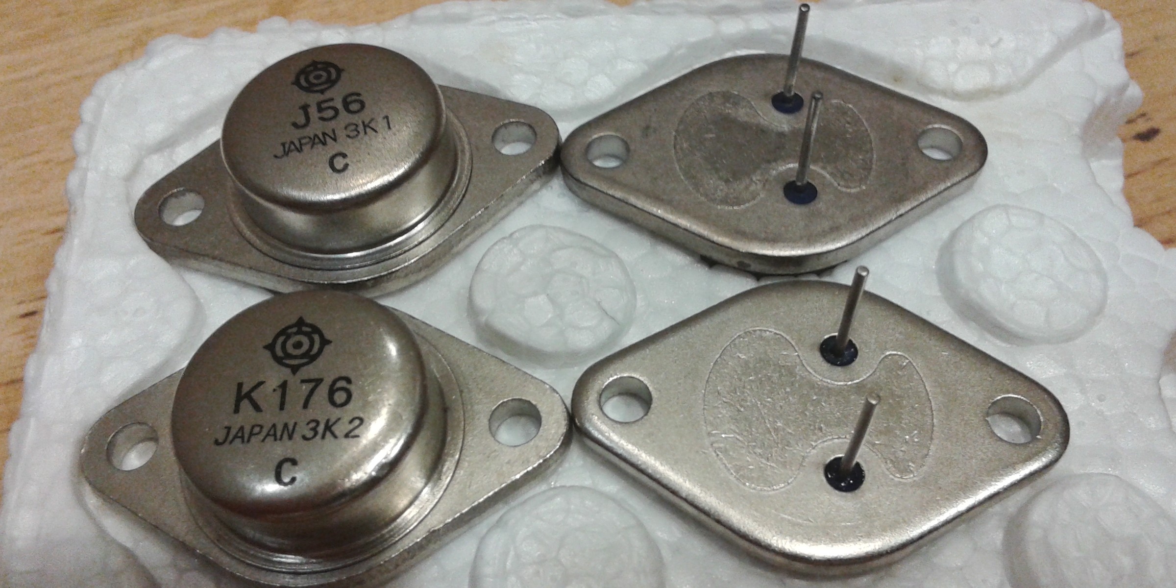

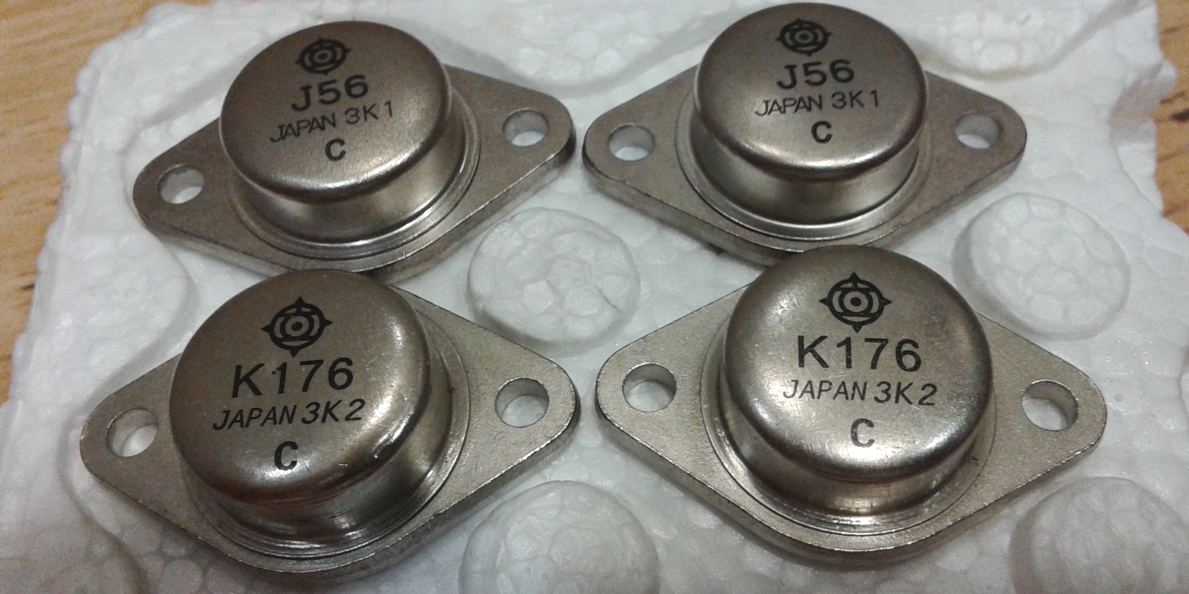

Got these 2SK176/2SJ56 transistors from a electronic store in China, I'm wondering if someone can comment whether they look real or fake.
The store offers me a one month period for return/refund, so long as i don't solder or burn them. I only have a DMM and a scope meter that can generate audio frequency signals, what are the tests I could do to determine if they're real?
Thanks and regards.

just count on lower Ugs , comparing to IRF series
@Id=25mA, Vgs of the two 2SK176s were measured to be 290mV and 315mV respectively, while a TO-247 IRFP140N was measured to be 3.8V. Is that a good sign?
I think so, stated on the datasheet for 2SK176 Vgs off is min 0.55V max 3.0V @ Id 100mA and Vds 10V.
Thanks, I looked at the datasheet I downloaded (attached) and it says min 0.15V and max 1.45V for Vgs off. Are there different varieties of 2SK176?
try higher Id
Found a 15R and 30R 10W resistor in the parts bin:
@Id=345mA, Vgs=1.18V and 1.15V for the 2 2SK176
@Id=610mA, Vgs=1.65V and 1.60V
Not a lot of data points but seems to match the Id vs Vgs curve in the datasheet
Referenced datasheet attached for additional info. But, as ZM said, your K176 measurement looks good, not bipolar nor vertical Mosfet nor Jfet, unlikely to be fake.. . . Are there different varieties of 2SK176? . . .
