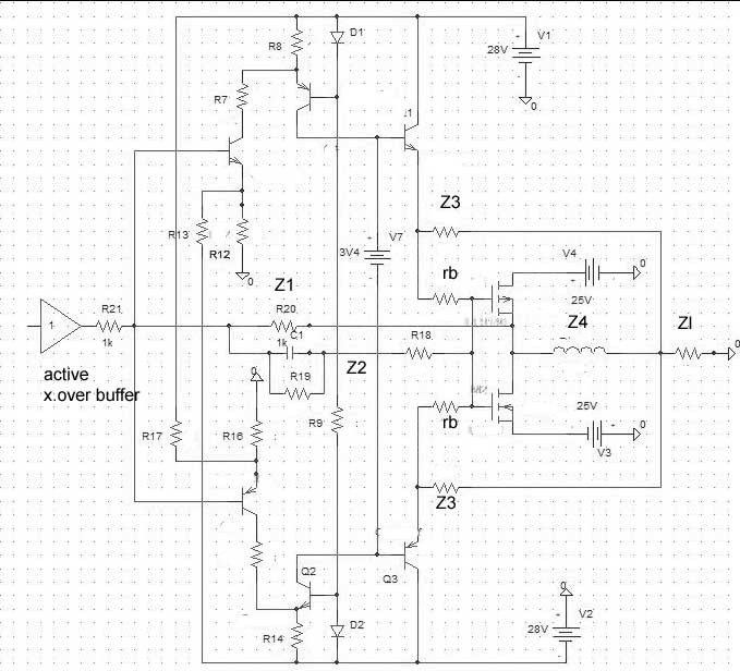

Current dumping amp Scottish version
I don't know whether Scotsmen are thrifty...rather I think they use resources effectively. Anyway this current dumping amp gets along with 8 active transistors plus 1 Vbe multiplier. After all no transistors
create no signal errors. A Sorites paradox, I know.
Diodes are green LEds forward voltage about 2.3 Volts.
The class A driver has a high open loop gain Go the common collector driver provides low Zo thus that rb=Zo/Go*(1+Z2/R1+Z2/Ri) can be implemented as the RC given by a real rb and the Cgs of the FETs.
Z2 is implemented as R18 C1 R19.
The class A is very fast this topology does not require Miller capacitors.
This amp is intended only as driver for active speakers so the current feedback to inverting input which is a virtual ground is not a disadvantage because the input is tied to the output of a buffer of the active crossover with a known output impedance.
The circuit schematic looks promising as for now I don't have an idea whether it will work.

No paradox or contradiction here, simplicity is a good principle, the tricky part is determining its level. (I would omit Q1/Q3).After all no transistors create no signal errors. A Sorites paradox, I know.
Lumba
Q1 Q3 cannot be omitted this common collector push pull stage provides both high Go and low Zo further the input cascade quiescent current must be set with respect to high fT and low noise. That is for
epiplanar BJT met at about 3mA to 5 mA. The quiescent current of Q1 Q3 is set to 100 mA .
Anyway I am not sure whether it will work.

Re: Current dumping amp Scottish version
Well it works however the calculation according to theory of Z1 thru Z4 does not yield optimum results in practice some fine tuning is
required. But primarily results are promising the current dumping amp can be made pretty fast so far I've achieved a rise time of
15 V/usec. Crossover distortion can be shifted to 8 kHz and up.
Unfortunately BUZ900 BUZ906 became unavailable I have just one pair for testing. This device has a low junction to case resistance
so I could get 50 Watts in 8 ohms with present heatsinks these cannot be made any bigger due to volume restrictions in the speaker enclosure.

The difficulty with DIY a current dumping amp is indeed the inductor.
If computation ( it will yield, if correctly done, optimum values for
the 4 bridge elements ) results a particular inductivity L then how would one make an inductor which has, amongst other properties,
the inductivity L?
The most exact approximation is a straight (nowhere bent or curved) wire. That however would turn out a bit long, about 3.05 meters for 3uH.
The best approximation of a straight wire is a spiral. However there is exactly one straight wire but as many as you please spirals.
A cylindrical coil inductor is not well predictable in terms of inductivity
by approximate formula one has to expect deviations in the range of 20% + or - . It must further be expected that due to electromagnetic
forces the inductivity will depend on the current value.
So I am quite suspicious about enthusiastic reports about DIY current dumping amps if it is nowhere mentioned how the inductivity is physically realized.

Sure inexpensive DMMs come with inductance and capacitance range..
However from the current dumping theory it is evident that the insensitivity to power transistor properties comes at the price of
"infinite" accuracy of the passive bridge components.
( As well as "infinite" gain of the class A)
Only a printed inductor is reproducible in terms of inductance.
So one has to do it only once - it is the same difference as between
hand writing and typing ASCII code for characters. To decode hand written symbols you need a powerful computer brain or such but any simple logic gate can decode ASCII coded bytes....
