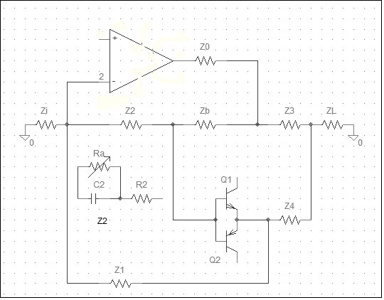

The Quad 405 error null balance condition does not hold in a real world as the class A amplifier gain is not infinite and it does not have an infinite gain bandwidth product either. That means its output impedance Z0 is not zero.
In the real world the error null condition reads
Z2*Z4=Z1*Z3+ ( Z1*Zb +(Z1*Z3*Zb/Z0))
If gain is infinite Z0 is zero and Zb is zero so in this case the last term in brackets is 0/0 and here that yields 0 so we have the familiar but unrealistic Quad current dumper condition Z2*Z4=Z1*Z3
A usual common emitter voltage amplifier in class A may have Z0 in the range of 50-100 Ohms this cannot be neglected.
It is no longer feasible without further consideration to have Z2 as a capacitor and Z4 an inductor. Favorably Z2 should be a capaictor in series with a resistor to determine unity gain frequency.
So in practice one must have an integrated IC opamp as class A amplifier having a very high open loop gain and also high open loop bandwidth. It is feasible to realize a current dumping error corrected power amp with a low open loop gain discrete class A amp but thir requires a lot of engineering elaborate.

hahfran,
That price is too high according to my consideration.So in practice one must have an integrated IC opamp as class A amplifier having a very high open loop gain
How much work would it take for you?It is feasible to realize a current dumping error corrected power amp with a low open loop gain discrete class A amp but thir requires a lot of engineering elaborate.
A big lot of work and equipment that would be outright too expensive. The not-nulled error shows up as small spikes in the
zero cross region of the signal and that is nothing but crossover distortion. One had to start up by calculating C2 and R2 to determine the unity gain frequency of the class A and has to have
Zi,Z1, Z3 variable. Further the inductor Z4 has an inevitable series resistance which must also be compensated with Ra.
It is all feasible but the result won't be significantly better than
a standard negative feedback however with lots more tuning effort. At the very end of the analysis it turns out why forward error correction never made it into mass production amps , with the exception of Quad.

Forward error correction is a wide field for DIY. In the schematic
Zb could be implemented as a signal controlled variable resistor i.e. by a FET.
The class A could be a hybrid , tubes for voltage gain and a push pull FET output delivers current i.e transforms voltage to current.

hahfran said:The Quad 405 error null balance condition does not hold in a real world as the class A amplifier gain is not infinite and it does not have an infinite gain bandwidth product either. That means its output impedance Z0 is not zero.
That's why in first QUAD's class A stage is a triplett follower, ensuring a huge gain. Later this was changed to a dublet, which still offer lot of gain and above condion is satisfied quite well.
hahfran said:A usual common emitter voltage amplifier in class A may have Z0 in the range of 50-100 Ohms this cannot be neglected.
Well this is not quite a must. A good example is QUAD where opamp is not part of class A stage.

The error null condition holds for very high open loop gain of class A AND for very high open loop gain bandwidth product AND for dumper drive current that is proportional to signal amplitude.
This is just not the case if dumpers are FETs because then the drive current is proportional to the first derivative of signal to time multiplied with signal amplitude. At least from theory I do not see how this could be compensated, or , error nulled.
If one has to design for gain 90 dB and gain bandwidth 100 Mhz
then one could as well bring this down to 20 dB with application of negative feedback. Of course this will not reduce crossover distortion significantly. There is the distinct advantage of the current dumping. The disadvantage is that one has to match the
upper frequency limits of dumpers and class A driver and a simple way to achieve that is to have an RC feedback of the class A. Then however the Quad error null condition does not hold.
