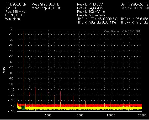

I'm using 600 mV and have not seen a dramatic change with lower levels. 500 mV to 600 mV is 1.5 dB. Please try a higher resolution on your measurements. 8192 is really low resolution, useful only for very fast acquisition of a measurement.

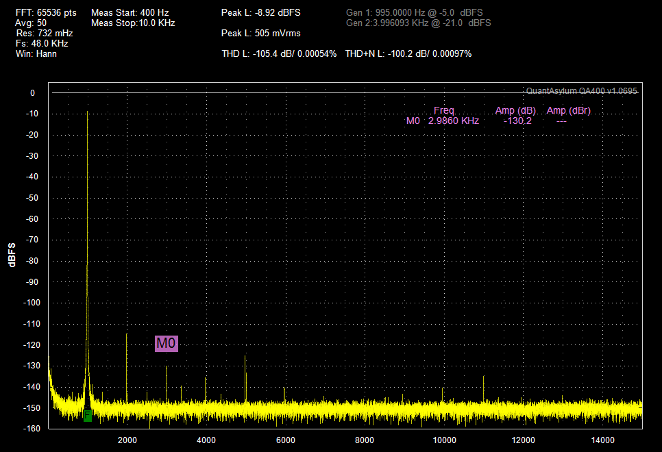

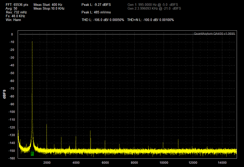

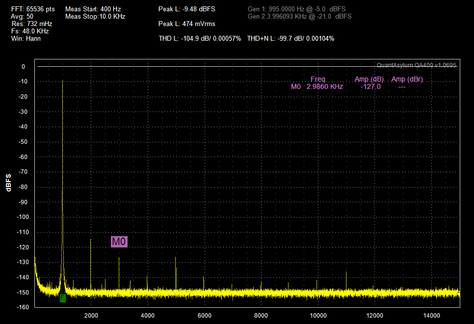

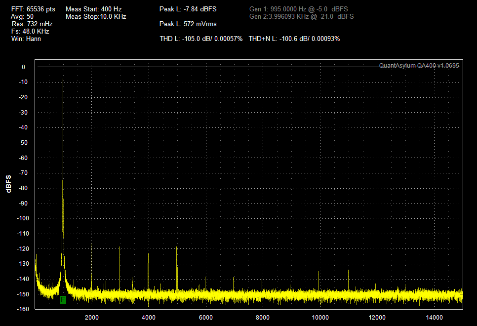

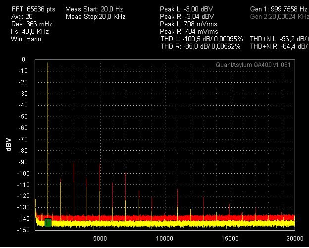

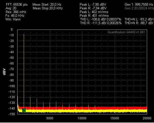

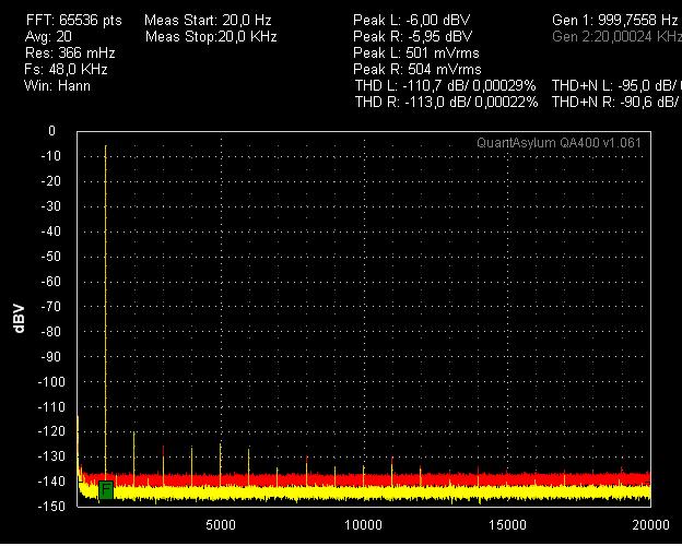

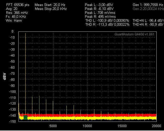

OK, attached a sequence of measurements at 400mVrms, 500mVrms, 600mVrms, 700mVrms with higher res.
Always left chanel direct wired for reference and right chanel with buffers+filter.
Levels above 500mVrms/700mVp definitely show a dramatic impact on my QA400.
Are you sure about your 600mVrms? Your postings show 700...800mVrms.

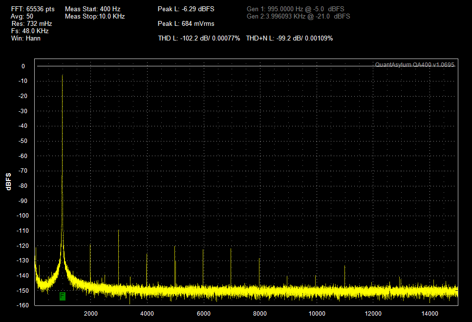

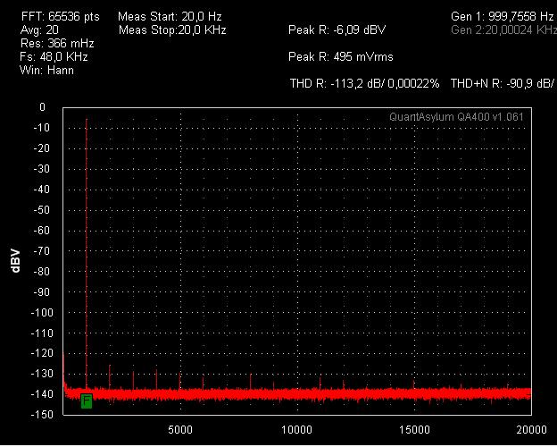

Increase of distortion above 500mVrms seems to be caused by the input. The second last picture shows the situation when going for 700mVrms at the output, but attenuating the right chanel to 500mV at the input using the buffers and filter.Choco (and Demian), it's not clear to me whether the 500mV sweet spot is just the analyzer part or also related to the QA400 source?
IOW, in loopback, what causes the rising distortion with level, the source or the analyzer?
jan
Last picture shows only the right chanel with 700mVrms output and 500mVrms input using the buffers and filter.
Another interesting point visible from the first 4 pictures is that the distortion of my input buffer and filter seems to increase above 500mVrms even more than the QA400 (comparison left vs right). Most likely related to my clamping which protects the QA400 vs voltages above +/-1.3Vp.
Here is what I get at 500, 600, 700,1000 mV. I need to recalibrate mine, probably new software or ??? These were measured RMS levels using a seperate meter. My QA400 reports clipping at any input above 1V RMS sine wave even though it actually has good readings. The 3rd harmonic rises pretty quickly above 500 mV and the 2nd above 700 mV. The last two show the effect of source resistance (actually ithe input non-linearity of the QA400) The first is a 50 Ohm source, the second is a 600 Ohm source. The third harmonic increased by 3 dB. This is also visible on the source side using an analyzer connected in parallel.
I don't think that it is an mayor issue with calibration. I calibrated mine in the beginning and it shows a good fit between scope, DMM and QA400 readings. But also without calibration there was not a big difference.Here is what I get at 500, 600, 700,1000 mV.

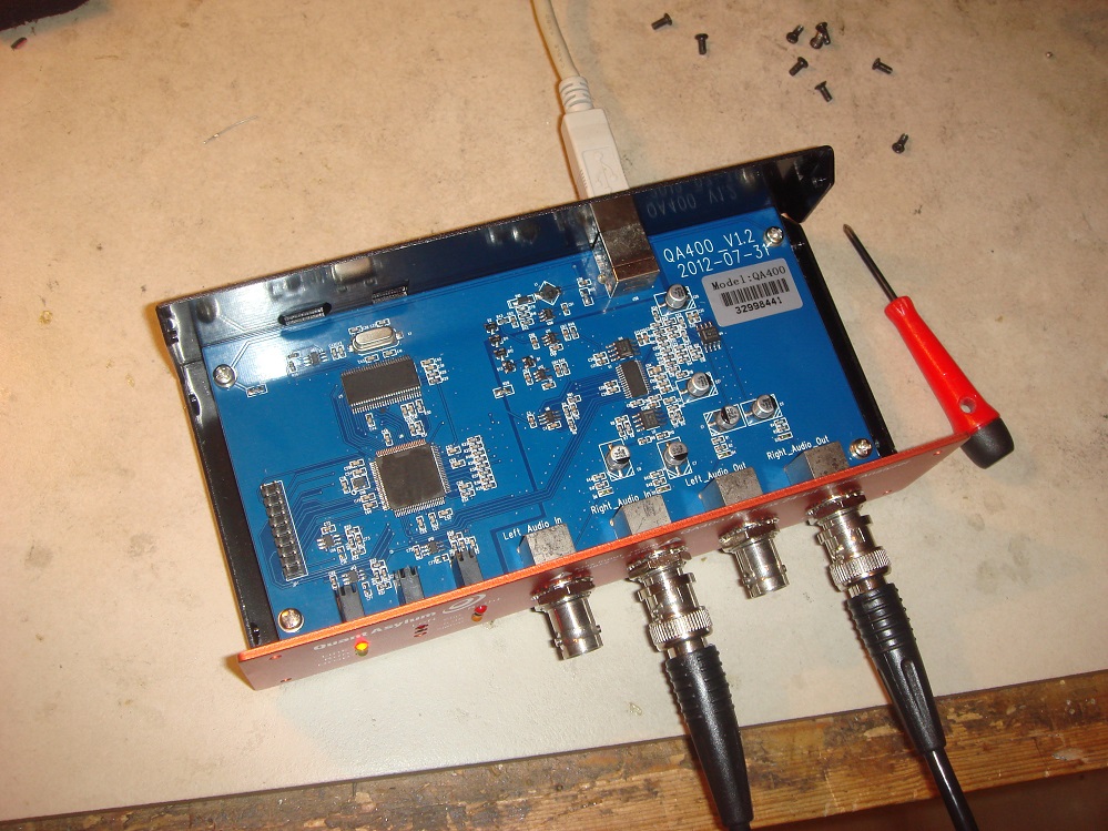

Another topic could be the coupling caps inside the QA400.
If the description is right - they use an electrolytic in reversed polarity at multiple places in the signal path. Strange.
Did anyone open the QA400 and look if these e-caps are really operated with reversed polarity, or is this just an error in the description? Why would one place an e-cap in that way that it is sytematically operating in reverse polarity when a DC-free source/load is connected?
Its all there in the past pages. But, yes... and I changed my input caps to bipolar types and picked up several dB of lower distortion. Not a lot but was hoping it would all add up to significant. But, the non-linearity below -100dB makes it all for not, anyway.
