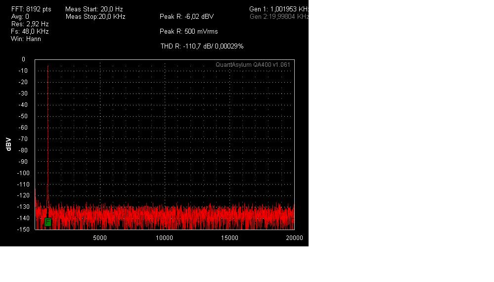

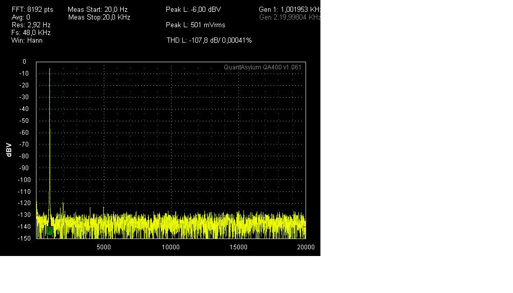

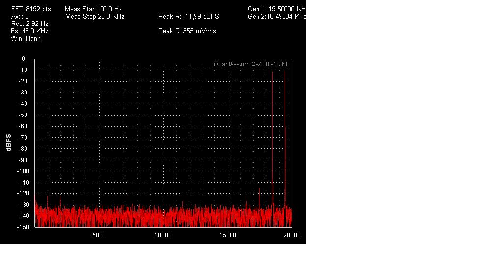

Hi Bear,
the sweet spot of my unit is at 500mVrms.
So I am always adjusting the buffers to run the QA in the sweet spot.
The shown results with filter and buffer are looking identical between
Output gain =1 (input gain also 1) up to output gain =7 (input gain adjusted to 1/7). When the output buffer has to deliver signals above 5Vp, then the distortion starts to rise.

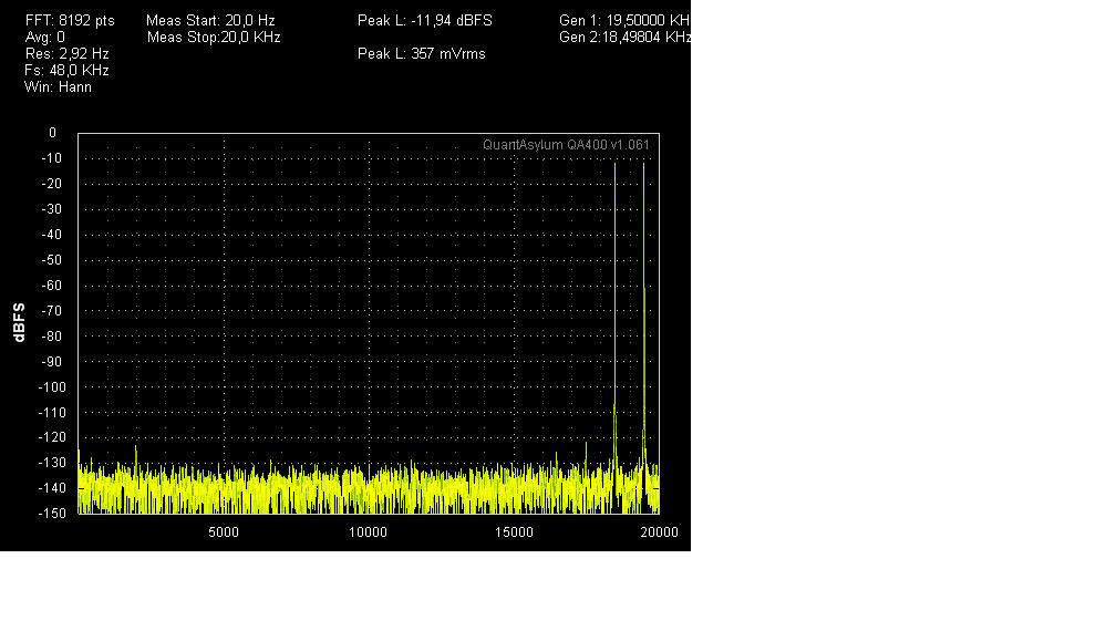

Attached the loop back results of the QA400 alone - done some weeks ago, right after I received the unit 😛
Also my QA has small difference between left and right.
Overvall the right chanel is slightly better, that's why I am using it.
Will look into 192kHz next....
