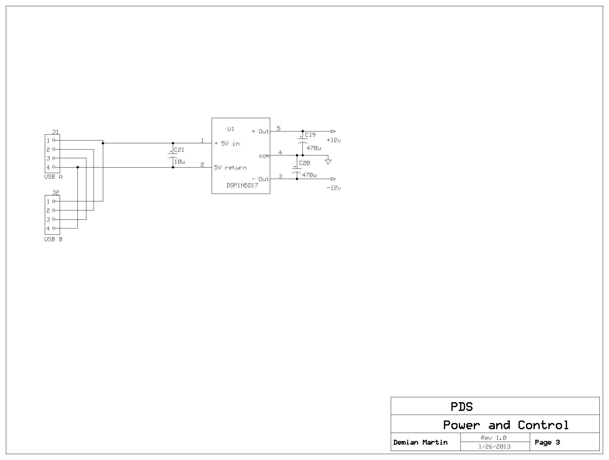

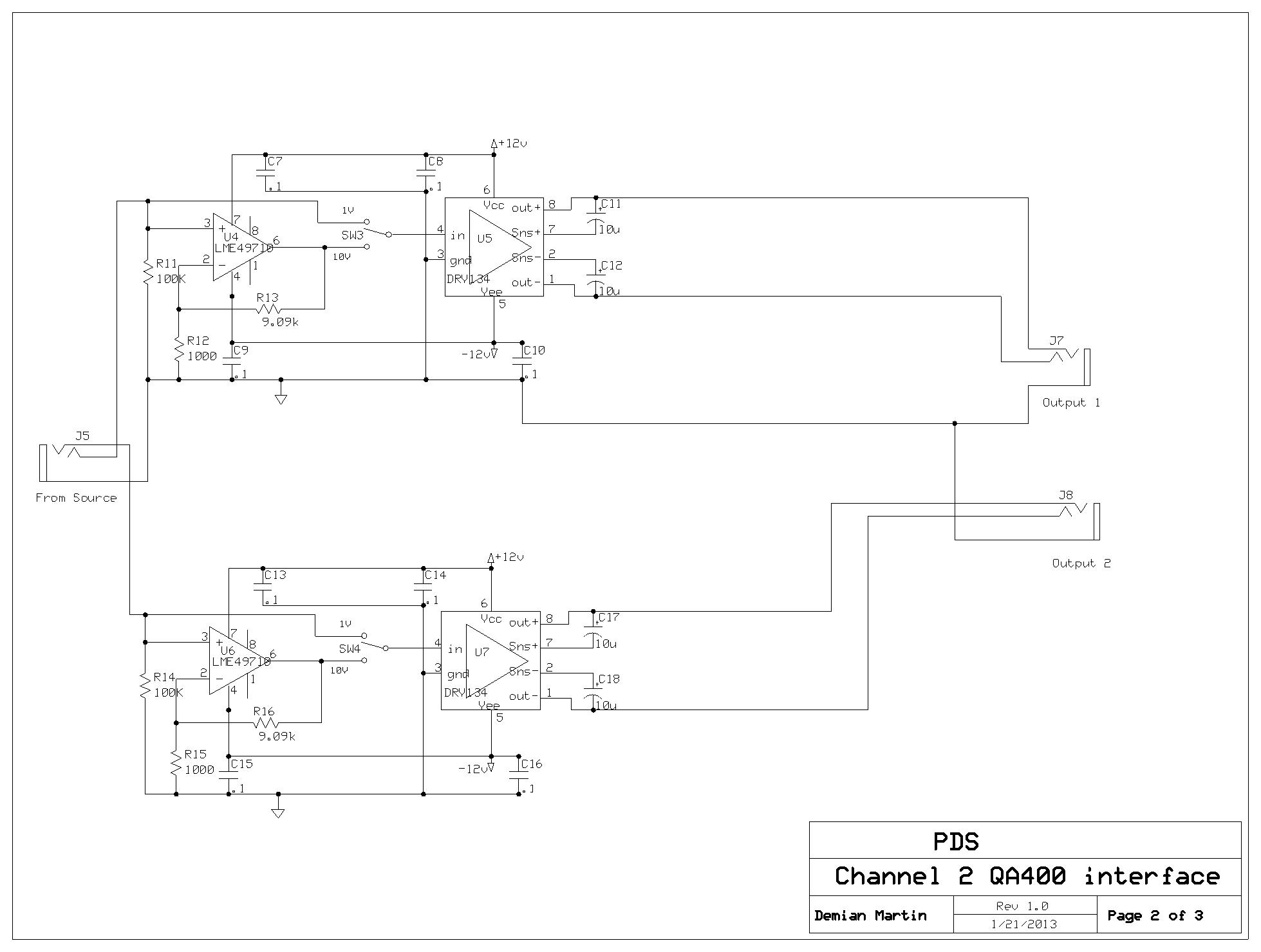

I am attaching the schematic and layout, all in Expresspcb ExpressPCB - Free PCB layout software - Low cost circuit boards - Top quality PCB manufacturing since I feel its very appropriate to this project. Please feel free to point out the dumb mistakes I made and improve it. The software is free from them.
PLEASE DON'T ORDER ANYTHING UNTIL I KNOW IT WORKS! I will post a revised version after I have made the first ones work.

Thanks for the drawings. Yeah, the circuit looks a lot like Pete Millett's sound card interface without the metering, protection, and range-switching circuitry. Since this will be used with a high-performance measuring instrument there will undoubtedly be some discussion about the choice of active devices - e.g., INA134/DRV134 versus offerings from THAT Corp ( http://www.thatcorp.com/THAT_IC_Selection_Guide.shtml ), etc.
Looks like there may be a typo on the power converter chip's part number. I think you meant to call out the " DSP1N5D12 " sted " DSP1N5D17 ".
Dale
Joined 2004
The THAT parts (impossible name, just try to Google them) are interchangeable with the TI (and I think (ADI) parts. The receiver has the caps for the THAT but they aren't used in the other devices. I have samples of TI and THAT to try. I'll see what works.
The 17V is intentional. I need enough voltage to get 10V RMS out. I'll know very soon if it works and what the downsides are. The converter is expensive so lets see if it works right for this.
. . . The 17V is intentional. I need enough voltage to get 10V RMS out. . . .
That makes sense. I was confused because +/-17V is a rather unusual choice for supply rails, and the other two diagrams showed +/-12V rails. I'm sure you have verified all of the absolute max voltage ratings - there are a few "full voltage" IC's where +/-17V rails are right at, or over, the rated capability.
Dale
Joined 2004
Dale
Me being lazy with the cad software. 12V rails are included so i hijacked them. the +/-17V supply is a stock part. i will be going though datasheets some more. Many pro market IC's run on +/- 24V.
