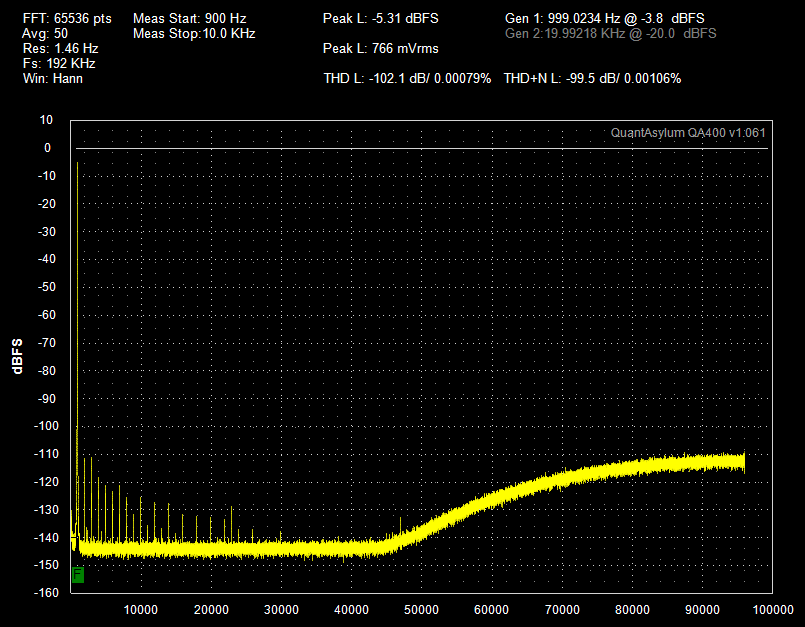

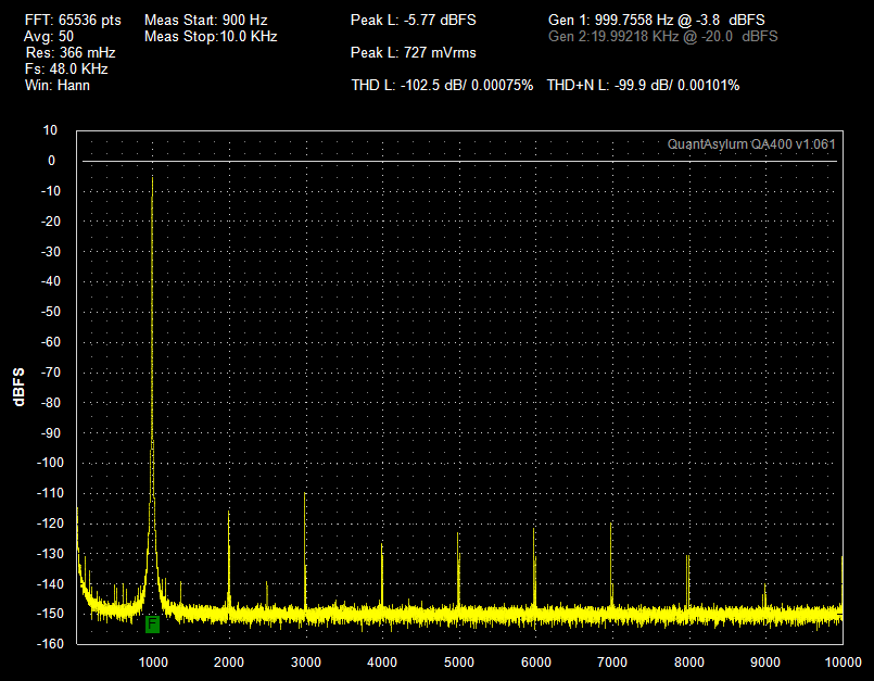

QA400 ADC FFT
Here is what I'm getting with KH4400 to QA400, 1 KHz at .7V with the laptop connected to the charger. It seems pretty clean

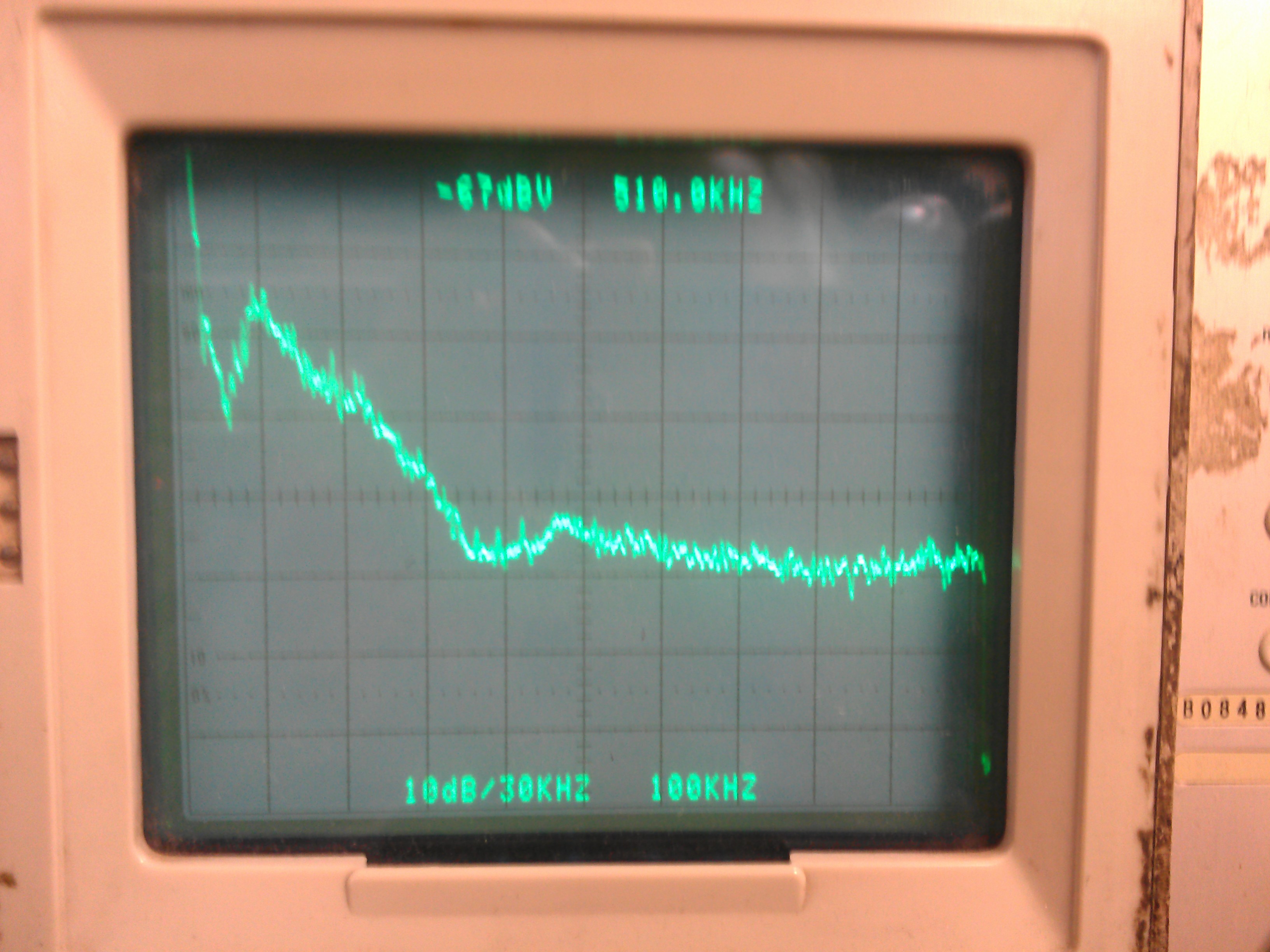

This is the first MHz of the QA400. It shows the usual noise shaping but nothing unexpected, even out to 5 MHz. The wide band spectrum analyzer is in storage so no view above 5 MHz for now.
(0-1 MHz 10 dB per division, the 1 KHz is overloading the input but that won't adffect what we are seeing.)
