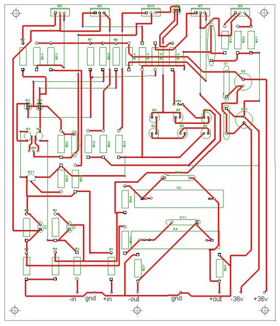

Anyone have a quick mockup of a -+36vdc supply with torrid size and all ???? - Just for testing (I do not plan to make shuntreg's right now)
Jesper.
Take a look at the BOZ article....it's got all the info you need, there's even a PCB layout. All you gotta figure yourself is the zener value.

I know... Just trying some sim... with a 2x40vac torrid
Jesper
2*40V should be fine....I didn't really pay attention to the fact that you need a negative supply as well, in that case you should use the BOSOZ PSU board design instead.
....but don't you already have a BOSOZ? In that case all you gotta do is to adjust the zener string and fit the 2*40V trafo

I need another psu, not the one sitting in my bosoz...
A 40vac x2, 610 / 9610 + zenerstring of 41v with 2,5mA running through + 10000uF smooties and a load of 2A on both - and + rail, simulates fine, so i think i will try that out one at the next day's.

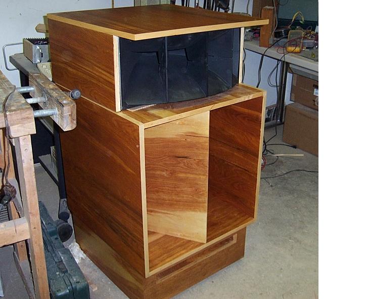

Seriously. Quick test - bass bins full range/ 22uf and couple ohms on 902 driver/ both sides in parallel on junky Technics receiver 1 channel. This, my friends, is not an optimal set up
OH BOY! attack, speed, dynamic, and come pretty close to sounding real good. I think they'll tweak into something special.
according to thread's title
ya don't need F4 to drive that drek
make with beafier opt stage and drive them directly
