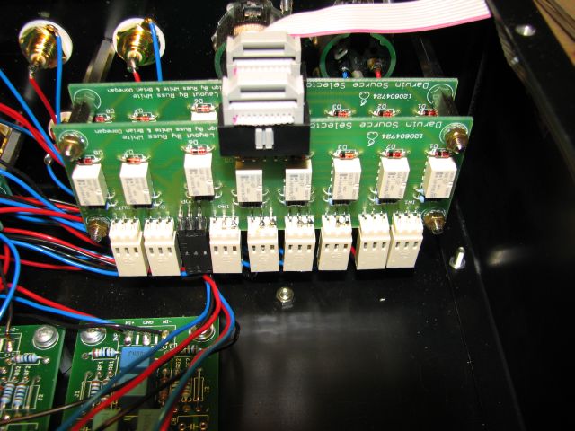

steenoe said:Fully balanced rearpanel..
that reminds me .......
steen - you tried chip susy preamp ....... ? ( if I remember that well)
what's difference comparing it to Pumpie ........ neglecting output swing issue ..

Manu said:What should I say, Clean job Steen
Please Bwana , you know I always need some explanations, even if its obvious for the most.
Manu
Greedy to learn
Take a close look at ZM's picture. The -IN is simply shorted to ground at the header, (connecting the particular input) through a small piece of tinned CU wire, so when the relay of that particular input is selected, it will automatically short -IN to GND. Pretty bright idea, or what...
The twisted X-driver, as they call it, actually does perform wonders. I like it a lot, indeed. If its for sentimental reasons I dont know, but I find the Pumpkin more musical and a tad less "clinical" to listen to. Noisewise the Twisted X driver is the winner. I never experienced anything like it. With the volume at full throttle (no signal ofcourse) there isn't even the least bit of hiss The Pumpkin is absolutelly good in that respect also, but there is a slight trace of hiss at full output. Not that it matters for all practical purposes at all. That slight hiss, can never be heard with a signal on
Having been listening to the Pumpkin for a while now, I must confess that it is my preamp of choice! It simply does have it all: Sweet silky topend details, very nice and warm midrange (voices) and a very firm bottomend! Now thats all pretty much heard before, but the Pumpkin has the very important "Foot-tapping"-effect like a X-BosoZ I never thought that I would find that combination in one preamp! But here it is. I find it hard to keep my feet still, when using the Pumpkin
Thanks a lot, Choky
there is no need to thank me ........ and to make me blush ( even if that is pretty impossible ) ;
I was interested in exact difference (sound etc. ) between these two sides of same coin...... hehe - even if mine is pretty gray comparing it to certain complexity of chips ...... ...... thinking about difference in efforts to make one or another and final results ....
in any case - if these chippy dreks are made by Papa's pattie pattie , they can't be bad ..... so easily
btw - I can't find exact schmtc of twisted X without too much trouble ..... (seems that today search func and me aren't in good relation )
have you linkie to exact post ............
hehe - I can bother ya - seems that your shoulder is certainly better - more than one post in a week

Manu said:Steen, Thanks, but I have to think a little bit about...
(You mean that said input is then always RCA?, definitively non-XLR, nevermore...)
steen was just too lazy to put all XLRs and RCAs on every input , and make some nice U shorties ...... for 1&3 marked holes
