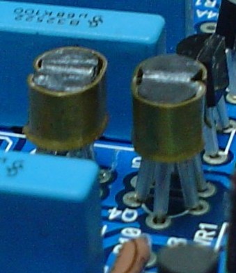

look for Jaccovitty's pics
narrow sheet of Cu or Al tin formed as O
The brass things i posted (P789) are not DIY, they're serial production heatsinks for 92s.
The bottom edge is flared to add some spring resistance that makes them clamp the little ones and not slide down slowly.
Making them like that is not all that easy, you'd have to machine a 2-piece mold to press the flare.
The easy way would be to fold a thin strip of brass/copper around the devices, then tighten it with a chica plastica

Leads have a considerable effect on the cooling factor of semis/resistors, from that on their operating temperature.
(for lesistols, the distance to the PCB is also vely impoltant, read a tech paper on lead length and mounting height from e.g. Vishay)
An amp case needs to be ventilated, the airflow within the case is not a stasis situation.
Most of the cooling will take place at the top of the Baldricks if the leads are insulated with teflon leggings, more uniform

jacco vermeulen said:The brass things i posted (P789) are not DIY, they're serial production heatsinks for 92s.
(Ruben Blades: fav. actor and all-time abfav. salsero)
Manu said:Thx a lot Jacco
I post this your pic again ( If I may)
Interesting too are the isolation of zistors legs ,
I didn't notice it the firts time a saw the pic.
Very nice and accurate work.
Manu

and - makin' these Jaccovitty cool stuff is POC - you don't need even to make that skirt of one edge
http://www.diyaudio.com/forums/showthread.php?postid=1237712#post1237712
http://www.diyaudio.com/forums/showthread.php?postid=1237714#post1237714
http://www.diyaudio.com/forums/showthread.php?postid=1244829#post1244829
http://www.diyaudio.com/forums/showthread.php?postid=1244830#post1244830
ya can do it that way too ....... even nicer
