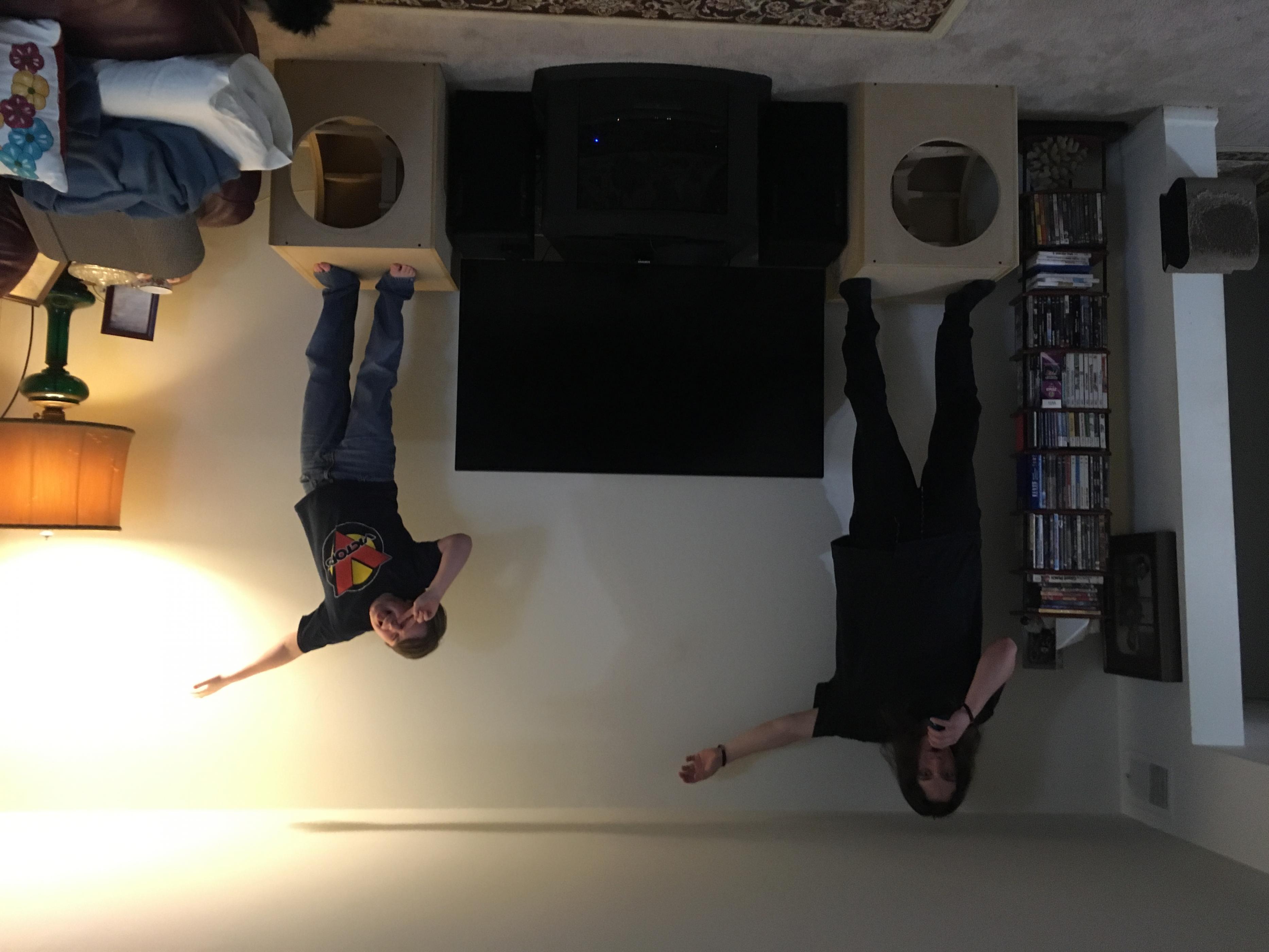

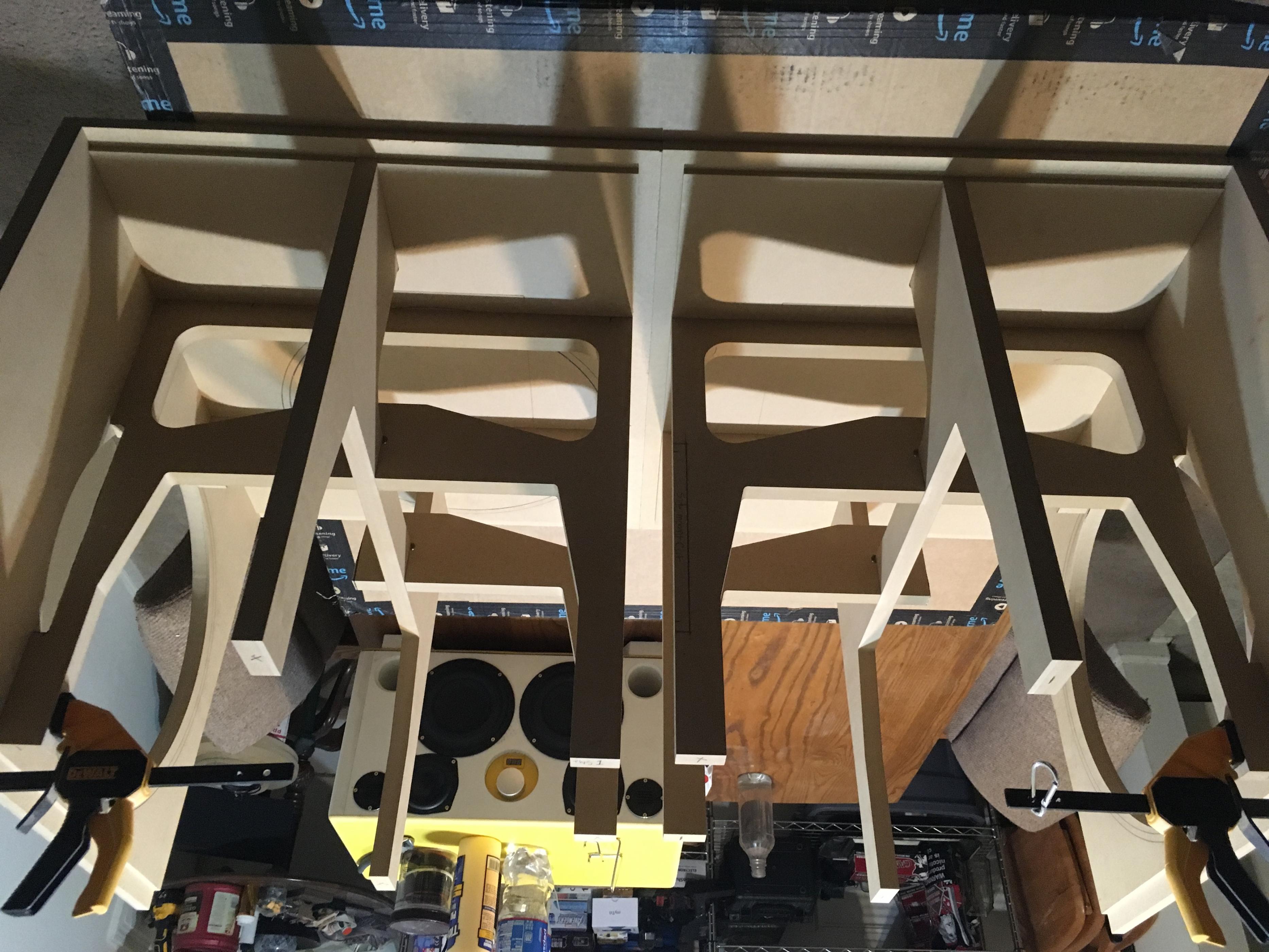

My two Sons and I have assembled the enclosures for the 15” drivers/18” Passive Radiators.
Much work is still needed but the project is underway.
I’m going to try using the round cutouts “PRV NOT in the center of circle but close to the edge” with 3/4 round over slightly elevated from top of enclosure.
We’ll see how they measure and sound!
This stuff is so much fun!
