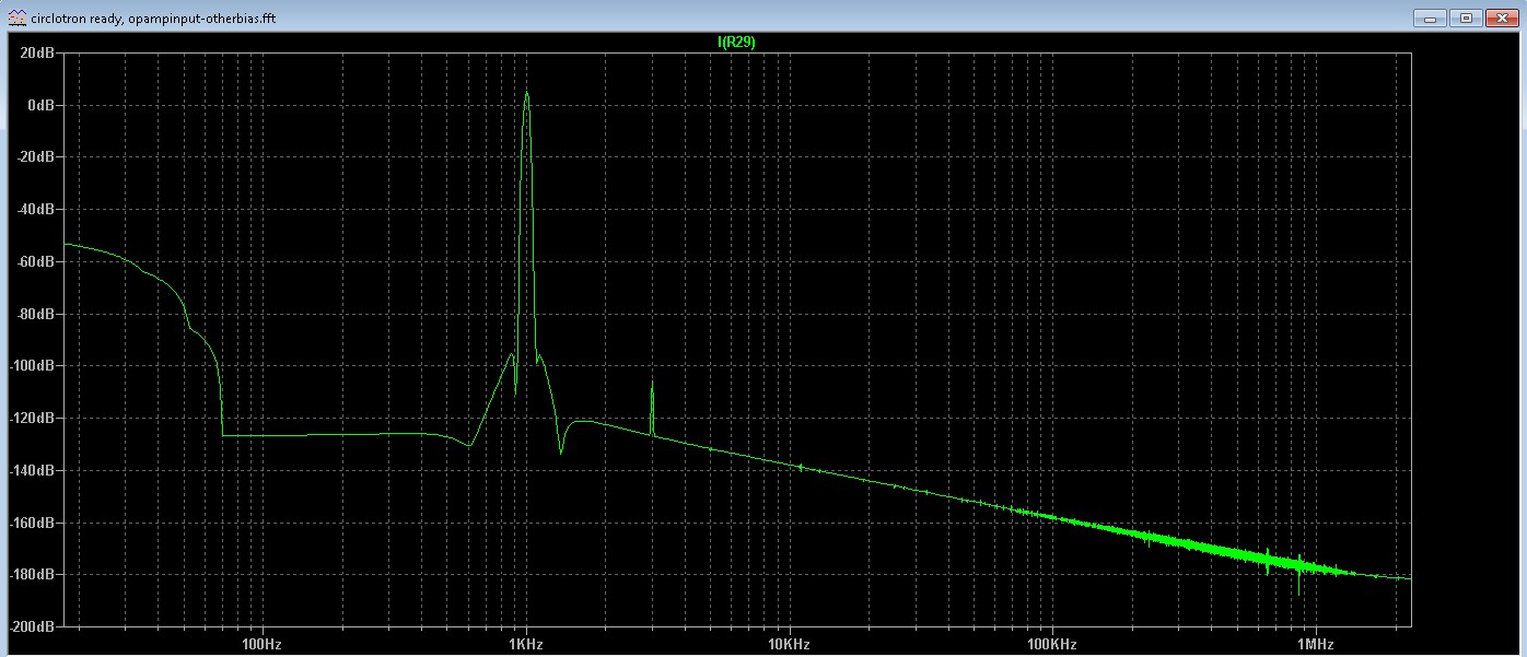

I have still the horn, but do want to make it smaller, with a K-tube then it is 2 way and as such recalculate, however first I go start again the circlotron, it get,s equiped with a kind of adaptive autobias system, I have some help with it. see how low distortion is.

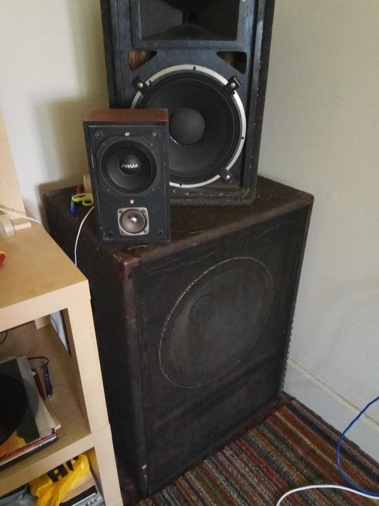

Okay i got a pair of the 8 ohm version.. I have to say, these are very special drivers. They do what no other small full range driver does, they sound much better in a FAST system than a 3fe22, hivi B3s and i would say on par with a TG9FD overall - but these can do all of that much louder and more dynamically
I put them in a pair of sealed and stuffed boxes, actively crossed over at 300hz to a pair of peavey BW18's in 220L cabinets (no dsp)
The sensitivity of the drivers are about the same
I just can't stop listening to this system. I have played with lots of different speaker prototype designs and these are really a step above the rest
If I am being really picky, i can very slightly hear the tweeter breakup at 7-8khz, but i'll work on it and see what I can come up with. Maybe some blu tack on the cone, or a passive filter ala the Zaph B3S design. I would be perfectly happy with it as is, but perfection must be strived for

Hi Oohms,
Thanks for the feedback on your experience with these! I really like them to and maybe more people would try them given your positive experience. You show it mounted in same cabinet as a paper cone tweeter - is that in a separate chamber or maybe sealed back? The big PRV lettering may also be a detraction for some but nothing a black Sharpie can't help to hide somewhat.
I currently have mine installed in a foam core Hypercube similar to the lower box shown here:
HyperFAST - a Hypercube Based 2-Way
I found a set of disposable speakers amongst my collection that i slightly enlarged the woofer hole of and used as sealed cabinets, so that sealed back tweeter is only there to fill the hole :D
My first idea was to put them in large glass bowls and put them on top of those cabinets - the hypercube idea would be a great option instead
The end goal is to make a large set of FAST cabinets, and I feel that a large pro audio woofer is the best match sound signature wise for these. 220L ported cabinets seem like the best option to get to 30hz but something that large becomes furniture

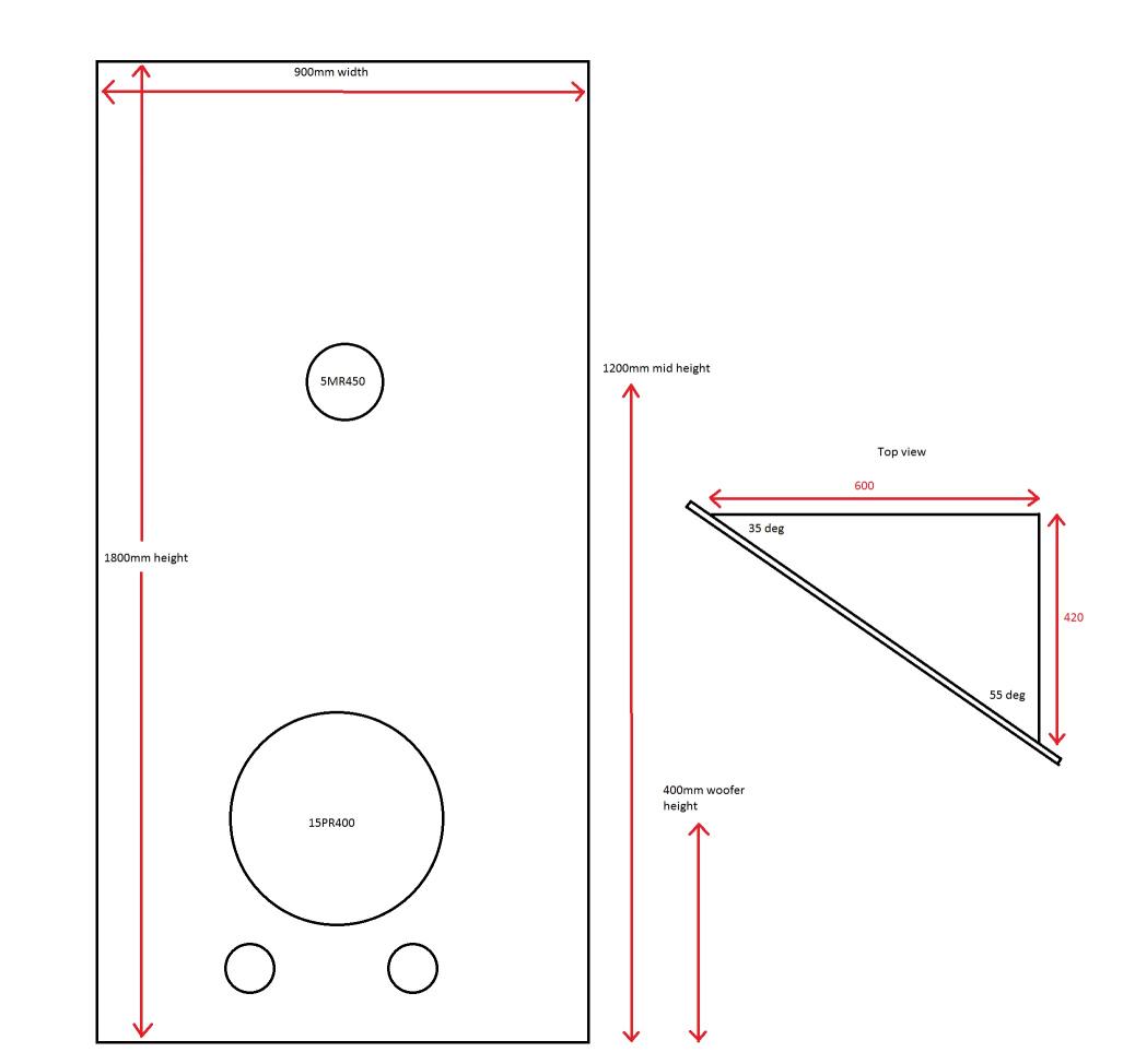

If i cut those boxes diagonally and stack them on top of each other (figuratively) I would end up with 900mm (35") wide baffles at the right angle to get good coverage for the little fullrange driver

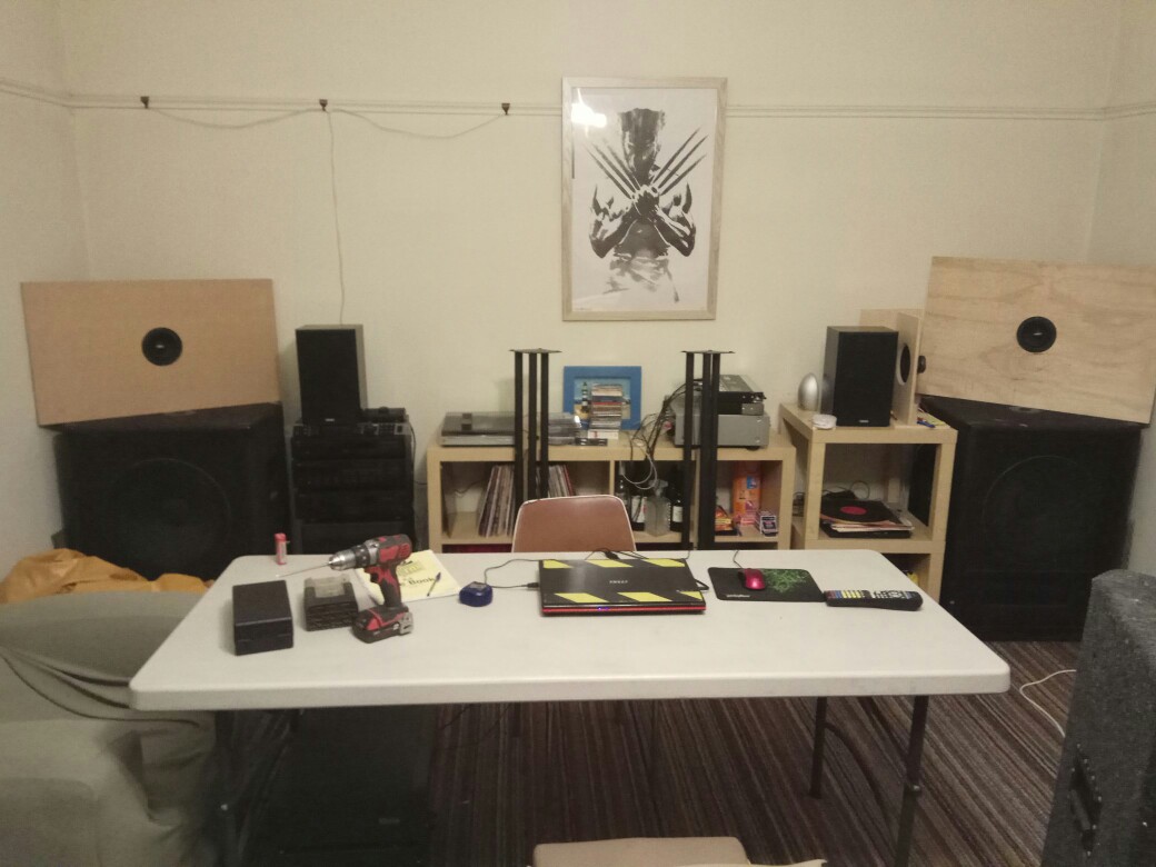

After experimenting with 900mm wide baffles (35"), the sound has much improved. I think the width of it captures the entire spectrum of the 5MR450 resulting in a very coherent and balanced sound. It also fills the room very evenly
A pair of 15PR400's has been purchased and I plan on developing a passive crossover around 300hz - the biggest challenge of the build is the 200+ litre cabinet the bass driver needs
Making triangular cabinets solves a lot of problems
- Takes up a lot less space when placed in a corner
- Baffle edges continue to walls with minimal disruption - much better room integration
- Relatively easy to build and make look acceptable as furniture
- Can be covered by grille cloth if they need to blend into the room
My biggest concern is the spacing between the 2 drivers - I want to minimise floor bounce but at the same time i'm worried that they are too far apart

Here are some recordings of the temporary baffle setup pictured above (using a zoom H1)
