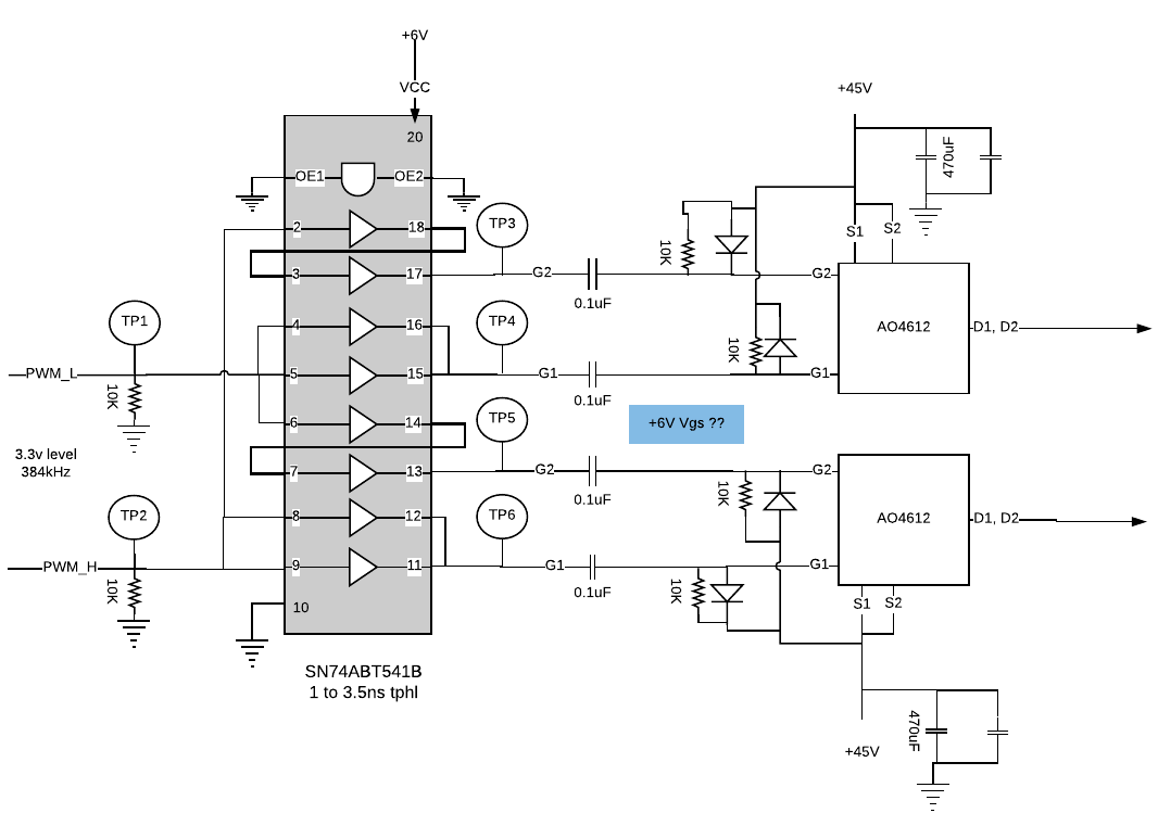

I've been toying with open loop amps this week. Sometimes you just have to have a go and see what happens. The fundamental idea is from a chinese amp but with faster components.
PWM into SN74ABT541B - ultrafast non inverting buffer.
http://www.ti.com/lit/ds/symlink/sn74abt541b.pdf
AO4612 - 60V complementary reasonably fast trench mosfets with
http://www.aosmd.com/pdfs/datasheet/AO4612.pdf
Wired for a single supply. It could be terrible. We'll see.

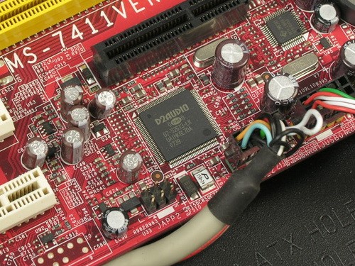

My PWM dev environment is the old MSI Diva Live with Intersil DAE-3 dsp on board. The black edge card socket above the IC has the PWM output from the dsp as well as i2s I/O. I have the MSI 5.1 amplifer and the 7.1 pre amp cards that connect into the D2. I might be changing op amps and modding the hell out of that.

Are sure you need noninverting buffer?
You're right. It should be an inverting part. I spotted the SN74LV540ADGVR. A small TVSOP with 6V tolerant I/O. The higher the Vgs the better the performance at the fet.
TP3 = TP2
TP4 = NOT TP1
TP5 = TP1
TP6 = NOT TP2
The parallel and cascade develops the correct positive and negative inputs into the fets. This is so we can can use a single rail supply. That's the theory anyway. Correct me if I am wrong! This is a bit of a diversion adventure.
The next step is determining what kind of gate waveform timing you need to control the FETs, what kind of timing you get from the PWM modulator, and how you can convert the existing to the desired one.
Basically all output FETs inverts the signal in the corrected topology, so a half bridge (p and n channel = Hi and Low side) needs gate waveforms with the same polarity, but you may need dead time to avoid cross-conduction. This may be included in PWM H and L, but I don't recommend to use this capability. I tell you why:
While you can set the correct gate polarity of one half-bridge and keep the dead-time, with the other half-bridge you need inverted operation, but this inversion (if done on PWM H and L signals) will turn dead-time to cross-conduction. So dead time in PWM H and L should be avoided if you want to use them controlling full bridge.
Dead time should be set at each gate independently. After you make this, you will have many different possibilities to determine control scheme. Including ClassBD modulation, if your modulator support this.
Gate dead timing can be done with a D, R, C network, this can be either after the gate driver or before gate driver, each has its own benefit.
Always try to draw waveforms before building! This is easier than debugging a non-operational, and not understood circuit.

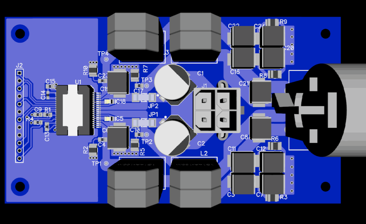

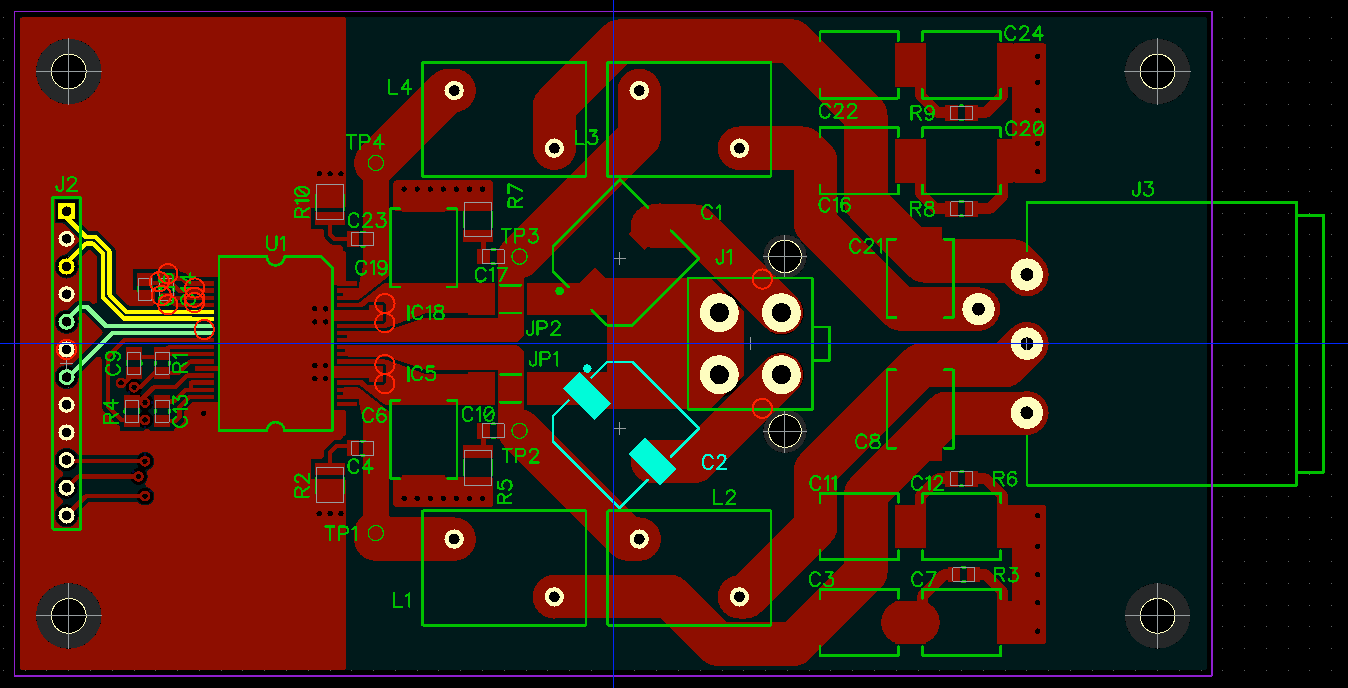

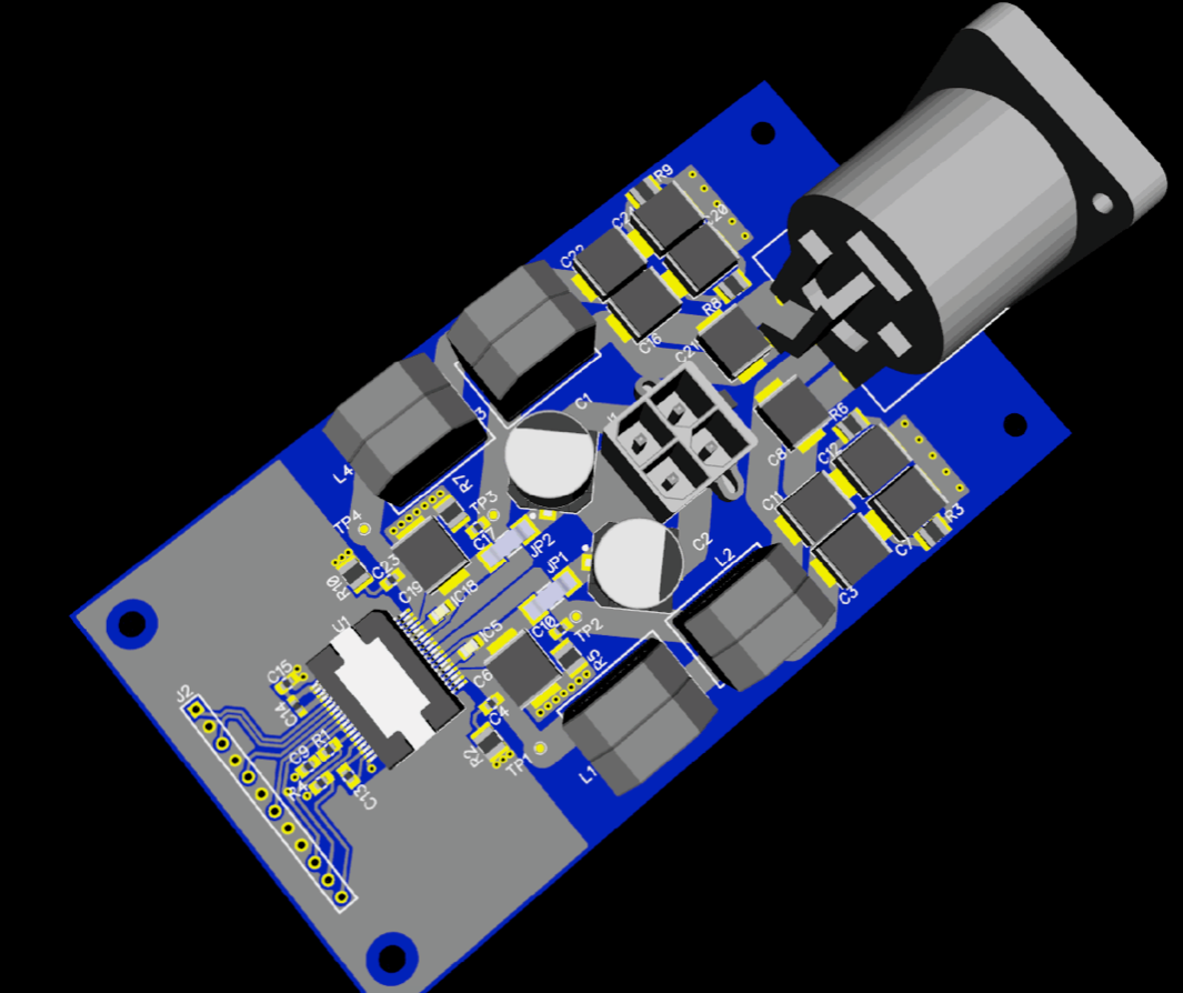

I've been layout out a few options for the stereo BTL STA516BE.
The output nets/loops are roughly the same length to within around 2mm. Ground plain is uninterrupted. I'm not sure about the inductors and leaving long traces after them before the filters.
Board size 110mm x 60mm.
Input - PWM each pin separated by GND.
Output - 4 pole Neutrik SpeakOn.
Not quite finished but any WIP comments are welcomed.
Sgpu,
Not bad! Long traces of the inductor is not a big problem. Everything is OK, although there are some things that can be optimized further. Input GND and power GND loops could have been separated (shielded) better from each other, most easily by a series of GND " stiching" vias underneath the IC. 10-20 pcs.
And take care of heat sink fastening screws! Close to IC. The potential of heatsink should be power GND, ("dirty GND") hence don't make direct contact to case!
I wouldnt follow the recommended filter schematic. The benefit of series config of 100 nF is that this way only one of them have to be foil type. Since you use foil capacitors in all position you don't need this feature and it would be more effective if you tied C24 (etc...) directly to output node. But resistors must be much bigger, they will dissipate really high power when you drive it near 20 kHz (or with square wave).
