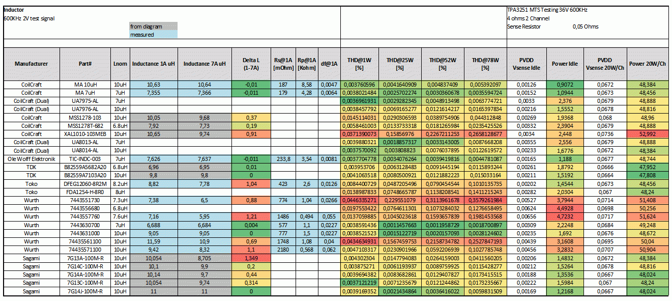

Your speakers impedance isn't 6R over the full bw. If it goes under 6R, more current will flow, resulting in some "core flux modulation distortion".
Some data from the TPA3251 Evaluation regarding inductors used in the output filter.
TDK ERU20 is also on the list, which is one size bigger than your posted ERU16 inductors.

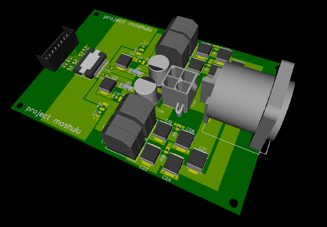

Work in progress. This is a 2ch PWM input board only at this time to be used with ongoing development of a 12 channel DSP board companion board.
More details and updates to follow.
Firstly, I'll be changing the inductors from ICE 14DA to Wurth 744363 as suggested by doctormord earlier. Then working on compacting the board and component layout.
