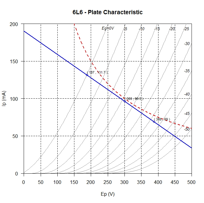

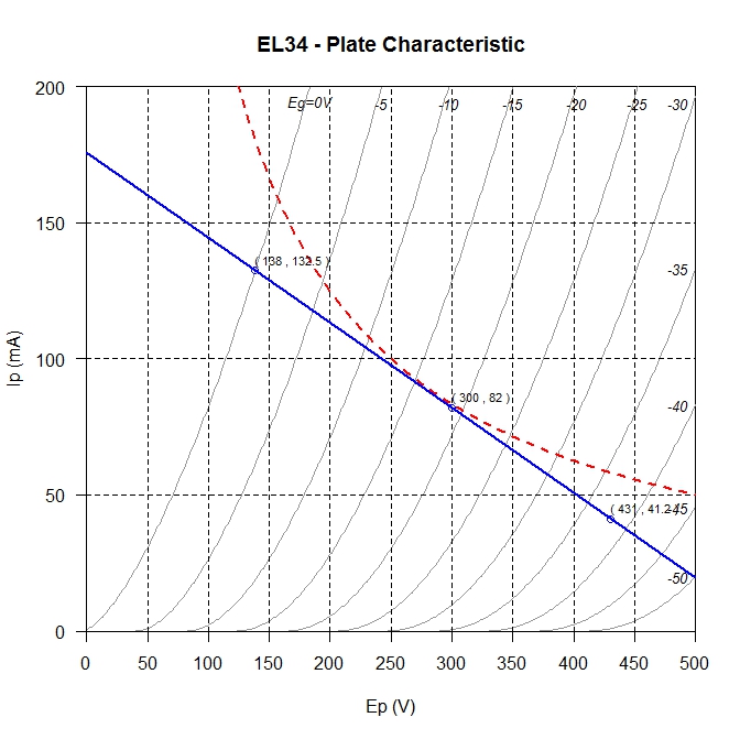

I actually have 4 157L chokes. That would give me 28 Henry, 75mA and 858 Ohms if I used two per side. If I use one per side, it's 14 Henry and 429 Ohms with the same 75mA. Is one 157L workable? From my calculations it appears to create a lower -3DB point that is too high, but I'm not sure if I've calculated correctly.
I don't think 40mA is enough to work with. 75mA should be more than enough for EL34 and any of the 6L6 variants. I have a number of power transformers, so I can provide whatever B+ is appropriate.
Ex-Moderator
Joined 2011
Not unless you are willing to sacrifice some output power...
