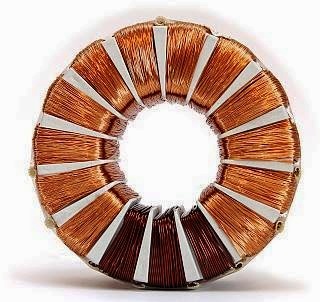

Here's an internal of Toroidy SE Txformer.
  • Toroidy- ENG_EL84_SE 5K 30Wts.pdf

I am newbie on the tube amp area and I decided to build my first tube amplifier (SE Class A). I purchased from Toroidy (Poland)
two pieces of tube single ended toroidal output transformers.
For a long period and especially during Christmas holidays, I worked hard to make it work in the usual topology (Anode , Ultra Tap, V+) as it was also recommend on the label on the OT, but it was not possible.
After a lot of trials and searching on the internet, I found out that the only topology that could work is by using a parafeed circuit , but this configuration is poor for the sound and at the end more expensive.
Before going back to using normal OT, has anyone find any solution on how to actually use them? Has anyone use toroidal OT from this company?

I contacted the manufacturer, and the OPT I purchased is not gapped. Using it would be the same as using an un-gapped EI push pull OPT in a single ended application. That is to say, not ideal.
Parafeed is their only application. Parafeed can work really well but it depends on whether you have the cash for some plate chokes, or enough headroom on the B+ to run CCS as plate loads. You need at least the peak to peak signal voltage across the CCS to make it work.
