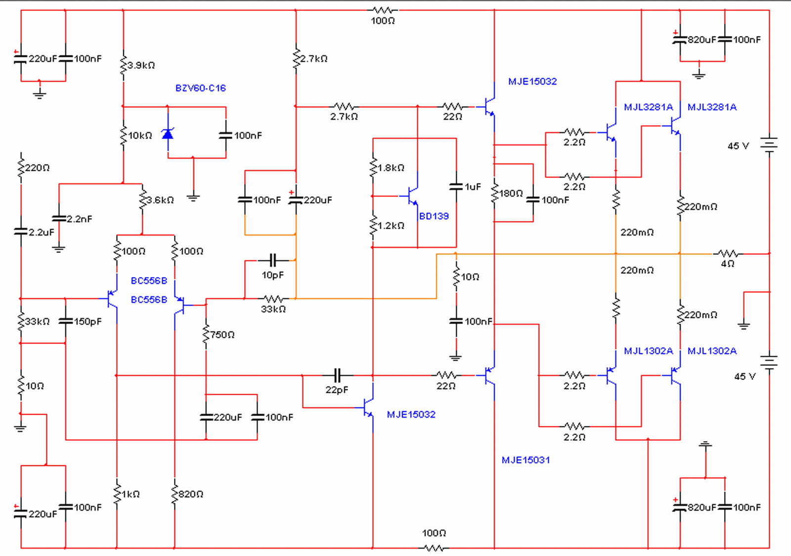

You can set the quescient current werever you like depending on were you want the turn-over point from class A to class B operation and how much power you want to dissipate in idle mode. In my opinion four TIP142/147 is a little overkill, but then I have seen amplifiers with no less than 24 transistors per rail.
There is one simple check that would be necessary to ensure that the Vbe multiplier is doing its job correctly. Set the quescient where you want it and run the amp for half an hour or so and measure the emitter current. Then use a heat gun and heat up the heat sink and you must see a drop in quescient current not an increase.
Anyone else for a practical solution?

The BC639 shown would not be able to drive 4 pairs of transistors well. You would need a larger device as VAS, and to increase the Class A current through the VAS. Personally I think that a current source would be better for this than the bootstrap circuit.
AS i said before, this is no longer a quick mod, this is a whole amplifier redesign. Pick an amplifier circuit already designed for this task, rather than trying to hack up this one.
the problem with the tip 142-147 will remain that in the slightest signal spike or overdrive one will drive more than the other and eventually explode ....
i will agree with jay cee regarding the vas stage
my recomendation is to use just one pair of MJ11015-16 as tested in the greek version of this the circuit was able to work easily up to 56+56 volts ....
as i said before the greek version features 2 ccs more
but with 45+45 volts you may get away with it

Here you have one...this is the one i use... hardly tested
super reliable......but.... into our forum we have several amplifiers..all them are good..no one is perfect, no one can be considered the best... some are special alike Krill..others are normal and common alike mine ones..others are overcomplicated and others are fashion... some are time bombs...problems creators.
This is one tested....Nico Ras have many good ones too.
You should read a little...and back to 2002 in our forum...you may have many options.
You can use the transistors you said...power transistor are power transistors and nothing more than power transistors..they have maximum voltage, maximum current, maximum power dissipation, gain and prefered voltage to work..also they have cut frequencies (-3db) and there's no one that cannot work in audio.
Drivers are smaller power transistors, and nothing more than that..to220 and smaller case, smaller dissipation..they have maximum voltage, maximum current, gain, prefered voltage to work (1/3 to 1/4 the maximum colector to emitter voltage having base connected)... the rest is myth and foolishes.
Small transistor are small transistors, they have huge gain (all them), they can be PNP or NPN as all wide world transistors, they can be fashion, smaller, beautifull, black or ligth gray or even dark gray..can be metalic, rounded or squared..they have maximum voltage, they have huge gain, nice frequency response, maximum current, maximum power dissipation....well..alike all others.
Observe those things...(observe means obbey), read datasheet and use the ones you have.... there are thousands that can work into the input...thousands that can work alike VAS, thousands that can work alike drivers and thousands that can work alike output power... transistors do not get married..they do not constitute family..they have no race and prejudices..they can mix without problems...mixing brands, colours and how they look.
You can use my schematic (tested) and other thousands you can find into the internet and hundreds (much more reliable ones) you can have in this forum.
I do not mind you use mine one..it is a suggestion one..safe thing to be used..just that...better to use Nico Ras amplifiers, as you seem not to be good with language and this will turn confused our communication...so...maybe Nico understand you better than me..i am old and stupid..... and a little bit tired also.
This one shown, is the DHR Turbo (there's an entire thread about)..it is the son of the Dx Amplifier (there's an enormous thread about)...and you have a home page about it and Chinese have home pages about it too.

- Dx amplifiers, if well made, if well constructed, if well adjusted result very reliable, they may blow your ears, your supply, or your speakers..but the amplifier will not blow..will rest for your whole life and you will give it to your childrens and they may give it to their own childrens....and so on.
Hundreds have assembled..no one have complained... they are spread into the whole world..playing from Alaska to the Argentine Patagônia.
By the way.... this unit puts out 225 watts RMS into 4 ohms loads (speakers).. and can work using 6 ohms and also can work using 8 ohms.... to use 2 ohms you have to include more output transistors.
