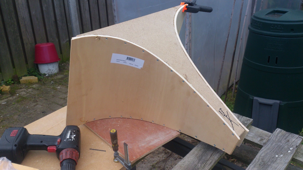

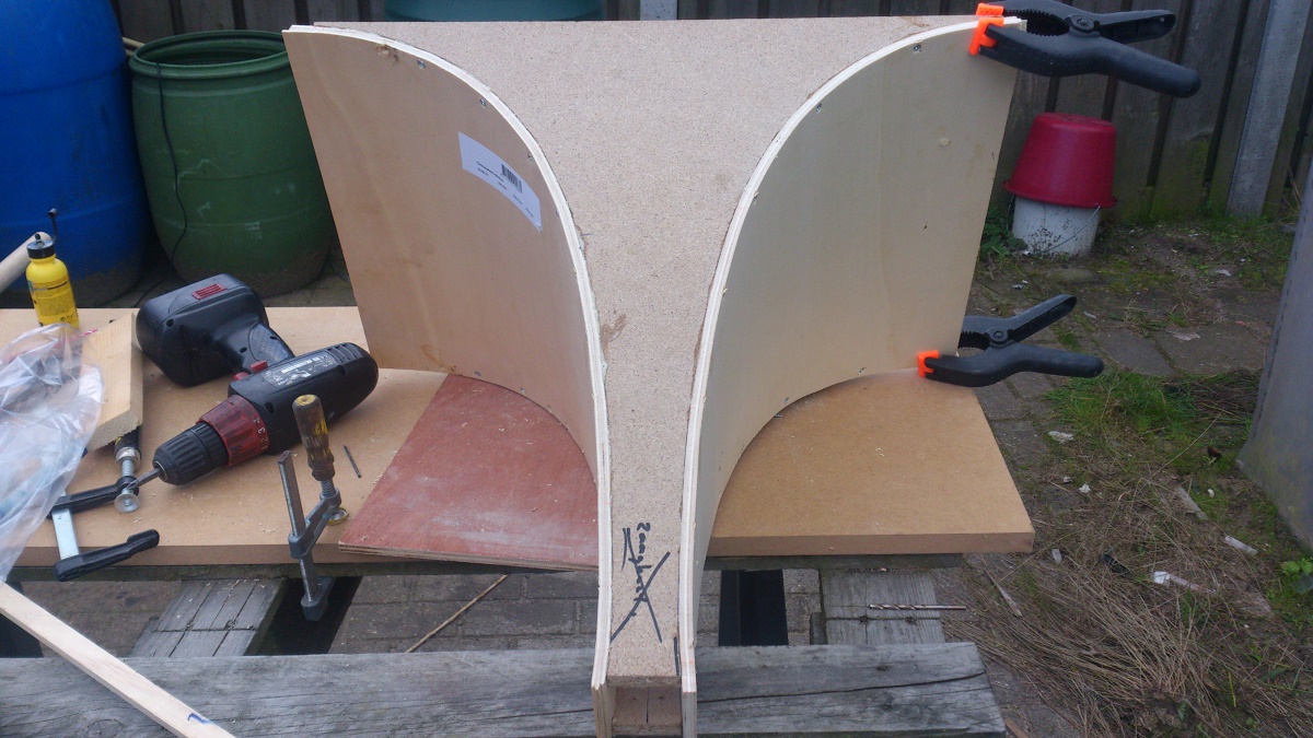

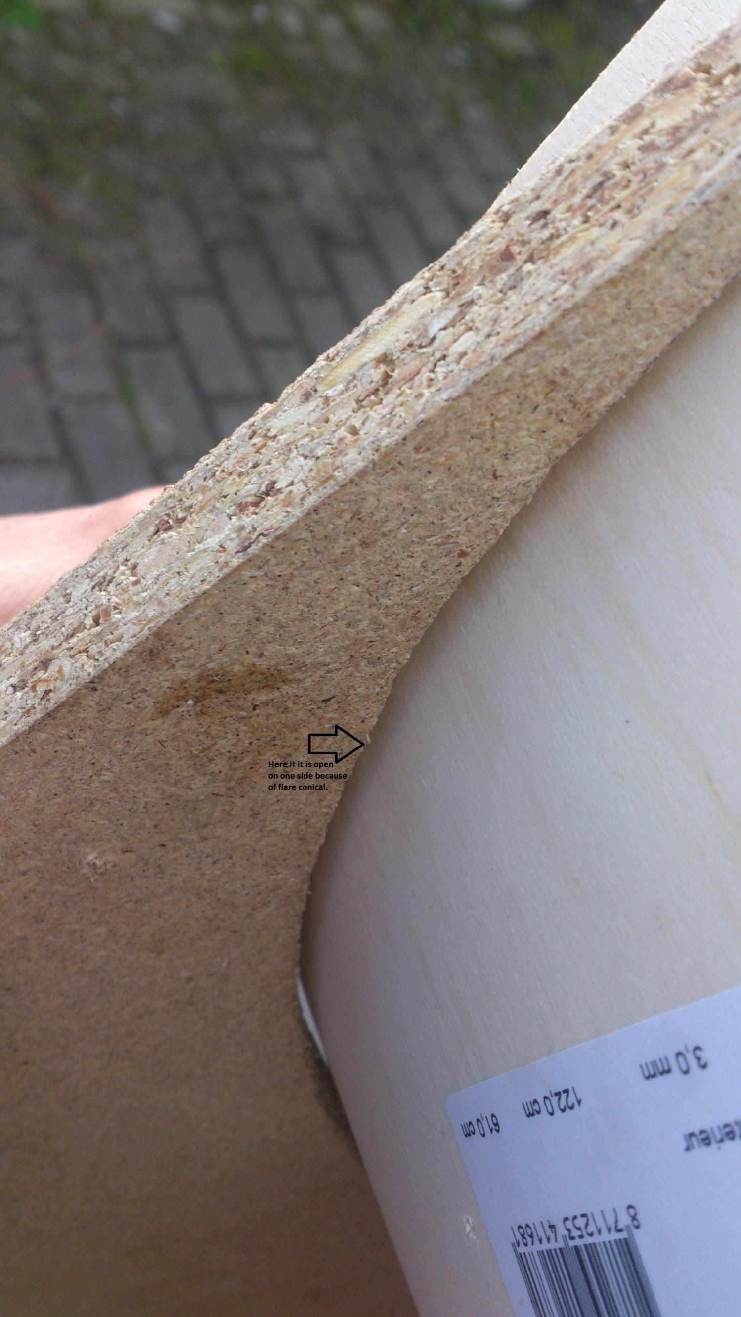

Good to hear from you - it's been a long time. It looks very nice but that is not necessary to cut the top and bottom panels to fit the curve. They can extend beyond the tractrix profile and provide additional stiffening ribs. Why are you cutting them to match the curve?
It is not cutting but to gleu the horn flare on the sidewalls I need to flatten it because it is not, the I get a gap between the curve and the sidewall and I can not glue that.
I do not change it, the inside of the conical part is inside untouched, but outside is higher because of the conical form. The corner of the conical part of the horn changes, it starts oke, but then I get a bigger inside slit towards the mouth and so need to flatten that with that slef made file to get it equal.
I try to explane that in english but I am not so good at that, so pictures explane the problem I hope.
Why i did remove the panels outside the horn is to make it easy to get it done, I have used thinner panels, half of the used thickness, and when ready I gleu one on top and bottom and have that good thickness again.
regards
regards
Ok, I see... you are gluing the curved wall to the edge of the flat panel. I glue the edge of the curve wall to the flat of the flat panel, so all the panel needs to be is, well, flat. :) You need something to hold the curved shape in place while the glue dries. I suppose the edge of your flat wall is serving that purpose. In my case, I use hot melt glue which hardens in 45 seconds so the shape is held by my hands.
Hi
You need to now, this is wood, it needs a good surface to glue on, it will be very stiff when ready.. I do not need to keep the curve be hold because it is clammed and gleu it and now it stay of itselfs in form.

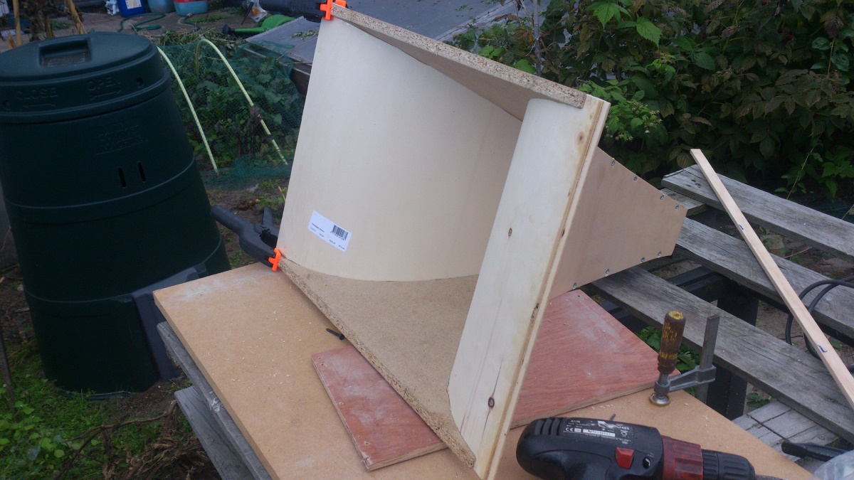

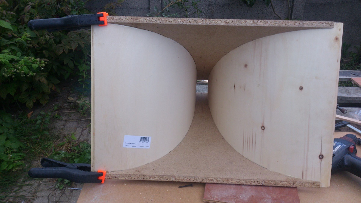

Well one is ready so far, so I can go test it with the small visaton frs8m.
It do dry now, and I think it is quite stiff now, I do glue a plate on top and bottom, I did separate the total thickness of the top and bottom in two, so I get a more easy wat to build it.

That is looking really good. Nice work with the curved panel held on with screws.
And with construction woodglue who do rise also to fill gaps.

Thanks a lot, yes the broomstick was needed because of the conical part who change up the tractrix flare and need sanded equal to close the edges of tractrix part against the top and bottom, if you understand my english :D. For the bass section I go need try simulate again, I go use the philloips baswoofers, one on both sides and hope to have enough sound, it is for high end in home, not outside PA. But I think seen the holes in the horn corners that I do need two of them on one side, I do not now if one hole will work as bass injection.

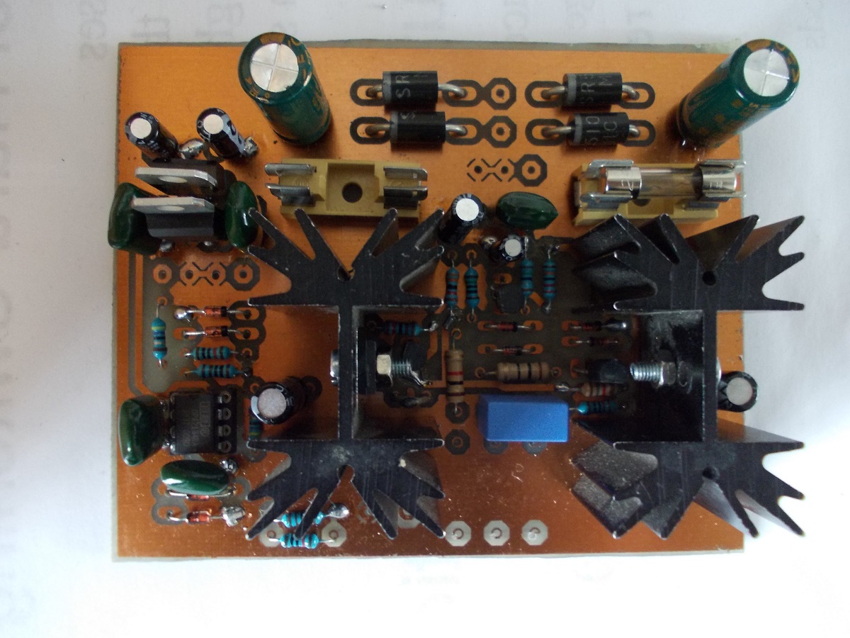

It are the AD8066 W4, has 92-94 dB watt I go measure them with this jigg who I have special build for speaker measuring, it has a own 6 watt class b amp on board so I spare computer outputs.
regards

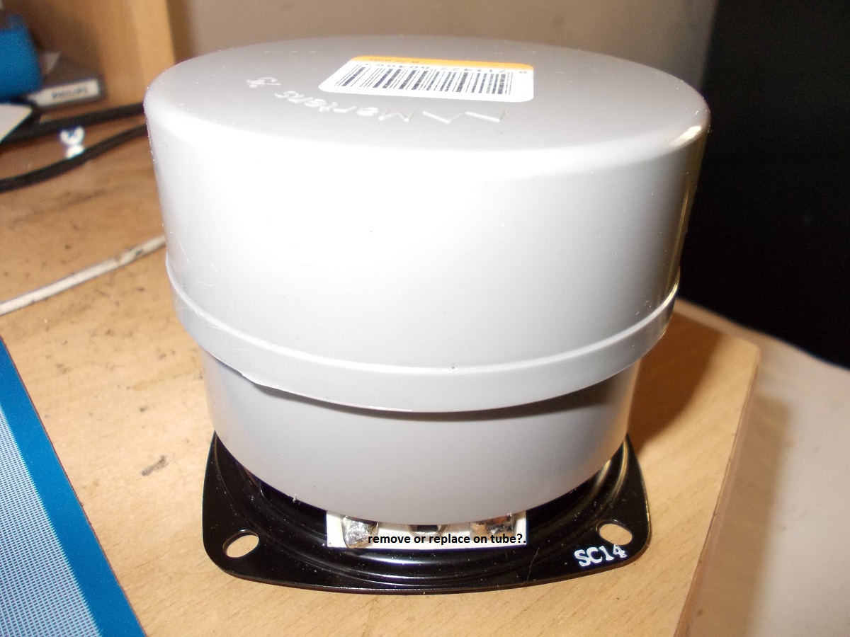

I have made a tube closed chamber behind the visaton, used pvc for that, I need to mede the connections on the outside to get it airtight.
This chamber will be very small, I presume how smaller it is the better the respons on high frequenties. I go sim that in akabak.
regards
