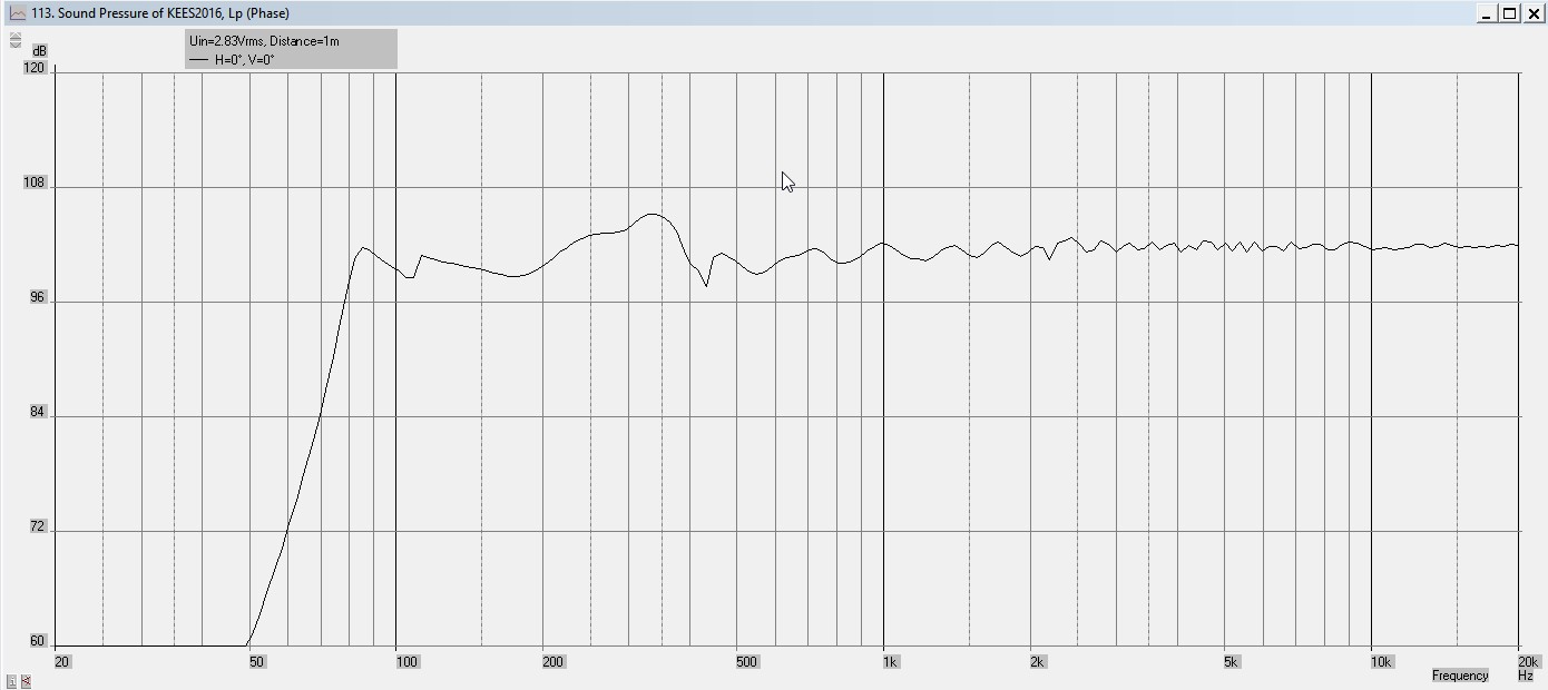

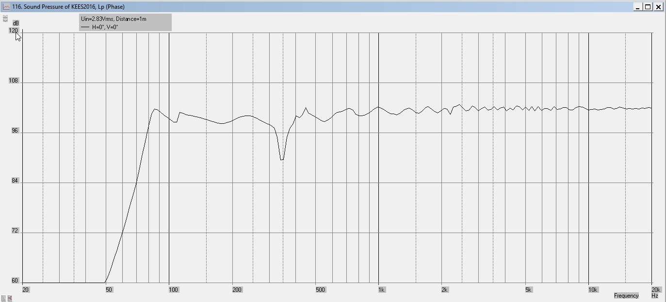

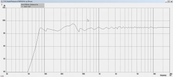

Did some sims with different delays for mid and the high, subwoofer is switched off.
mucho changes.
regards
kees

Those look nice, you gotta love that sensitivity for 2,83v. Be careful when testing - you can hurt your ears as it is loud but so clean and low distortion you won't it.
The all pass delay filter is how I effect the delays, is that how you do it?
Yes I did use the delays to make it like it is, but without it is also really suprising good. using a correction in the woofer section will get it as good as with delay and it
is a lot easy to do with notch circuits..

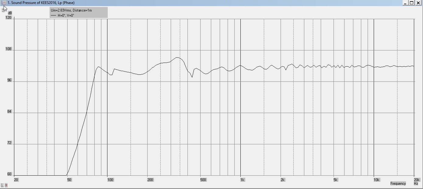

By the way here some good calc stuff.

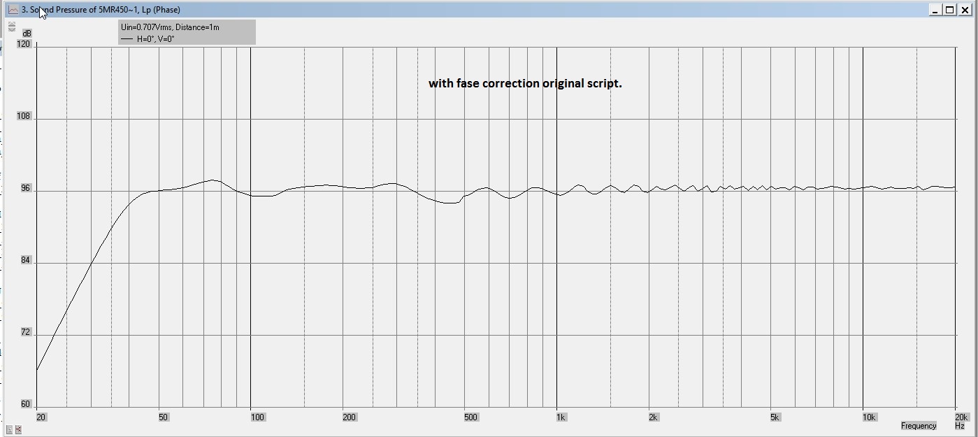

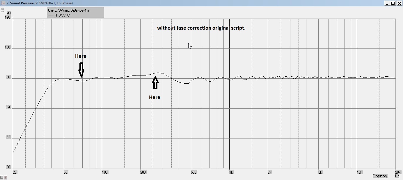

I have also try your original script with and without fase correction, very much differents I do not see, but small ones can alsready impact the sound I think fase liniair is very important for smood sound special with high efficienty speakers.
regards

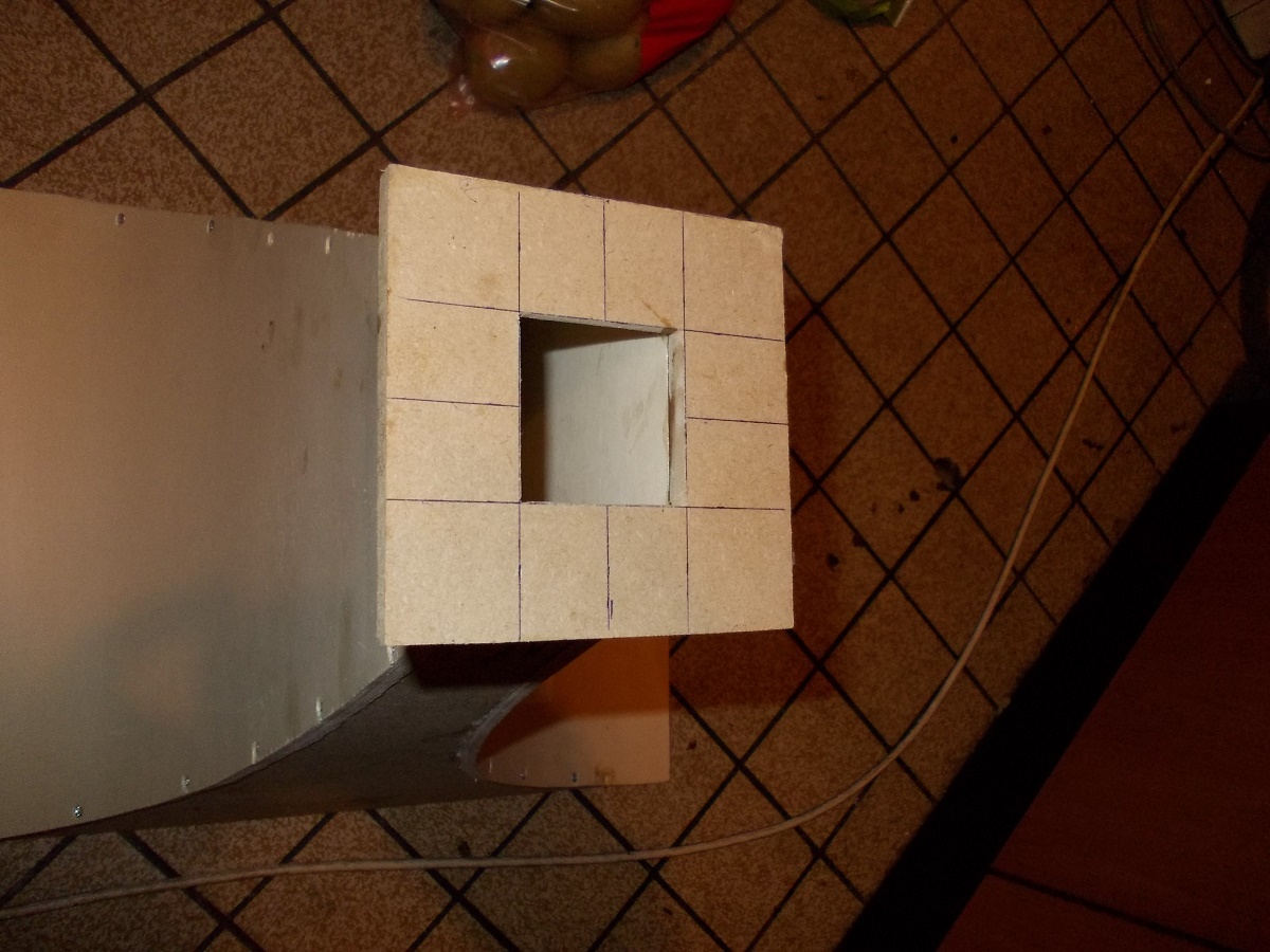

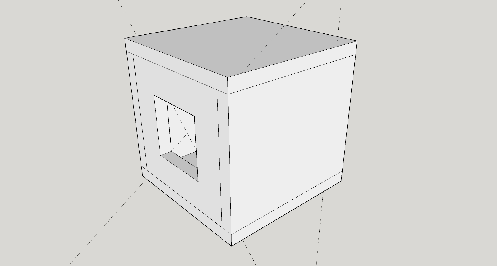

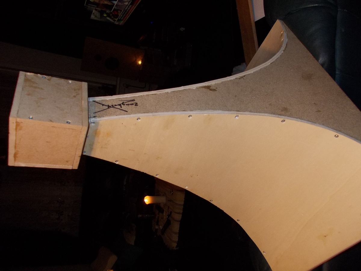

This is the way I go make that box, I need to cut 0,9 cm from the throat because otherwise the throat get smaller I put thare extra 0,9 cm for baffle for speaker not much but I want to keep the sim outcome intact.
regards
I did discover that the length of the horn is 5mm longer, I do not now yet if it is react different on that, I think not because it is so little, but it is th throat so maybe I am wrong.

I have made the little box, it is 0.8 liters big, I need to stuff it heavenly I did read, so these weekend I go measure the stuff without the bass unit, that is later on.
I I live then because in Syria it get dangerous.
regards
kees

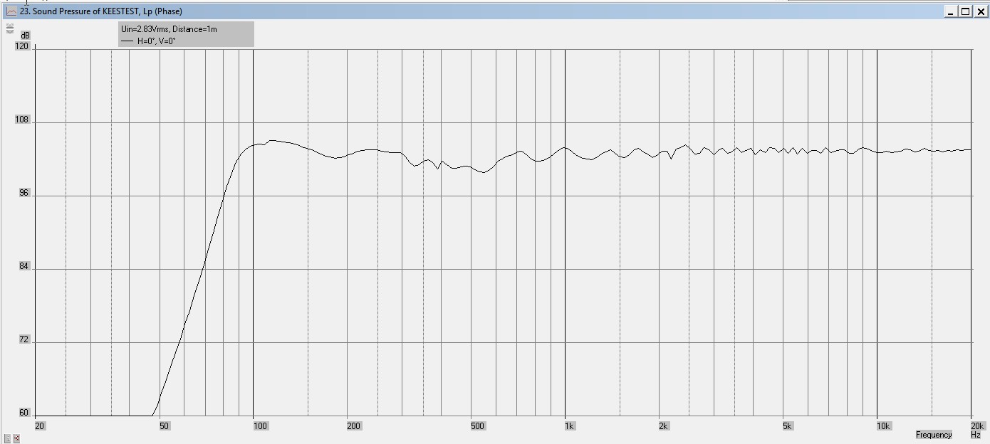

Tested,, I presume you use two woofers like me? in your case 12 inchers, I do use 8 inchers, I have therefore need two changes, Now find the bassreflex inputs and I am ready to test the stuff in akabak, Now I think I get where I want to be.
Moving the ports to 72 did change a lot, as a test afcourse, then I did manipulate the delay and get this graph. efficienty did rise also some dB.
thanks.
kees

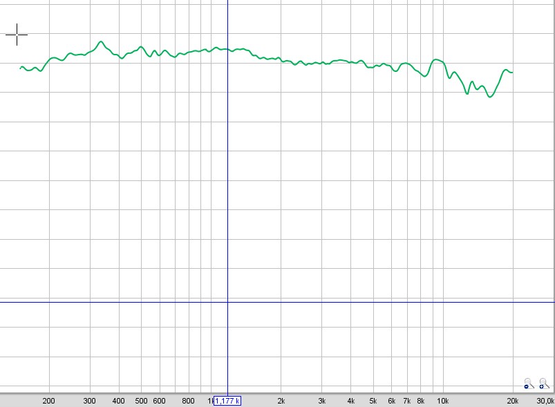

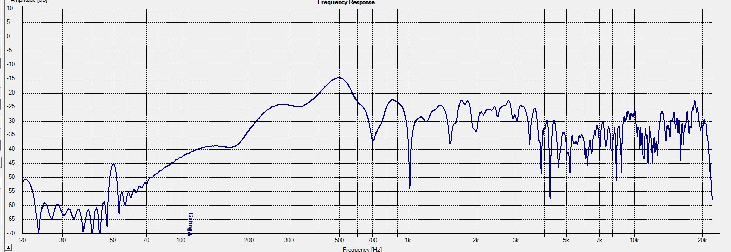

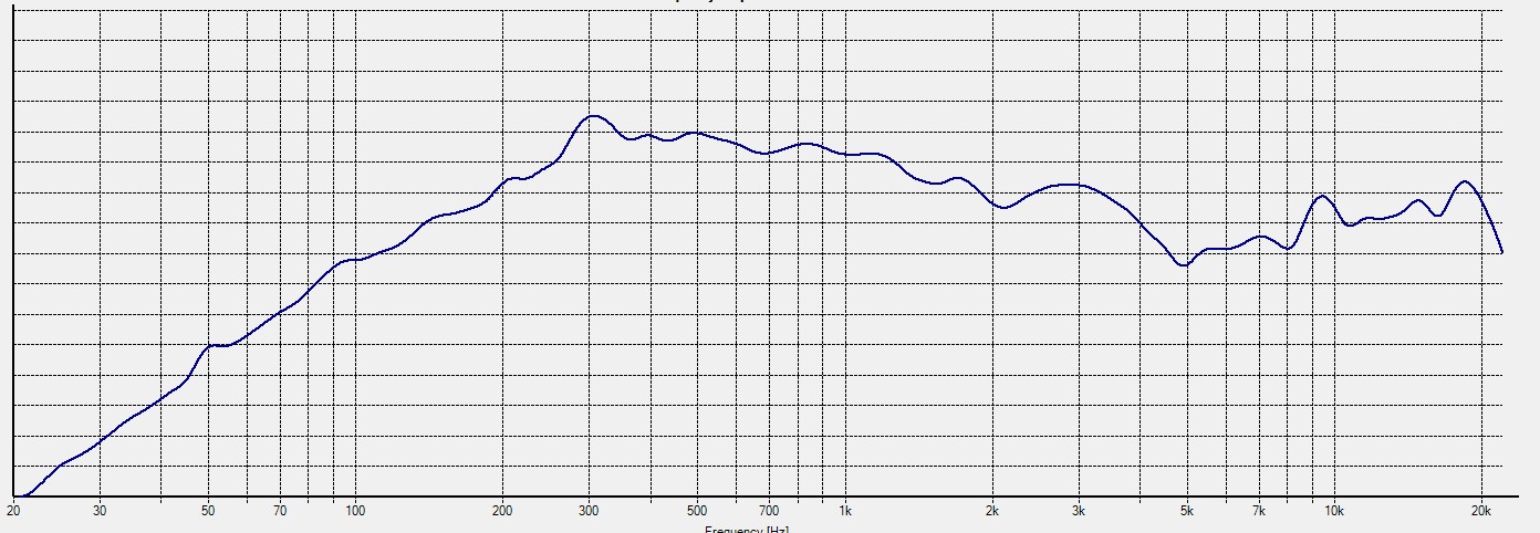

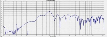

Did some measurements in house, so room is involved, I need go get long cable for outside.
This is what comes out. I did use REM and holmimpulse for the tests, but need a mic amp, I have build one in past, I go put it tegether because I did measure with the mic input of the pc what is not really oke I think.
The mic amp do better I hope with the burr brown opamps.
Picture two looks very nice, close to horn, think so 25 cm.
regards

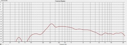

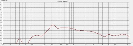

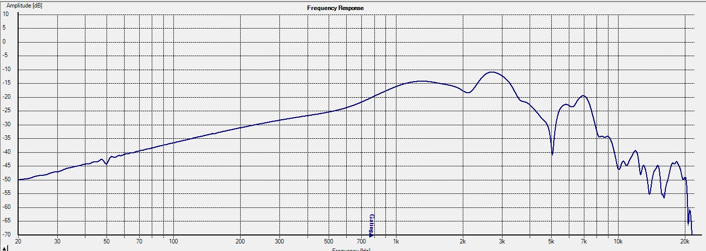

And here the speaker from visaton and the phillips in free air first is phillips and second visaton..
looks like wild impedances need correction. post 557 I did let see different tests with two programs and plots from different places in room and distance.

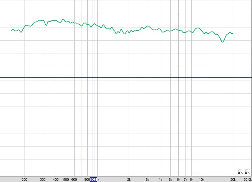

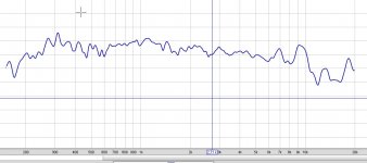

did measurement 1 meter distance with and without chamber, not much differents but is looks like this speaker do not well or horn is wrong.
It go down after 5 Khz after that it looks very good for me, but 15 dB down can be not easy corrected, so I go first make the mic amp ready and maybe the visaton cone do break up very fast like 5 Khz.
I can hear also mids are louder then hhe high give some hollowlike sound.
How do you did the throat? just a square or did you that different, I thought you have just a square.
regards kees

I used a square throat. It is very important that the throat is smooth with no rough edges. Make sure you have a space to keep the driver cone or surround from touching the throat on outward extension. There is a normal dip usually around 4.5k. It is natural for a driver to have a power response falloff about 10 to 12 dB from 5k to 20k. I forget what mine was but that is where DSP EQ comes in handy. A simple high shelf negates that and as it is a rising in frequency response you don't have to worry about over excursion. Look at my plots before and after EQ to get an idea. It is important to get a driver with a powerful motor. The Faital 3FE22 was better than the TC9FD for this reason. It has enough power to let you EQ boost the HF.
I can't tell what your vertical scale is. In REW there is a snapshot feature in upper left Corner of plot box. Click that and generate PNG file of plot with axis labels. Otherwise I can't tell what SPL levels you have and what frequency.
