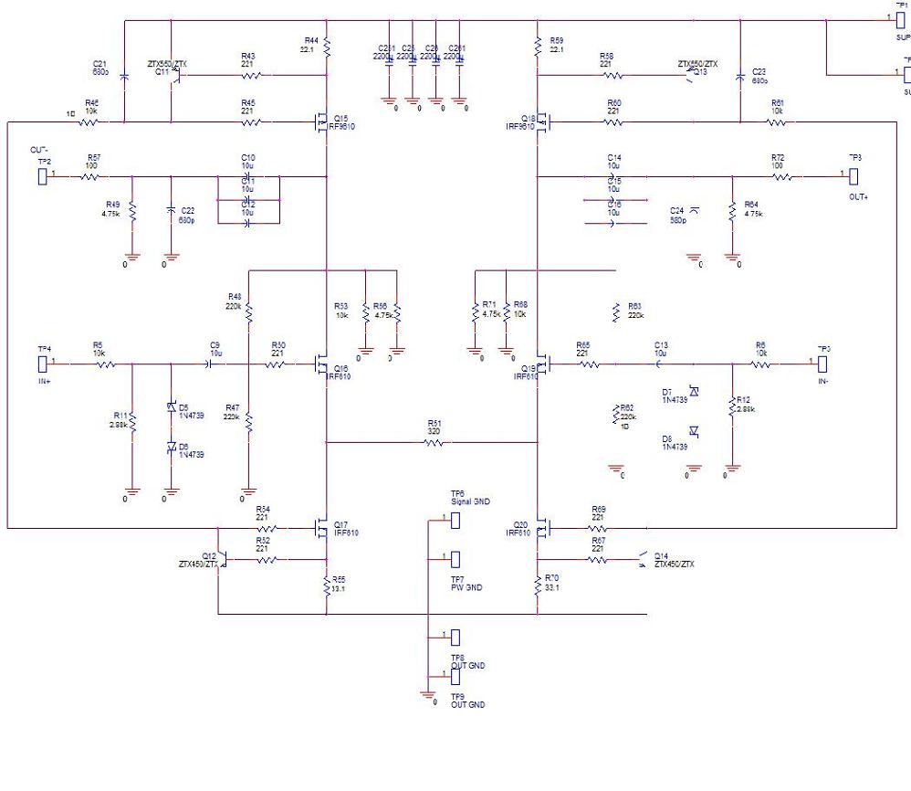

post schematic here ( that's your homework, not anyone else's - to chase it) and then we can discuss it - where you (maybe) miss something and what you can improve.
point is - that preamp is still one of most cherrished in DIY world, not without reasons
sorry you are right....i haven't posted the schematic.
This is the NP SM schematic.
The gain resistor R51 is set up to 240 (is it too low? might it cause some hiss?)
Are the R48-R63 the feedback resistors that grey was talking about?

Trying to evaluate anything with tantalum caps in it is bound to lead to frustration and/or inaccurate conclusions. I'm not exactly sold on the idea of using electrolytics--regardless of manufacturer--in signal coupling applications under any but the most dire of circumstances.
Stefanoo,
This is probably one of those things that you'll have to solve on your end. It's quite possible that your circuit is oscillating. Your expectation that oscillation will grow and grow in the sense of feedback that you might hear through the PA system at a concert is not entirely accurate. The first thing to realize is that if the circuit is oscillating at, say, 1MHz, it could actually be oscillating at full power and you couldn't hear it no matter how hard you listened. Second, oscillation isn't necessarily an all-or-nothing proposition. If a circuit is oscillating, it's due to a complex relation between impedances and the period of the oscillation (hence the rise time of the signal) may be so short/fast that the signal doesn't have time to reach full output before it's time to turn around and head south again.

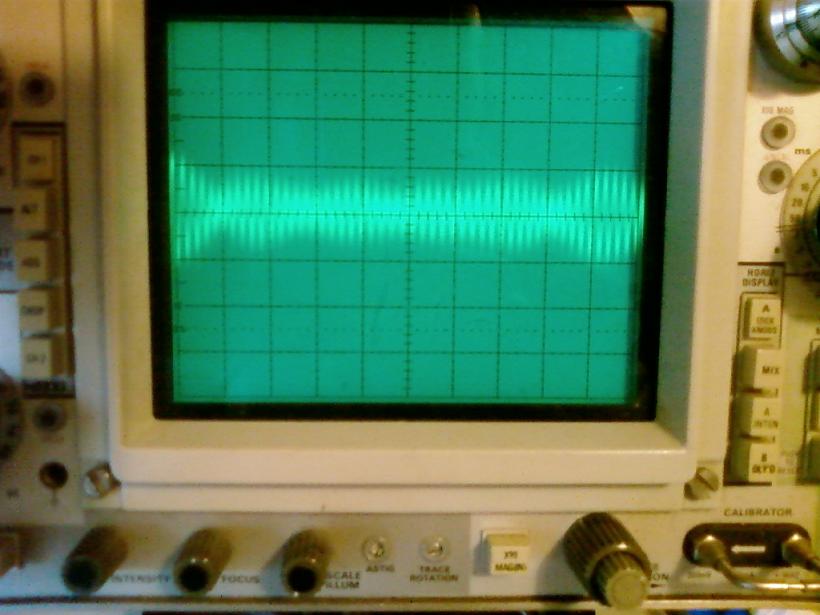

If your oscilloscope is in need of repair, you might want to consider getting it fixed, or perhaps buy a new one. I use a Tektronix 7300 scope which has something like a 100MHz bandwidth if you're using the right plug-ins. You'd be surprised how high the frequency of an oscillation can be. No, you don't necessarily have to buy a 7000 series to look at things (although Ebay and patience can work wonders), but a decent scope is one of the first things I'd buy if I were starting from scratch. Hooking a piece of equipment that may be oscillating to your speakers could easily cost you a new set of tweeters--it most certainly isn't the best way to check for problems.
If your circuit is actually oscillating, even at frequencies far above human hearing, it can have an effect on the sound quality.

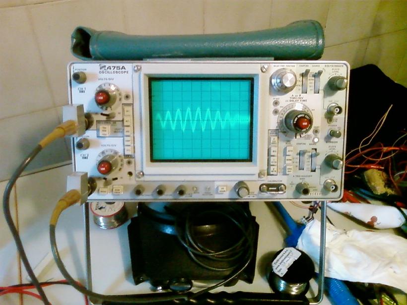

hi grey,
i have a tek 475A which is a 300MHz scope....unfortuantely has a power supply related problem and i checked and there should be a couple of caps that are not working.
I think it would be enough to replace them to fix it.
The problem is that in order to gain access to the main board with the power supply, i have to take all the boards of the scope aparts..and the scope is assembled with tooonnss of wires tackled inside, strips....yet, i have a detailed service manual and so one of this day i'm going to do it....but i'm a little scared not to be able to do it.
Yes it would be nice to get a new perfectly functional one instead of going through this hassle here.
With regard to the oscillation, i got a little scared.
The high frequency oscillation can cause the failure of output transistors and the speakers as you outlined.
Eventually if none of this happened and i had it connected to my amplifier and test speakers (not the B&W).....it might not be oscillating...or i was just fortuned.
Ether way i' m gonna check.

as i said i was in bed with the flue and tomorrow i'll start working and therefore i'll try to do the following things:
1- analyze if there are any oscillation at high frequency and post the results.
2- try to lower the gain resistors to see if the hiss could be caused by that
3- rise gate stopper (if i gate noise on the output touching only the side where the signal...in single ended...is sourced from...let's say the + side......do i have to change on both side the gate stop resistor as a test?)
one thing...sin ce my scope as i said is not working very well....as you guys sugegsted me....i was considering on getting another...simpler....let's say a 60-100mhz just to hold me up and let me fix my 475A.
I was thinking on getting soimething simple...and a little newer as a tektronix 2231A 60Mhz for let's say $100 or omething of the same family but 100mhz...i think the 2241 or something like that...
what do you guys think?
tomorrow i'll try to post the pics....
in the meantime thank you very much for the interest that you guys have on replying to my questions and doubt.
hello guys,
i finally took some picture of the output waves.
I am just thinking how i am gonna see a 5uV output signal.
Even if my scope would be nice and perfectly working, the highest input sensitivity would be 5mV/div.
Anyways i' m currently using a X10 probe.
The Volt/div knob is set up to the maximum sensitivity (5mV/div).
Without input signal (input shorted) i have the output shown on the picture.
Time/div is set up to its maximum frequency (0.01us/div).
I se two main frequency:
The highest frequency seems to be one division and therefore 100MHz... ...pretty high...uhm?
Could this freq damage an amp or a tweeter?
I also see a lower frequency that seems to be a 10MHz.
I don't see any other harmonic.
I don't know if i could safely hook this preamplifier to the rest of the chain without damaging tweeter or output transistors.
(the analysis and picture continue on the next post)
