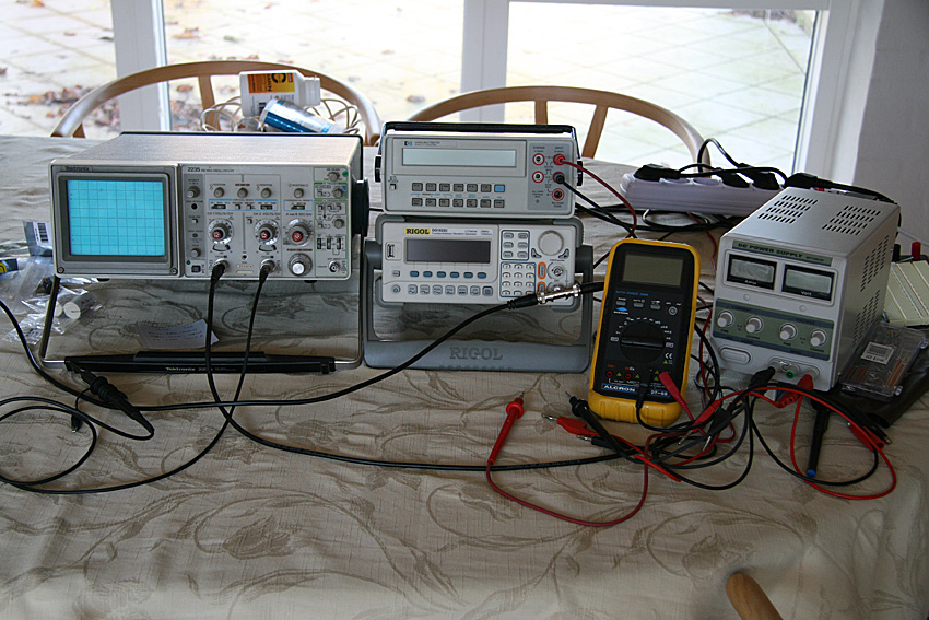

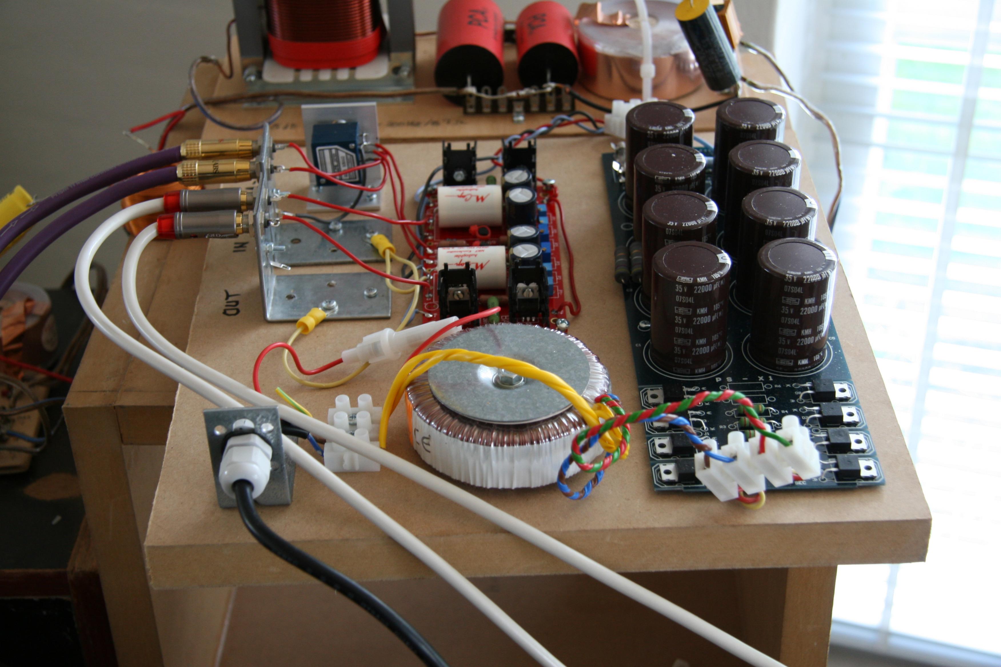

I just ´finished´ (see attached picture) my BA-3 as a preamp for F5 2 days ago, put it in the measurement lab, and connected it to my other equipment yesterday.
It is made with boards from The Shop, uses tightly matched Fairchilds output FETs, and Linear Systems JFETs and 1K trimpots. I put a 50K blue Alps pot in front of it, so I guess the input impedance must be around 25K. It sure took an hour or so to sound better, so for me the burn in question has been answered. It was not because of missing warmup, because it had been on for at least 5 hours, when I put it in the system. Output FETs are on around 47 degrees C., J-FETS less than 30 degrees.
It measures almost as good as the Aikido 6SN7 but so far I think the Aikido sounds better. But I will give it a week to really burn in and also play with the P3´s, before I decide what to do from here, because it is somewhat easier to case the BA-3 than the Aikido. And because I want a Pass designet audiochain if possible
I got 5.5 times amplification with 180 ohms as R13 - 4v P/P in 22v P/P out. That was what I wanted, but not nearly what to expect from the theory. Why is that ?
The power supply is heavy duty, just because I happened to have one, but it is the kind of PSU the BA-3 were intended to use. I may use that later for my comming F4.
Wonder if the Fairchild/LS sound as good as real Toshibas ?
It seems the site would only let me upload 1 picture, more to come.

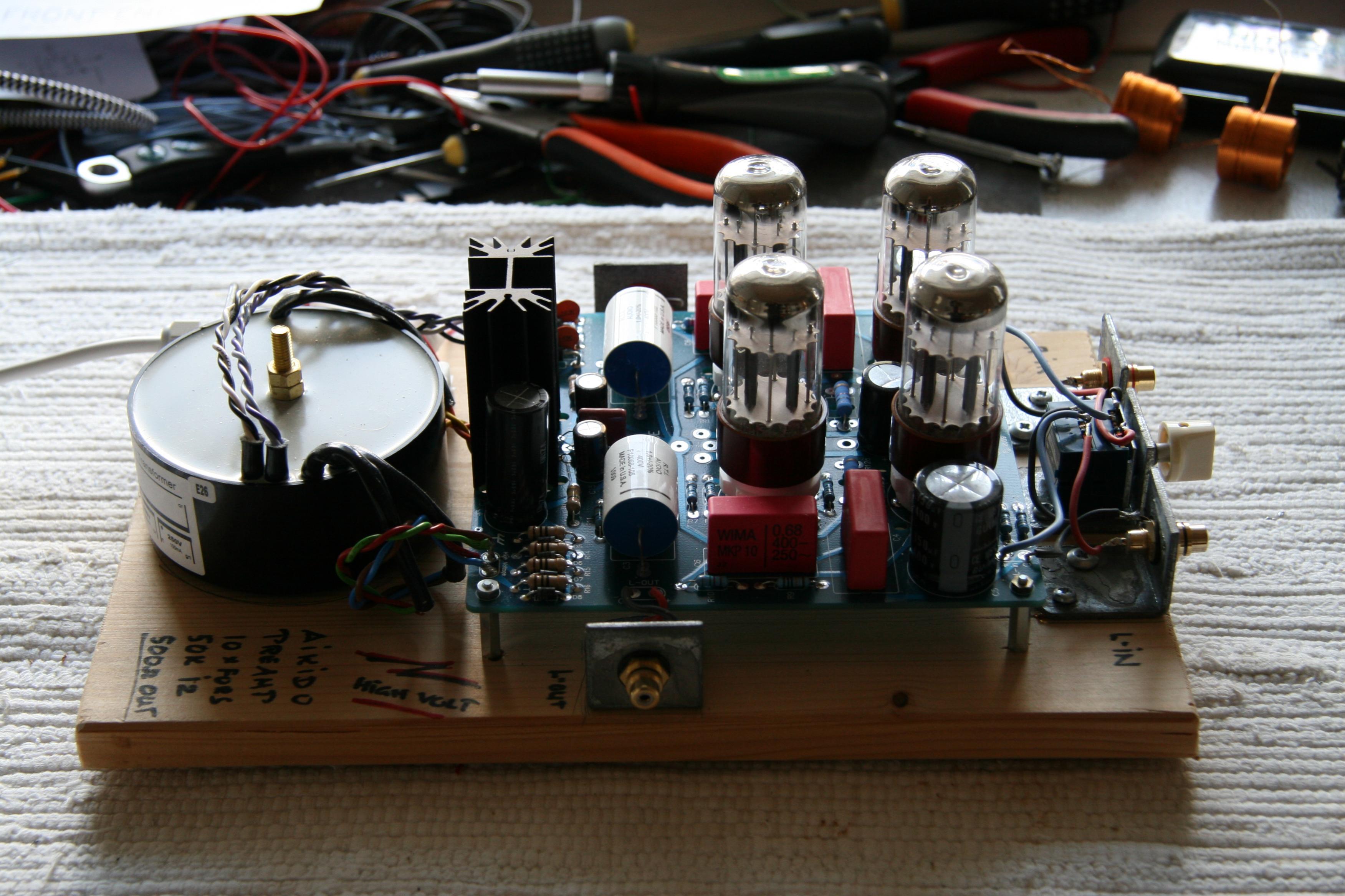

An then the Aikido.
Nice work, I like the open concept construction and valves always look nice
