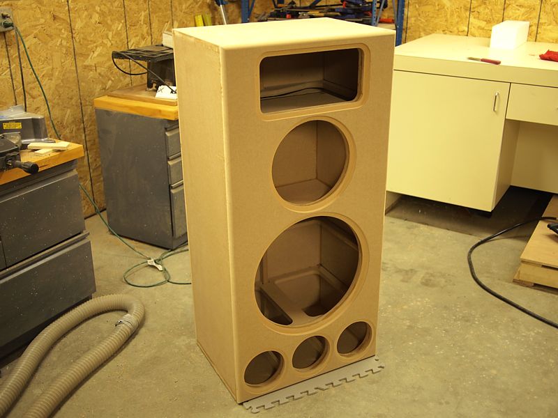

You might set up an email dialog with diysoundgroup.com to discuss purchasing their HTM-12 econowave kit ($300), along with their precut 1"->12"->18" Magnus-18 CNC 1" thick baffle, plus CNC cut 12" midrange sealed chamber. This baffle is cut for an 18" B&C woofer ( B&C 18TBW100). Explain your plan to Bi-Amp, and that you would only require the HTM-12 passive crossover tuned for the sealed Maximus-18 12" chamber.
HT-12 DIY Sound Group
(you can also compare to their Fusion-12 kit)
Maximus-18 DIY Sound Group

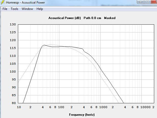

I will definitely work with Hornsrep and figure these numbers out. Heres a question: so the B&C woofer reaches its Xmax limits @ 40Hz 115 dB which works out to about RMS 500 right, would the Ultimax or HO (Dayton Audio RSS460HO-4 18" Reference HO Subwoofer 4 ohm) give me the same performance at a higher RMS but simillar sized box?
At some point you just have to decide for yourself. Give the simulations another go.
The dark line is a hundred watts into the B&C (175 litre ported box)
versus
The pale line is a thousand watts into the Ultimax (75 litre sealed box)
The Ultimax would be a very easy and compact build. It suits very low frequency use.
A pro 18" would suit a bigger box, and be a slightly more complex in build and setup. It would need a lot less power and would play well to a higher frequency.

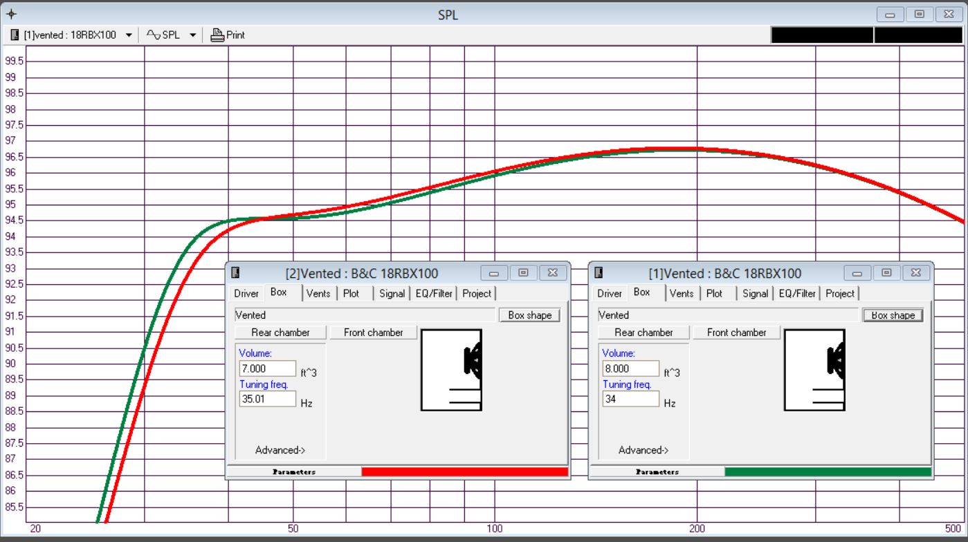

Published suggested diysoundgroup Maximus-18 Box Measurements: 23" wide" x 48" tall x 16.75" deep, should net over 7.5cuft for the 18RBX100 woofer which models -F3 ~34Hz.
Google review a few EconoWave speaker combination options so you will feel comfortable with your selection before purchase.

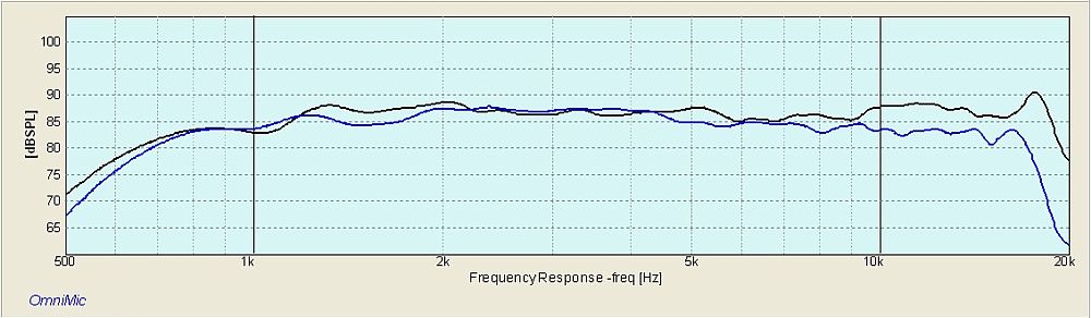

If you do email diysoundgroup.com, ask about purchasing just the TM portion of the Maximus-18 design, and explain how you will use Hi+Lo active crossovers and two amplifiers with B&C 18RBX100 woofer.
--The $142 Denovo FL-450 compression driver used in the Maximus-18 design has a copper shorting ring, aluminum phase plug, and neo magnet, producing superior high frequency measurements to the DE-250.
--The B&C documentation shows the same mounting outer rim diameter and drill hole ring diameter for both the 18TBW100 and 18RBX100. Should fit.
