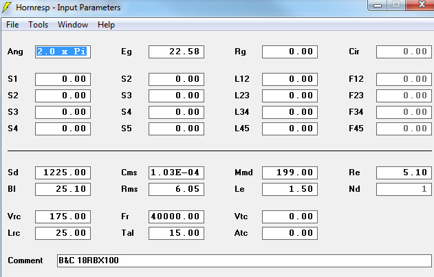

The first picture shows how I threw the data from here:
B&C 18RBX100 is a high power 18" subwoofer for speaker subwoofer systems- B&C 18RBX100 Speakers - B&C 18RBX100 18" high power speaker for speaker subwoofer systems has an xmax of 10.0mm. B&C 18RBX100 high power speakers available now.
...into Hornresp. This is 100 watts into a sealed box in half space, giving 115dB at 1 metre, with 7mm displacement.

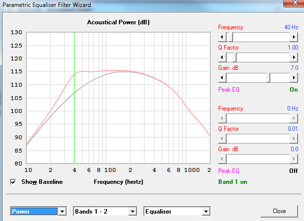

The second image shows the equaliser wizard in Hornresp. On the bottom left is as dropdown that lets you flick between different views, e.g. Power and Displacement.
The displacement window shows that, for this setup, this is the maximum amount of eq you could use. In this configuration, it will hit Xmax at 40Hz / 115dB.
...so a 500 watt amplifier would be enough to hit Xmax with this configuration.
To simulate a different driver:
1) Use the ADD button in Hornresp
2) Fill in the 7 boxes: SD, Cms, Mmd, Re, Bl, Rms, Le
Directly copy all the numbers that are stated
Any numbers that are not stated, just double-click in the cell, and Hornresp will prompt you on how to calculate them.
3) Double-click the Eg box at the top, input the wattage and the Re of the driver.
4) Hit calculate
5) Use F4 to compare the two speakers' responses
...and play around from there to work out what the trade-offs are.
