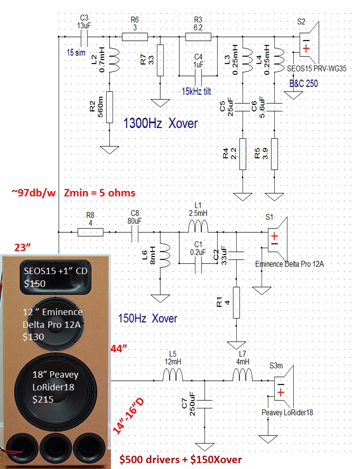

If you tune the B&C to low, for instance to 22Hz@100L your maxSPL is 110dB @20Hz (single driver). You'll need some boosting to get the response flat, but it can probably handle that. If you take room gain into account, you might not need a lot of boost anyway. Put them in corners to get some extra output

I will definitely work with Hornsrep and figure these numbers out. Heres a question: so the B&C woofer reaches its Xmax limits @ 40Hz 115 dB which works out to about RMS 500 right, would the Ultimax or HO (Dayton Audio RSS460HO-4 18" Reference HO Subwoofer 4 ohm) give me the same performance at a higher RMS but simillar sized box?

The dark line is a hundred watts into the B&C (175 litre ported box)
versus
The pale line is a thousand watts into the Ultimax (75 litre sealed box)
The Ultimax would be a very easy and compact build. It suits very low frequency use.
A pro 18" would suit a bigger box, and be a slightly more complex in build and setup. It would need a lot less power and would play well to a higher frequency.

If I mount the B&C 18RBX100 sub in their enclosure according to their Magnus 18 Baffle, will I get a good performance out of the sub?
Published suggested diysoundgroup Maximus-18 Box Measurements: 23" wide" x 48" tall x 16.75" deep, should net over 7.5cuft for the 18RBX100 woofer which models -F3 ~34Hz.

If you do email diysoundgroup.com, ask about purchasing just the TM portion of the Maximus-18 design, and explain how you will use Hi+Lo active crossovers and two amplifiers with B&C 18RBX100 woofer.
--The $142 Denovo FL-450 compression driver used in the Maximus-18 design has a copper shorting ring, aluminum phase plug, and neo magnet, producing superior high frequency measurements to the DE-250.
--The B&C documentation shows the same mounting outer rim diameter and drill hole ring diameter for both the 18TBW100 and 18RBX100. Should fit.
--Discuss purchasing at least the advertised CNC front baffle and midbass enclosure, and discuss the option to purchase the complete CNC cabinet flat pack.
--After midbass box and cross supports, the internal woofer volume is slightly larger than 7cuft
