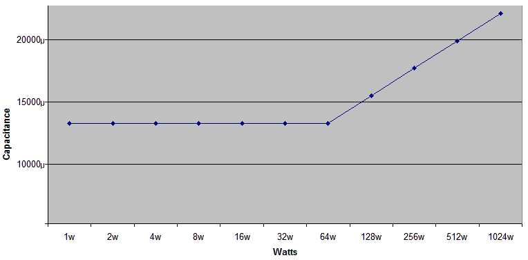

The new question is how much more than 13,300uF do we need for a Split rail amplifier, And how powerful must the amplifier be prior to incurring the need to increase capacitance further?
Demo: Estimated 3,300uF per ampere figure doesn't work with a miniature single amplifier attached to a very large speaker. Estimation fails if it doesn't output 2 amperes. And it doesn't--in that case the 3,300uF per ampere causes the error of insufficient speaker support. OR, with a very large amplifier the capacitance could be overlarge. The currently state of the art estimations do not work because there are several questions, not just one.

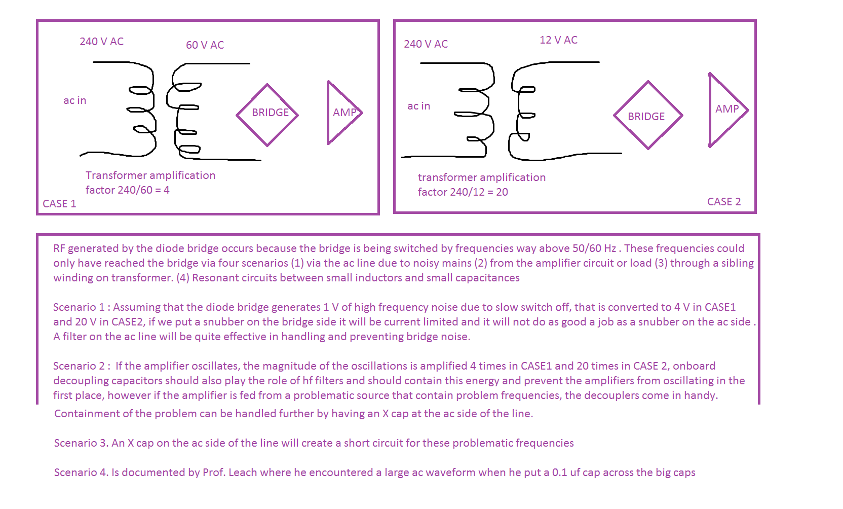

Here is a small article on understanding RF. This article requires improvement. Looking at this article you are likely to be better off with one large reservoir cap (unless you are using CRC) than several caps without CRC due to the likely hood of the formation of high Q resonant circuits between the capacitors
Is there a link to where you found this article?

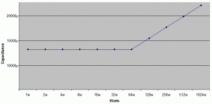

Speaker (frequency response) support: AndrewT's post at #759 "amplifier must be able to perform well down to ~ 2Hz to 3Hz"
Conflicts with: 8 ohm speaker, 50 watts, 240 va, Cmin Actual of 3600uF.
That chart has a narrow sample range.
But, a wide sample range could be so much more informative:
1w amplifier supporting 8 ohm speaker to 3hz
2w amplifier supporting 8 ohm speaker to 3hz
4w amplifier supporting 8 ohm speaker to 3hz
8w amplifier supporting 8 ohm speaker to 3hz
16w amplifier supporting 8 ohm speaker to 3hz
32w amplifier supporting 8 ohm speaker to 3hz
64w amplifier supporting 8 ohm speaker to 3hz
128w amplifier supporting 8 ohm speaker to 3hz
256w amplifier supporting 8 ohm speaker to 3hz
512w amplifier supporting 8 ohm speaker to 3hz
1024w amplifier supporting 8 ohm speaker to 3hz
The amplifier power is changed. The frequency response requirement is fixed.
With such a broad range, a minimum required capacitance line graph will be fascinating (and an easy read if capacitance per watt). I'm sure that yours will be much more accurate than mine.

"With such a broad range, a minimum required capacitance line graph will be fascinating (and an easy read if capacitance per watt). I'm sure that yours will be much more accurate than mine".
If the case for this argument could be taken to be realistic could not there be a chart showing two lines. One line showing the minimum transformer size and matching large capacitor requirement and a second line with maximized transformer size and the minimum capacitor values given a stated load impedance at the loudspeaker and power output maximum with 0.1% distortion requirement? This would seem to give a min/max SOA area of choice for the two components.
I will look into expanding the table I made, Daniel.
