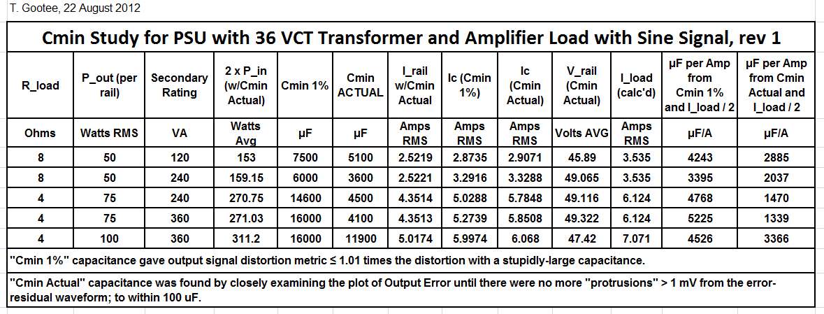

Below are the schematic used for the simulations, the main table of initial results, some info about the power supply behavior (because if that's no good then the data might be no good), plots of THD vs reservoir capacitance, and a zip file with the simulation files plus the Excel spreadsheet that has all of the data in it.
Please understand that I used THD here only as a tool (with an incomplete amplifier), only in order to more-easily find the minimum viable capacitance value, during C-value sweeps, to find the point (C value) where the PSU itself was no longer deforming the amplifier's output waveform due to the capacitance being too low. Otherwise, I would have had to try to very-closely inspect the output error plot and the signal output plot. And then there also would have been no real context for the swept capacitance values.
After all of that, I still didn't know exactly how to actually CHOOSE the minimum capacitance, from the data. So I tried a couple of ways:
First, I looked at the THD for a huge capacitance, then backed up until I found a THD that was 1.01 times the THD with the huge capacitance. The capacitance value found that way in labeled "Cmin 1%", in the table.
Second, I just "eyeballed" the plots and tried to pick a minimum value that was past the more-vertical section of the plot, without being too greedy about the THD, which was not changing much anyway, and while trying not to think about the uF per Amp that would result. That process was very difficult to be objective about, especially after expanding the low-level portion of each plot. The minimum capacitance found that way is labeled "Cmin from Plot", in the table, and might be more or less meaningless.
Note, too, that the plots posted as jpgs are not "to scale". The horizontal axes just have all of the data points, in sorted order. I also did some plots with linear scaling. They're in the Excel spradsheet file, in the zip file attachment, along with the actual raw data tables.
The transformer model was fed with about 144% higher voltage than I used when measuring the real transformer for the model, i.e. 173 VRMS instead of 120 VRMS. That way, it has an output level that's more like a 36 VCT transformer's secondary. Maybe I should note that when I originally tested it, I did so with both the primaries and secondaries paralleled, because a) that's how I was using it, and b) the modeling algorithm I had was only for single-primary/secondary transformers. I'm hoping that since it was in that high-current configuration when I measured it, and it was also designed for use with 230 V mains, that maybe the model won't be too far off. Anyway, I posted a little table of transfomer data that I took from the simulation, hoping that one of the transformer experts here will either pronounce it DOA or give a review of its good and bad points. (I will try to make whatever data is needed, for that, with the simulator. The original physical measurements are posted in this thread, in the transformer model schematic, or I can provide them again if that's too difficult to find.)
Oh, in order to be able to sweep the capacitance automatically, I used some equations that I found in a paper somewhere to calculate the ESR and EPR on the fly. ESR = {0.02/(cap_value*Vrating)} and EPR = {1/(0.01*cap_value)}. I used Vrating = 100 Volts. ESL was just set to 10nH.
Now that I have the setup built, it wouldn't be TOO terribly difficult to do it over again, if model changes are needed.

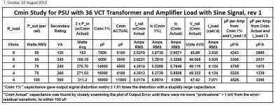

If we look only at the first (non-zoomed) plot for each scenario, we get minimum capacitances, in posted plot sequence order, of:
4500 uF, 3300, 4000, 4000, and 11000 uF.
Using the I_load currents in the table in post 740 at
http://www.diyaudio.com/forums/solid-state/216409-power-supply-resevoir-size-74.html#post3134179 ,
that gives "minimum uF per RMS output Amp" figures of:
1273, 933, 653, 653, and 1556 uF/Amp,
for the scenarios simulated, which should result in no significant distortion of output signal due to "capacitance too low", in each case.
THOSE are the numbers that "should" have been in the table column labeled "uF per Amp from (Cmin Plot)".
I'm not suggesting that those are what should be used, or that those should be used to form any "rule of thumb". But they "should" be workable values, for the scenarios tested, in terms of never experiencing gross distortion, up to the rated output power level (at 25 Hz).
I went back in and found the ACTUAL Cmin values, by carefully examining the magnified Output Error waveform while adjusting the capacitance 100 uF at a time.
The CT transformer power supply and Rload setup that is being used is a little confusing (at least to me). Since each rail does only half (one polarity) of the load's waveforms, in order to be consistent with the current and power being supplied, I changed the table to reflect "per rail" power output, and used 1/2 the load current when calculating the "uF per amp" numbers, which makes them twice as large when compared to the first version of this table. But the RMS power being delivered to the load is double the RMS power being delivered by each rail. If you prefer thinking about it with the full RMS current and power of the load, then just divide the "uF per amp" numbers by two.
I'm too tired to do a recap or anything, tonight. Going to bed after this.
Tom
