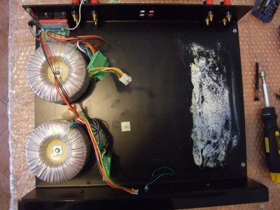

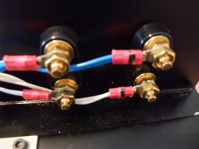

Terry and all, would you be so kind to provide a couple of good references and/or your findings on proper wiring methodologies (both signal and "power") and termination? Aside from my past University studies I've never heard of the latter applied to audio, with the well known exception of "digital" cables, but the MHz-GHz effects you have described well deserve it!
For example, the power amp I'm trying to fix has left and right speaker wires twisted together (where each pole of a channel made of a twisted pair, i.e. two wires of same polarity) and twisted with L and R input wires... this almost shocked me, since going from memory I would place L and R channels as far as possible (and the same between input and output)...
Stefano

A ClassA amplifier that does not transition into ClassB and/or does not clip will only bounce back Audio frequencies on the the supply rails. That certainly gives the rectifiers and transformer an easier job. But there are still spikes coming in from the mains and they still give the PSU a real job to do.
