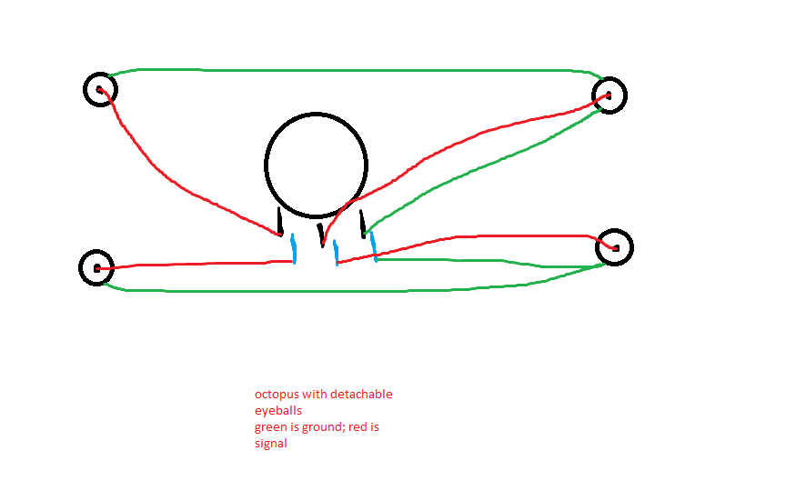

a question about my st70 and popping sounds from the speakers with certain input.
i was getting popping sounds from the speakers with the output from the sacd player into a volume pot and from there to the st70. but when i just plug in the mp3 player into the amp i dont get any popping from the speakers. do you know what is going on? i guess i should drill a hole in the st70 and put the volume control there though i dont want to. i was getting the same popping sounds when i had the tube preamp plugged in.
it was about 5 months ago that i started with preamp projects so i could listen to other than my mp3 player through it. today many hundreds of dollars later im still listening to the mp3 player. LOL!!!
Don't ruin your st70 resale value, doesn't your sacd player comes with a variable output? Guess not, post the volume pot wiring schematic. Could be a sloppy soldered ground, check the cables too.
this is the volume control i was using. i just did what i thought might be correct.
the cables are new, the problem is probably in my set up here.
now im thinking it's the sacd player. it's a refurbished model from sony i got off of ebay. one disc was popping but it was on the track when i backed it up.
bizarre
