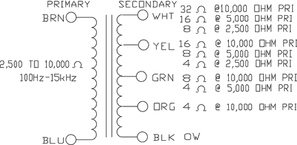

the output transformer has a number of leads for different loads as shown in the attachment, so i hook ground to the black wire from the speaker and the common ground and the other wire for a 4 ohm speaker would be the orange one i would assume. is this correct?

Don't keep trying, 37 volts is OK for a B+ 220 volts not for 300 volts. You'll just torture the tubes a little more. You will probably need another resistor for the PS, 100 Ohms is too low. See, you have to burn some volts, the change to cathode bias burns 35 but is not enough.
EDIT: 10K is too high for that tube. I would use the yellow or the green. Black to ground. 8 Ohms resistor should be at least 5 Watts for this amp.
The 1K resistors need to be 5 Watts, my mistake. Yo could also parallel two 2k(2 watts) resistors.
I have been reading the 13em7 data sheet and I was impressed, nice curves! It reminds me the 2A3. The amp will probably sound very good. I also have changed my mind about the cathode resistor, better to stay on the safe side: get two 1.5k (5W) resistors. You will also need 2 100uf 100V caps to bypass the resistors. Too bad you can't buy all this in your area, you may need other resistors as well.

the slope of the load line is determined by the output impedance? ... the secondary wires?
thanks!
Yes.
