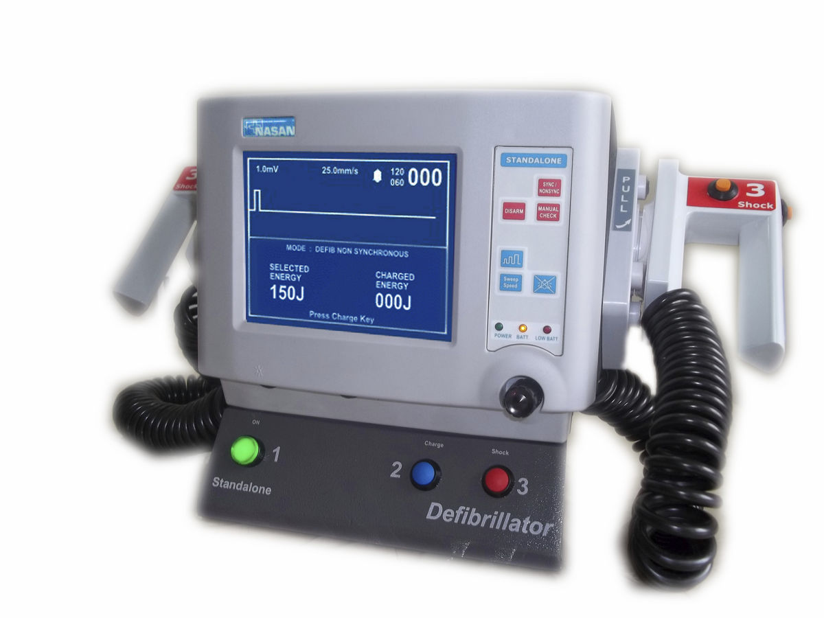

Simple question :
Why defibrillators indicates Joules instead of mA ?
Maybe because of the time variable?
Exactly. The defib probably works by discharging a capacitor through the body, but since the body's resistance varies a lot, the current could be anything, so there's no point in trying to specify a current. The energy delivered from the defib's capacitors, however, is known.
To make it simple,
Voltage is pressure across the resistance and current is the amount of flow..
High current / low voltage can give high energy

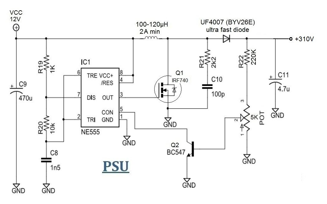

Why aren't switched mode power supplies common in tube amplifiers?
Maybe it could be used for bias. The 400v DC source inside the supply would seem ideal for the output stage of a tube amp. The 12v may be ok for some preamp tubes. Would the 5v be enough for lighting 6v heaters?
Heaters should be run at 6.3V if you put 2 in series then thats 12.6 not 12V.
The B+ can create some strange sounding music from the amp but it can be done.
From the point of view of bias..remember the bias is connected to the tube grid in some situations and so any ripple is a direct input..
I'm not sure how isolated a tube's filament is from the rest of the tube. Could a pair of PP output filaments be wired in series for 12v without effecting the function of the tube?
Remember some tube filaments need lifting so how are you going to lift a tube heater that is common to the DC HT rail? Yes you can run heaters in series it was done in old TVs the main thing is to isolate the mains from the circuit for both heaters and B+<<its a must do!
Another cheap switched mode supply is electronic ballasts used in fluorescent lighting. Maybe it could be used as is or modified for tube use. My concern with it is that some may not be 100% isolated from the ac line.
The biggest problem is ripple and RFI you can use inverters I have done it for fun with an SRPP stage aikido line amp..the big problem was isolating the heaters..also the current needed for the HT B+.
Thoughts?
Simple question :
Without being a doctor, I would say that what kills is the energy absorbed in a certain time interval.
Since the human body in general obeys Ohm's law, that energy, can be expressed in terms of the current and/or voltage.
W = i^2 R = i V = V^2/R [W] = J/s
By analogy, which burns, is the heat absorbed in a certain time interval, not temperature.
When you drink a cup of hot coffee, if you take it in a very short time, you get burned.
Doing it in small sips, as you do every morning, you do not burn.
The absorbed energy is the same, the temperature is the same...
Do you hear me now ?
I hope that we can now speak about PSUs.
OK, as they ask me so insistently, here are some of my own Rules of Dumb.
1) Use valve rectification for +B
I myself thought it was an audio myth, until I experienced it.
The advantage over the SS are not sufficiently clear from the standpoint of theoretical/scientific, but it works and it's wonderful.
As experimental verification, I know of people who, with eyes closed, recognizes the difference in sound.
2) Make regulated PSUs, even for heaters !
With MOSFETs, low noise opamps and precision voltage references.
Series regulation for power amps and shunt regulation for high gain preamps.
Use generous volage drop and capacitances.
3) Elevate heaters
At least 30 V instead of grounding, and at an adequate voltage for each topology.
AC heater power to listen your amplifier, "tube sound"
DC heater power to listen the music.
4) Make soft start for all PSUs, adding a time delay for +B
Valves suffer thermal stress when heating, and ion bombardment starts at about 100 eV, I myself have verified it experimentally !
Here you can see some interesting regulators
