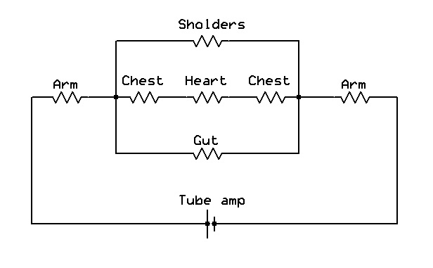

Without being a doctor, I would say that what kills is the energy absorbed in a certain time interval.
Since the human body in general obeys Ohm's law, that energy, can be expressed in terms of the current and/or voltage.
W = i^2 R = i V = V^2/R [W] = J/s

I agree that current is the crucial point.
I don't agree that a car battery is capable to deliver a deadly current. Car batteries are designed to deliver several 100A into a low-resistance load. But to pass the (commonly accepted) critical limit of 20mA across your body, you would need a 'load resistance' of 600 ohms. The resistance of your skin is in the kohms range already, depending on factors like moisture or skin-penetrating electrodes. The current path across the body has resistance in the kohm range too, mainly consisting of 'salt water' electrolyte.
Car batteries are dangerous because of the secondary effects: The high current capability into low load resistances will cause shorting metal parts to heat up quickly and cause burns.
According to German electrical safety regulations, 12V are within the SELV (safety extra low voltage) range and do not need any protection against being touched, as they are safe even for children or small animals.

Do you have any sources for that value? However, no one is going to apply voltage directly to the heart - and for a current path across the body, 20mA are the commonly accepted safety limit.
Rundmaus
PS. A note on 'irrespective of the voltage': Any current flow in the body involves a resistance, following more or less Ohm's law. Therefore current is *never* irrespective of the voltage, both are in a fixed relation determined by the resistance!
