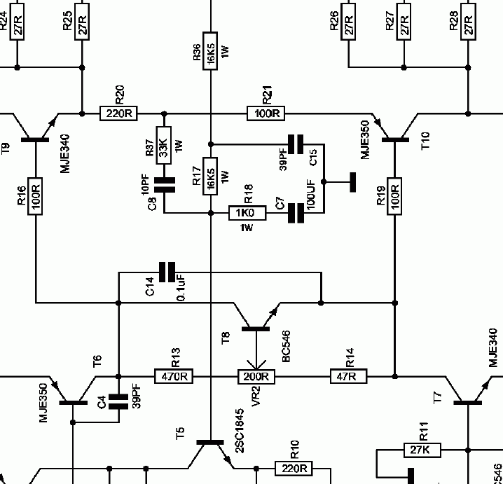

Error and Clarifications
Quasi,
While I had been working on an alternate version of your current schematic "nchan mos schematic only 06-05-06.pdf" I discovered quite by accident C3 to T1 has break in line just before connection dot to C3 collector. I actually did not notice this in the PDF until I converted the PDF to a PNG image. Even then I did not noticed for a few days of working on the PNG versions of the schematic. One has to zoom in qith Acrobat Reader to see the break. I am not sure if the break would show when printing the schematic. The problem can be seen at the 200% zoom level but is much easier to see at >= 300%.
I checked back to the prior versions of the schematic created and all of the prior versions, including the currents version, with the current software you use have the problem. I do not know if this is a software bug on the PCB software or not.
C7 is ideally considered a BiPolar. Most people use an electrolytic capacitor for a variety of reasons as I am sure you are aware. The PCB has a "+" symbol facing the signal gound. The questions are:
1) Is that "+" marking on the PCB if one is using a BiPolar capacitor?
2) If the "+" marking is when one uses an electrolytic capacitor instead is this the correct direction the "+" of the capacitor should face? I looked on the internet and diyAudio to find the answer. It seems from the research I have found a fairly even split based on the schematics. Some schematics show the "+" to face the feedback signal trace, others face the signal ground.
3) Any idea why there seems to difference of opinion what way the orientation of the "+" of an electrolytic capacitor from the feedback signal trace face or does this just boil down to personal preference?
While on the topic of the capacitor from the feedback signal line to the signal ground there seems to be some that order the resistor/capacitor to the signal gound order differently. In your BiPolar version of your amplifier you have the order reversed from the Mosfet version. The latter in a resistor/capacitor order and former is a capacitor/resistor order. Pros/cons, reasoning for choosing the different ordering of these two. The research I did on the internet/diyAudio shows both ordering choises being used in a fairly evenly divided manner.

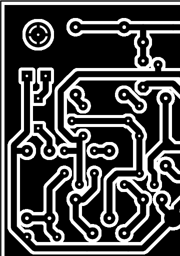

Any Advantage to Filling Bottom of PCB?
Hi all,
I am just curious if there is any advantage to filling in the space on the botom of the PCB with copper. Some suggest there is added to inductance between traces while other sugest it reduces the inductance between traces. There is also mixed opinion to if the added inductance is if the fill area is or is not connected to a ground. I assume the ground that one would connect woudl be the signal gound, yes/no?
Thoughts, comments and/or prior references on this?
I have attached an example section of the quasi PCB to give you an idea of what I mean. Please be aware this was just a quickie fill. Some areas need to be removed manually as they are too small or isolated. Again this was done with a graphics editing program and not a PCB CAD program.

The + is not personal preference, but to ensure the predominant voltage bias is in the correct direction to suit polarised electrolytics.
Some assemblers (not designers) of schematics do not realise that the input offset current puts a constant bias voltage onto the input terminal and similarly there is a matching bias voltage on the non-inverting input.
If the LTP input stage is made from PNP transistors the bias voltage is of opposite polarity to an LTP stage assembled with NPN transistors.
Some builder that did not appreciate the difference may assume that chance was coming into the equation.
However, the dual complementary LTP input stage has a partial cancellation of the input offset current and can with changes in environmental conditions have a bias that swaps polarity. Here it would be better to use a non-polar capacitor. But non-polar is better in most cases anyway. We only use eletrolytics to save space/money.
Pros/Cons to adapt in Leach Feedback Network

I have attached a schematic with the Leach feedback network adapted in with the best deduction for parts values I can make.

Re: Post #1193
Hi Andrew,
Thanks for your reply. With the large gaps in my knowledge and guessing I never thought the LTP was a factor in the direction the "+" faces if one uses an electrolytic.
I know the ideal is to use a non-polar capacitor, but as we all know not practical nor afforable for a C7 like capacitor. I forgot where at moment, but in this thread there was mention for the actual voltage that C7 will likely see most of time it was noted the electrolytic at that voltage would behave like a BiPolar anyway. If the voltage raised higher than the typical operating levels it likely meant they would be much higher and therefore mean there is a problem with the amplifier in terms of assembly error or part defect.
I have seen designs where they parallel a film capacitor between 0.1 to 1uF with the C7 like feeback to ground capacitor. Would this paralleling approach help deal with the compromise of not using BiPolar? I can buy a MKP 1.5uF cap for about $0.50, or a 6.8 MKP for $3.00 to parallel C7 if that is better than just a 100uF electrolytic.
Some suggest using two electrolytics in series to make a BiPolar, but there are opinions suggesting that is not as good as a BiPolar. Of course some opinions seem to not favour the BiPolar as the BiPolar has its own shortfalls.
Everyone agrees using a non-polar capacitor is best, but also know for a C7 like capacitor it is not practical.
What if I just used a 6.8uF non-polar capacitor with a 14.7K resistance which would still keep the 100ms RC time constant for R18/C7? Would that have any downside? I am not sure where I may have read, if in fact I did, that it is important to keep the feedback resistors used for gain low to reduce noise in the feedback signal? True?

Hi folks,
Just got back from Sydney. Quite a few questions here so I'll just cover the polarised feedback capacitor thing and the modified feedback circuit.
In theory a correctly adjusted amp should only have a few millivolts of offset at the output. This voltage will appear across the feedback capacitor but is so small that the polarity is practically irrelevant. If you can get a non-polar cap to fit by all means, but I have never had a problem with using a polarised cap.
I doubt the modified feedback circuit will make much difference given the component values used. At RF bands C15 will actually increase the gain of the amplifier and this is bad. The 10pF capacitor (C8) was intended to reduce the gain of the amp at RF frequencies and should be restored as it was.
Cheers
Q
