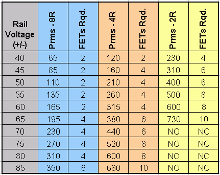

The following table can be used as a guide when trying to determine output configurations for the amp module. It provides recommendations for FETs per amp module (not FETs per rail).
I have based the table on typical IRFPXXX FETs rated at 180 watts (Tc = 25 degC), derated for a Tc of 50 degC. Naturally more / less FETs can be used if they are weaker / stronger.
The table does assume a virtual limitless power supply so actual power acheivements will probably be less.
The table does not remove the need to fully understand the workings of the 3 other main parts of the schematic as there are some voltages that need to maintained irrespective of the supply rails.
Let me know if parts of the cct aren't clear.

Hi Quasi,
I finished my first amp module with 2 fets (IRFP450) and +/- 45V supply (just for testing before I put all 6 with +/- 70V).
I'm confused because I can only get about 30W of power in 8 ohm speaker (by ear) and according to your tabel I should get about 85W.
What could be the problem of this power loss.
I also use BF420 (si-N 300V 0.1A 0.83W) instead 2sc1845 transistors. Could this can be the problem and if so please advice me what replace could I use.
Thanks in advance!!!
Pejin Miodrag
Your ear knows the 30W reference?! It's impossible to decide that an amp gives you 30W or 85W power when listaning to music... Anyway 85W is the RMS power. The music power, and others are much different... You aren't listening to a sine wave...
So if everything seems to be OK (no DC on output, etc...), your amp will gives out the 85W RMS to 8ohms with +/-45V. Don't belive your ears:)

Hi Pejinm,
I think you could hear a slight difference between 25 & 80 watts, just over 3 dB.
It is not easy to assess your situation because your other amp can sound louder depending on several possibilities.
- power supply size, how big is it on the quasi amp?
- tone control settings
- clipping (the ear may not hear slight clipping)
- your other amp is a NAD or similar (power envelope capability).
- the quasi amp isn't being fully driven (gain issue).
The way to check power delivery is to run the amp with sine wave input into a dummy load and then measure the voltage swing.
The table is a guide only. My amp uses +/- 73v rails (idle) and I achieved 210 watts RMS (single channel driven) into 8 ohms and 360 watts into 4. The transfomer is a 500va toroid.
The BF470 is not an ideal transistor for this stage, so for 45v rails try changing it to a BC546 (watch the pin-outs). Also with 45v supply you need to change R6 to 12K otherwise the constant current source (T4) will not work properly.
Cheers & good luck.

Hi Quasi,
A few quick questions about your table (Yes I can ask a "few") ;) :
1) "Rail Voltage (+/-)" is inclusive of rectifier loss, choke if used and filter capacitor, but exclusive of FET output devices and PSU rail voltage measured under no load?
2) How you measure or determine from Specs loss a FET output device will incur?
3) What linear derate rate did you assume for Tc of 50C (from the usual spec'ed Tc reference of Tc 25C)?

I'll throw in my two pence worth as I think it will be along the same lines as Quasi :)
The rail voltage is the DC voltage as seen by the amp when under load. You wouldn't use a choke on a class-b amp due to the current waveform being very dynamic compared to class-a.
Determining MOSFET losses is not really all that easy from specs and I tend to make an informed guess based on experience and tests. It is dependent on the gate-source voltage, transconductance, and on-resistance.

Hi John,
For the DC rails I used a theoretical power supply that would sustain its full power voltage to within 5% of the float voltage. I then determined a FET loss from graphs published by IR and varied those to a degree dependant on the amp load. These are drawn in the IR graphs as gate voltage v current. Then I added a little bit for the on resistance of the FET. Finally I factored these losses when determining the available voltage to the speaker. So it is after the rectifiers and does not consider rectifier loss.

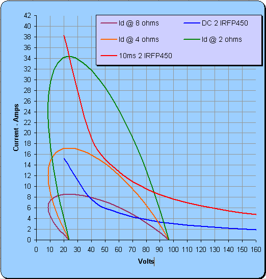

IR publishes the SOAR for devices at 25 degC in a chart and also a derating curve (power diss v temp) in another. I used the 10 mSec SOAR curve.
At 50 degC I determined that a typical IR FET could dissipate approx 85% of the rated 25degC rating. So I derated the SOAR curve accordingly. I did this to allow for warm heatsinks.
Then I used the data in MS Excel to draw a SOAR v load graph for each output configuration (example attached). Provided the SOAR curve does not cross the load curve the output stage should survive.
The SOAR v load chart posted below shows the situation with 4 FETs using 60 volt rails. As you can see the 10 mSec curve in red is just above the 4 ohm load curve (reactive) but well inside the 2 ohm curve.

Note the load curves posted above assume a worst case scenario of current and voltage being 45 degrees out of phase in a reactive load i.e. a speaker system. This extreme may never happen at any real power level but with electronics ya gotta assume the worse.
I had a look inside my recently purchased (proud smile) Yamaha RX777 receiver and there is no way that Yamaha have taken as robust approach as I have.

Thanks for your reply and the sample spreadsheet curve example you posted. I have to say I am far form as versed as you are in all these details. Frankly I have never quite understood some of the curves on the MOSFET datasheets, and one of those was related to SOAR.
Let me distill how I calculate SOAR based on my understanding form reading many postings related to SOAR as best I understand SOAR thus far. Via a spreadsheet I created I calculate for the design Tc (which of course if the max design Tc) and calculate Pd using the spec derate factor. Based on all of MOSFET specs I have reviewed Id is specified for 25C and 100C, but there is not a specified Id derate factor. What I do instead is take the Id Tc for 25C and 100C, create an Id derate factor and then calculate the Id for the design Tc in similar manner to calculating the design Pd. Of course for same Tc. I then do the PSU calculations for the design output power of the amp which takes into account rectifier losses, estimated MOSFET losses and a generic loss in PSU rails. Then I apply a calculation of the PSU current demand based on the minimum speaker impedance to determine current demands the output device(s) would be required to handle. From there with MOSFET spec data that has been entered in the spreadsheet the spreadsheet weeds out those MOSFETs that cannot meet the Vdss+safety margin entered in spreadsheet. Then the spreadsheet determines based on Id and Pd how many devices are required to meet the designed output power at the minimum impedance of the design.
Would you feel that effectively I have at least have done what you have done to determine the SOAR of a output device for a given design output power of an amp? I know I am assuming a straight line for Id derate which it not actually the case, but for the Tc's I will ever design for I have found that the Id derate I have chosen to interpolate is actually a higher derate fator that the curves on the graph if Id vs Tc indicates for the many MOSFET datasheets I have reviwed. I have also compared the rsults agains many different amp designs and so far it appears the spreadsheet calculations at least close or if not clise at least err on the safe side of the designs I have compared to. Please realize unlike you quasi, I do not make any calculations based on transient signal demands. By in large I do the calculations for RMS and and for P-P try, not must, to ensure the design meets within the RMS state of the output device specs for P-P of the expected output signal. Any P-P that is outside the RMS spec of the device I evaluate on a case by case basis manually for now.
