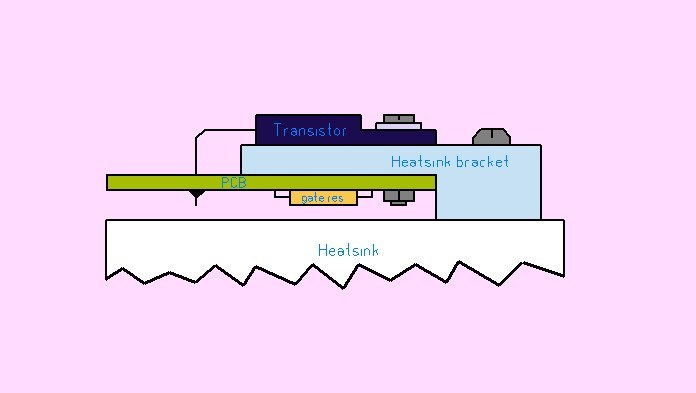

Hey John,
The board was designed specifically to use TO247's because they are also used as the spacers that keep the board off the heatsink. Using TO220's can be done with this board with the addition of a heatsink bracket. The TO220 FETs would then mount on top of the PCB and on the bracket (see rough drawing).
The 27 ohm gate resistors then have to mount under the PCB.
It would not be difficult to convert this board for TO220s along the lines I described above. It would shorten the length of the board.
It gets back to available time I guess, maybe over the next week or so I'll post one.

TO-220 Variant
TO-220 Variant
Hi Quasi,
umm, ok thanks for the reply and the mounting image to put a picture to what you described for a TO-220 version of the board. I was not envisioning something quite as complex to effect the TO-220 mounting. What I was going to do was mount the TO-220's on the trace side of the board as the TO-247's, but not parallel to the PCB, but at right angles like a T type mount. In fact I am likely to mount the TO-247 output driver version in same T-mount configuration. This would keep everything the same, including the gate resistors mounted on the component side as the current PCB design has.

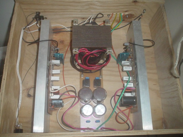

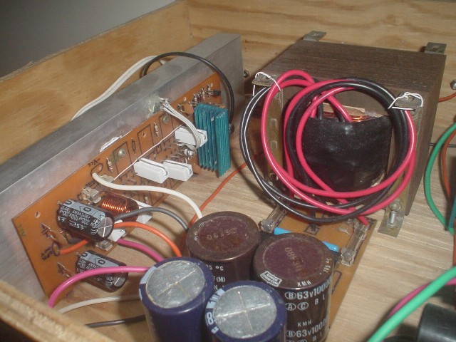

My Amp's Pics
Wow!! This forum has grown a lot...
Congratulations to everybody who made it, hope yours sounds as good as mine do.
I wanted to show you some pics of mine almost completed.
I run out of $$ for the case, so I had to use what I had available, my case is made of 8mm wood, and will have it painted black sooner (or later )
If I have some extra $$, I'll buy a metal case to put it in, right now is working very good, no overheating and no distortion.
Pic 1...
Pic 1...

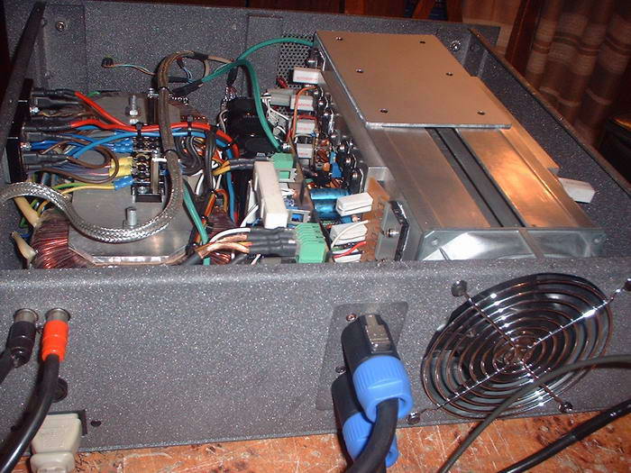

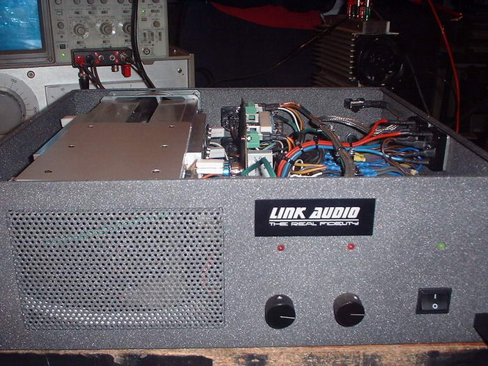

Hi! Quasi
Can I answered in your name. Thanks.
The amp. is real DIY, LUIGY, like whole life.(DIY), But main heatsink
fins must turn 90 deg.(up).second : imgine only one spark inside of amp, what will hapened with case? because made of wood.
Rolanddong:Yes 65-0-65 will be fine (about 2x90V DC ), dont forget beter cooling.I post first version of Leach Amp from 1980. I compare the sound with CREST, CROWN, PEAVY, PHONIC.Every of
this four amps has good power, but sound ,in my opinion is wery poor.Yes,LEACH.
Re: My Amp's Pics
Hi Luigi,
It looks from the picture of this post that you are only using 2 pairs of output devices? True? If so did you still use the IRFP450's or something different? Looks like you power supply is using a pair of Nippon Chemi-Con 10,000uF 63V capacitors each side of rail? True? I like to know as I have the same or very similar here (10,000uf 63V 105C), and access to more at good price I thought be good for medium power versions. What is the VA rating and secondary voltage of the transformer you are using? Like quasi I would like to know as well?
I suspect like you I will want to build one of the same power level as you have. I suspect I will select some choice TO-220 output devices I feel may be more suitable to my target for some verions of the amplifier I want to build. Some may be one or two output device pair(s) and some will be three or four output device pairs, no matter if I use TO-220 or TO-247 type output devices. Hence my interest in if you did make a two output device pair for your needs.
Shame my internet connection was not working for few months while my phone line was dead. Maybe you would of liked to use the 2 output pair variant PCB images of the boards without DC Detect I made from quasi's amplifier only board. I have not had chance to post these amplifier only boards yet as I need to get those files from a different system of mine. At least the 2 output pair version with DC Detection is available from free site page I put up a few days ago. ***** See quasi, I was not the only one having notions of a lower power version of you design
Hope you find the extra $$ to add in the other protection circuits and to place the ampl in a metal case Luigi. Great you have a working amplifier that you are happy with.

LuigiDJ said:Pic 2...
Coming soon, DC protection and delay circuit, termal sensing and fan, clip indicator and some other gadgets that comes to mind.
Happy listening !!
