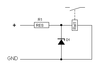

anatech said:Hi Quasi,
Is your friend's soft start in the preamp? Try a lower voltage relay and a resistor to compensate if that's the case.
-Chris
In my friends set-up the soft start is in the power amp. I take your point about using a lower voltage relay, it could however get too hot when the secondary voltage fully rises .....aaaah but maybe a zener could....sounds ok...I'll try it.
Cheers
Hi Quasi,
No, calculate the resistor in series with the coil to drop the excess voltage, a little more than you need so the relay has slightly lower voltage across the coil than spec. The pull in voltage is lower than the rated voltage. The hold voltage is lower still.
-Chris
-Chris
Yes but then we are back to maybe not getting enough voltage to pull it in under loud music conditions when turned on. I should use a series resitor as you say but also a 5 watt zener so that I can rely on a lower pull in voltage and then excess voltage is shunted away.
Hi Quasi,
Sorry, I don't understand something. The amplifier is getting a high signal as it is turned on?
Your supply will not droop that much or it will burn out the surge resistor. Standard practice is to mute the input signal and disconnect the speaker load until the amplifier settles down. At this point the surge relay has already closed. The drop out voltage is much lower, so don't worry about that too much.
-Chris
Edit: omit D1 in your diagram and you have what I was suggesting.
-Chris

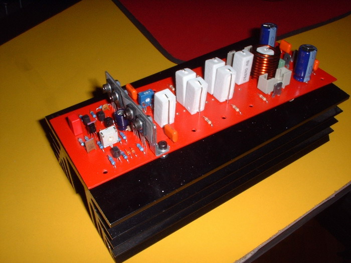

Re: PICTURE
Well done zeonrider!! Looks better than professional.
Is that a PCB or some material that looks like PCB? I have never seen a fire red PCB.
Where did you find that wonderful heatsink? The 4 (at least) coloured bypass caps are what type? What guage of enamled wire for the output coil did you use?

Re: PICTURE
Resistors wrong, color inflicting sound (or brain)? Drivers cooled insufficiently
zeonrider said:Of course in FERRARI RED
