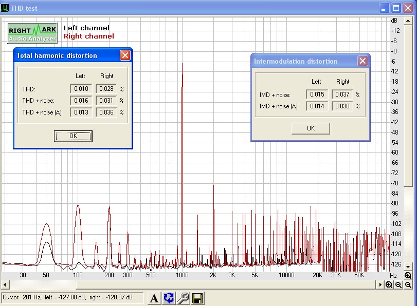

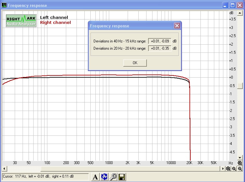

Some THD measurements on NMOS200
Take these figures with a pinch of salt. I haven't used this software that much before (Right Mark Audio Analyzer 5.3) and the rig wasn't perfectly setup. Soundcard is external M-Audio Audiophile USB set at 24bit 194kHz. Frequense responce limited to 20kHz.
I was about 5dB to low to really fill all the bits of the soundcard. Anyway, it was a fast setup to compare the looptroughcannel (Left channel) with the ampmodule NMOS200 (Right cannel) Ampmodule is just below clipping.
The listening sessions have to wait until I get more IRFP260 devices and also I wouldn't dare using these modules without DC protection on my speakers. I have to build such a unit first.

AndrewT said:Hi Radio,
can you identify any reasons for the left channel to consistently perform better than the right?
Yes, it's loopthrough the soundcard. Read the post again. Maybe an unususal way to test but the other module is not working and this was a way to compare the reference with the D.U.T. All is shown in one picture.
The reports in html from this software crash on me so I can't use them.
congratulations, this looks fairly good, I'd say.
A couple of questions:
- Can you eliminate the humming problem (that shows through at 50Hz and 200Hz)? It might explain a lot of the residual distortion (intermodulation). Powering the Audiophile USB via an external PSU usually helps a lot.
- Can you reduce to 24bit/48kHz? Many consumer audio equipment interfaces (such as most M-Audio products) suffer from raising THD+N at high sampling rates!
- Does your module's input filter explain the low frequency drop? It looks like the low pass at the input, with cuttoff around 15Hz with -6dB/oct., so that might be okay.
Thanks,
Sebastian.
That's the way such measurements are intended with this kind of software.
I think it's called "loopback". One channel of the audio interface is used as a reference (in terms of gain and frequency response), the other channel contains the D.U.T. in the loop between it's output and input.
This way, the properties of the audio interface can be ruled out of the equation.
The more advanced way would be configuring the software to automatically "substract" the reference from the D.U.T.
Cheers.
Cheers.
Thanks sek. I will see if I can do a better, more clear, presentation next time i present some figures in this community.The test still showed there is some qualitys in this amplifier design.sek said:That's the way such measurements are intended with this kind of software.
This software, RMAA5.3, doesn't seem to have any "subtraction" facilities inbuilt. Anyone using something different that doesn't cost anything or just a little?
