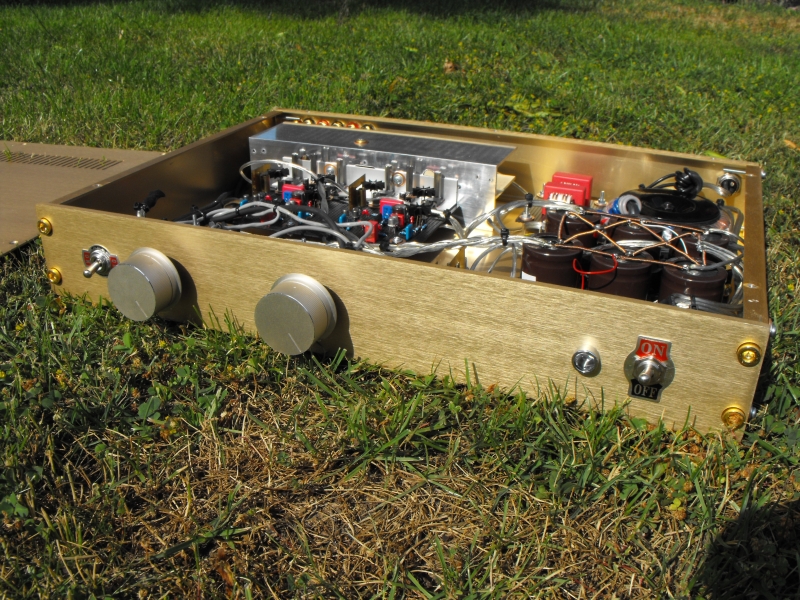

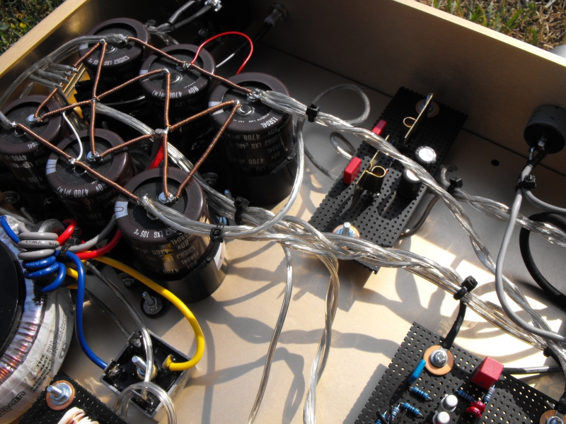

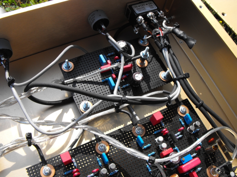

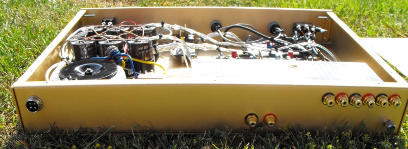

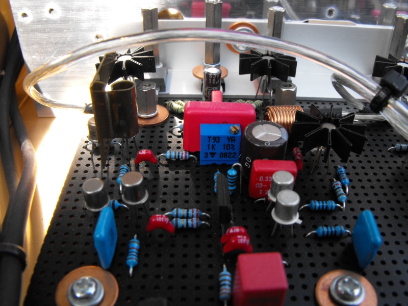

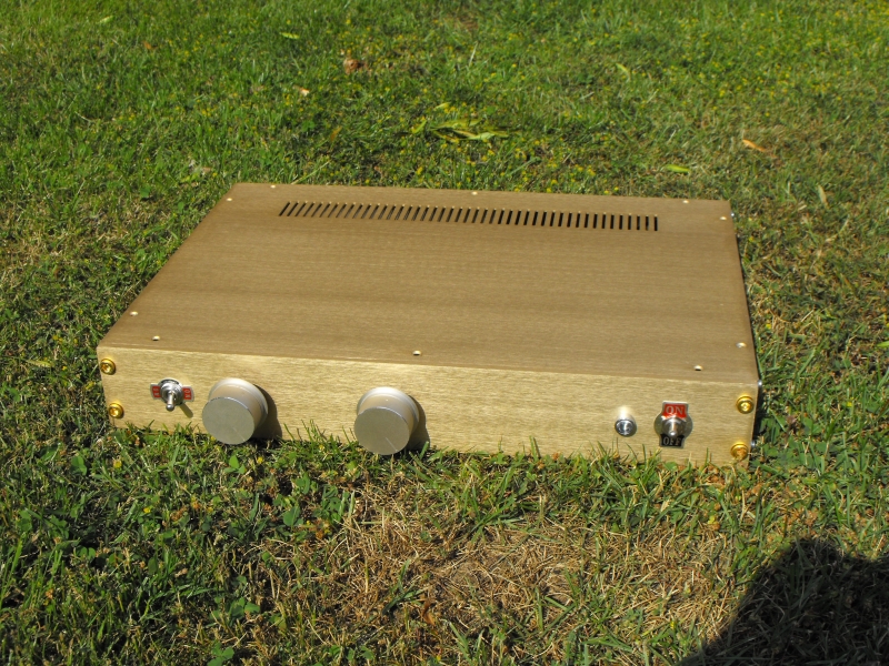

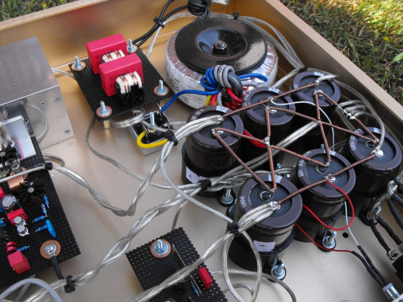

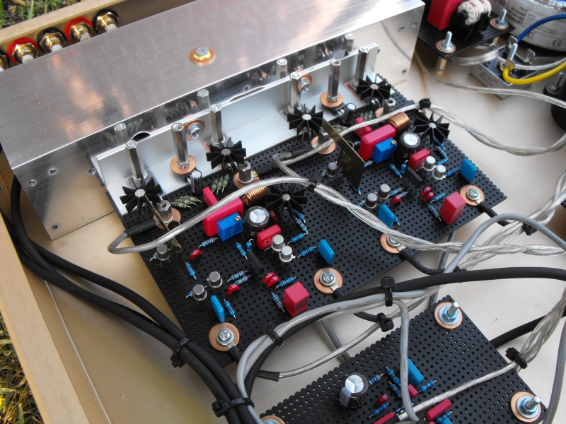

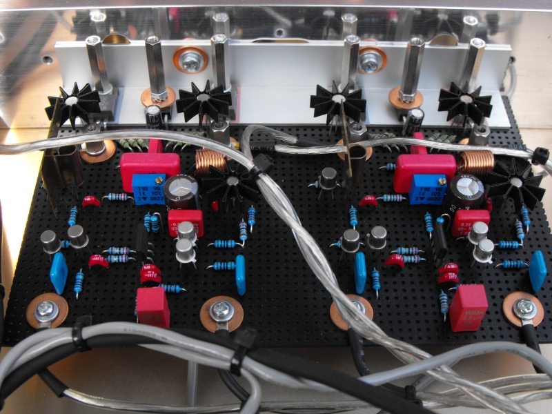

Last year i finished my new amp.
It is a shiny 2x18 watt retro influenced solid state amp.
Every transistor is from the late 60's but the circuit is more like the blameless amp from Douglas Self.
It has a build in RIAA correction amplifier for Vinyl playback and 2 additional inputs for CD or Ipod etc.
The whole thing is designed and simulated in Multisim 2001 and build on experimental (vero board) print that has been painted Black.
Works like a charm and sounds super smooth, I really like it.
And the modest 2x18 watt is more than enough for me.
Hope you guys like it.

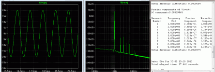

I intend to put the leach amp to "bed" (I still like it - a real classic). The spirit of DIY is NOT buying the prebuilt cases and spending the $$$ , but to clean the earth of all that E-waste and make the best amps we can. Classic pro-amp enclosures , with some tender care .... can have a NEW LIFE (BELOW ! - $40usd , with the caps ) .
Next pictures I post will be of the completed ... "21st century triple"
(below 2 - that is what a triple can really do , low loop gain- 65db !)
OS

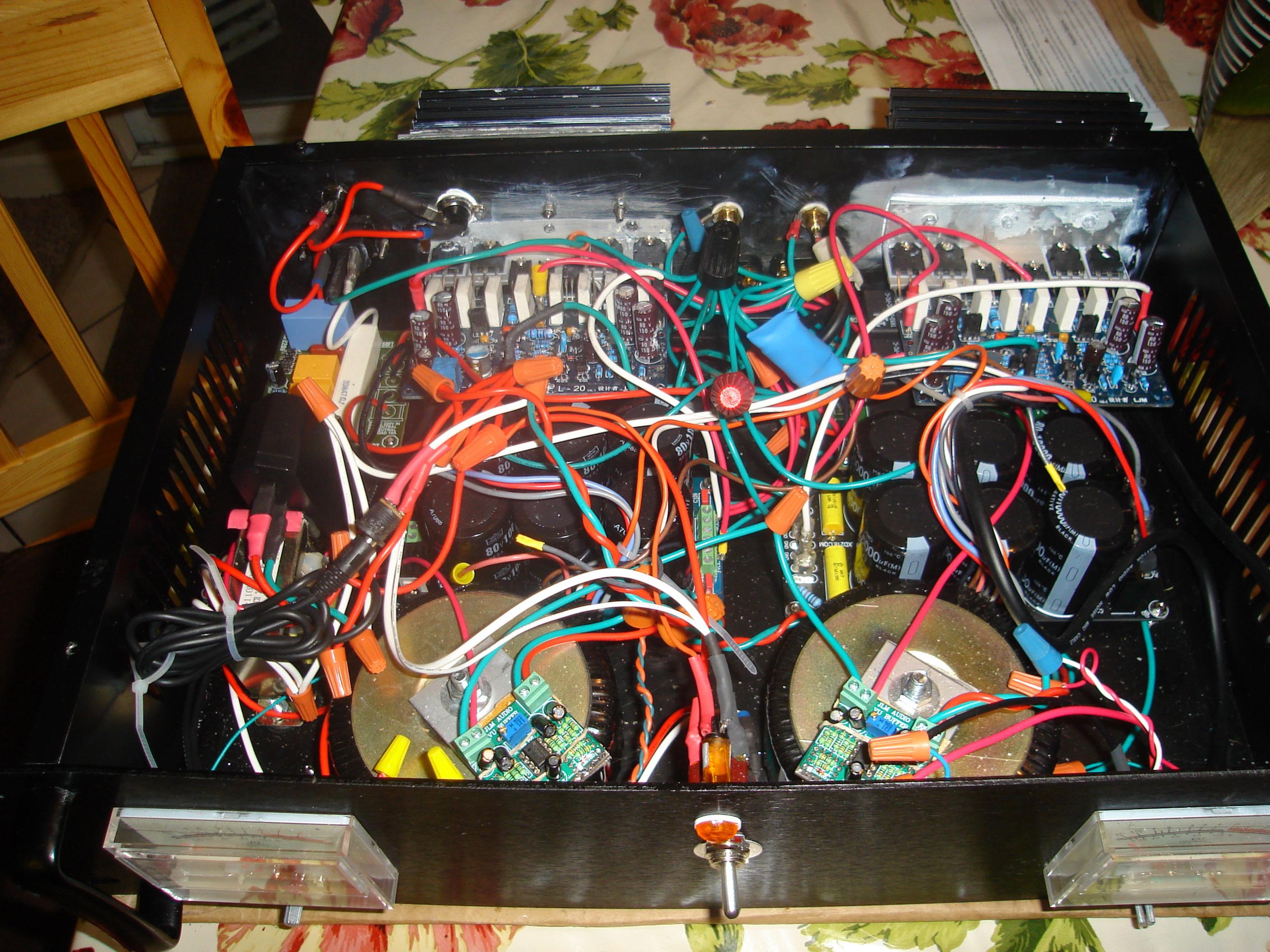

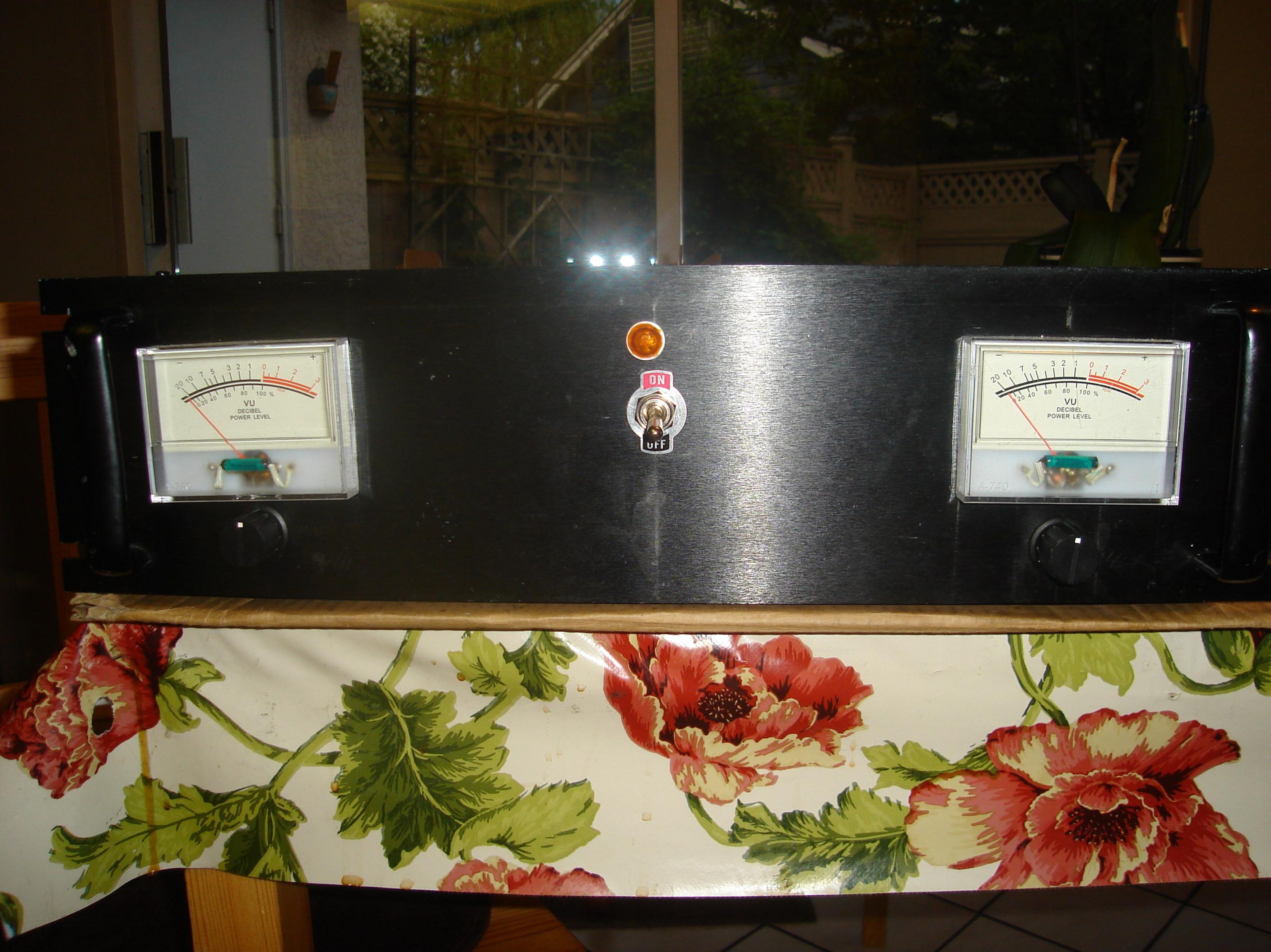

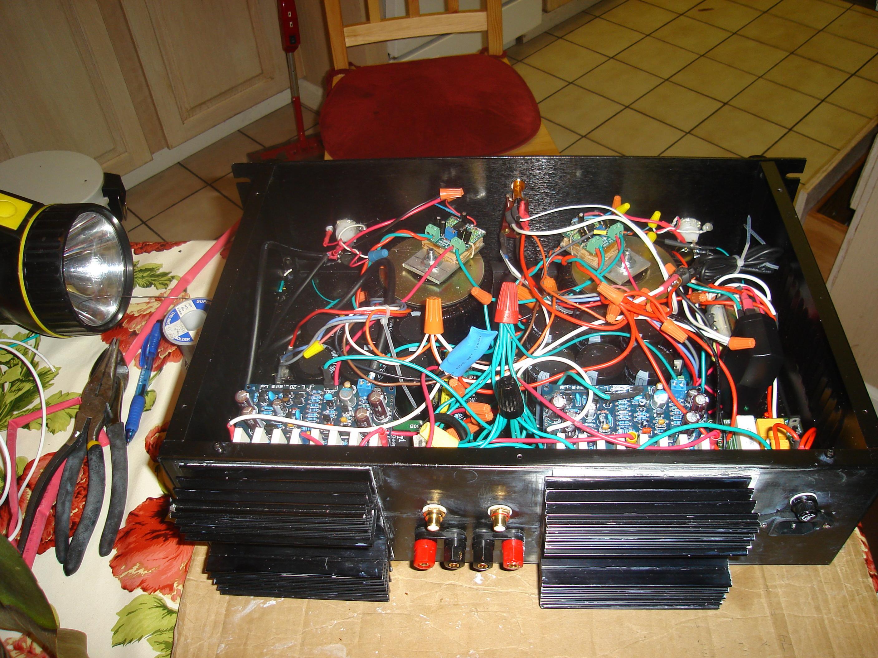

The DB Amp

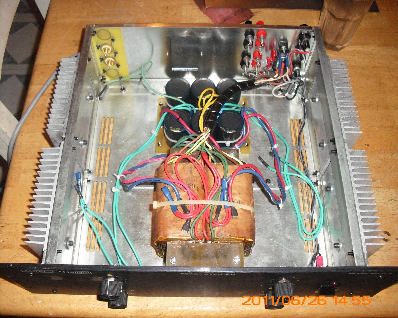

This amp was built from L20 circuit boards, power supply boards, soft start module board and speaker protection relay board all obtained on Ebay. The transformers are from Plitron surplus stock. They are rated at 40-0-40 volts @2.75 amps. The VU meters and driver boards were obtained from a company in Australia (JLM audio), they measure the amps output at the speaker terminals.
I had the not so bright idea of cooling with Peltier devices and being able to use smaller heat sinks. The Peltier devices did not pan out and I was left with the small heat sinks. So a thermal switch has been installed that will cut the AC if the temperature reaches 85 degrees C. so far, the heat sinks get quite warm but not too hot to touch. However, I have yet to leave it on for more than 2 hours.
The amp was built to replace an aging Yamaha M-70 amp which was being repaired far too often. My calculations said it would be cheaper to build than keep on repairing a 25 year old amp. The sound compares favourably with the Yamaha M-70. The DB seems slightly less grainy and more detailed than the Yamaha.
When it comes to building I am definitely not the artisan that you quite often find gracing the forums at DIYAUDIO. DB stands for "dog's breakfast" in honor of my chaotic wiring.
Wiring is like spaghetti
Regards zeoN_Rider
Sometimes spaghetti wiring is actually a good thing. But you don't see that many house-wiring wire nuts in many amps.
There is nothing like a wiring loom to cross induce signals.
There is nothing like a wiring loom to cross induce signals...... Sometimes spaghetti wiring is actually a good thing..........
not necessarily.Does neat wiring make it sound better ??
Correct wiring will sound better than incorrect wiring.
My most important finding over the decades has become:- that current flows around a circuit. That circuit must have a Flow and Return route. That Flow and Return route must have minimum loop area. Except when the circuit is part of a transmitting or receiving aerial.
