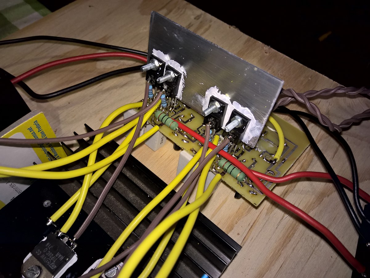

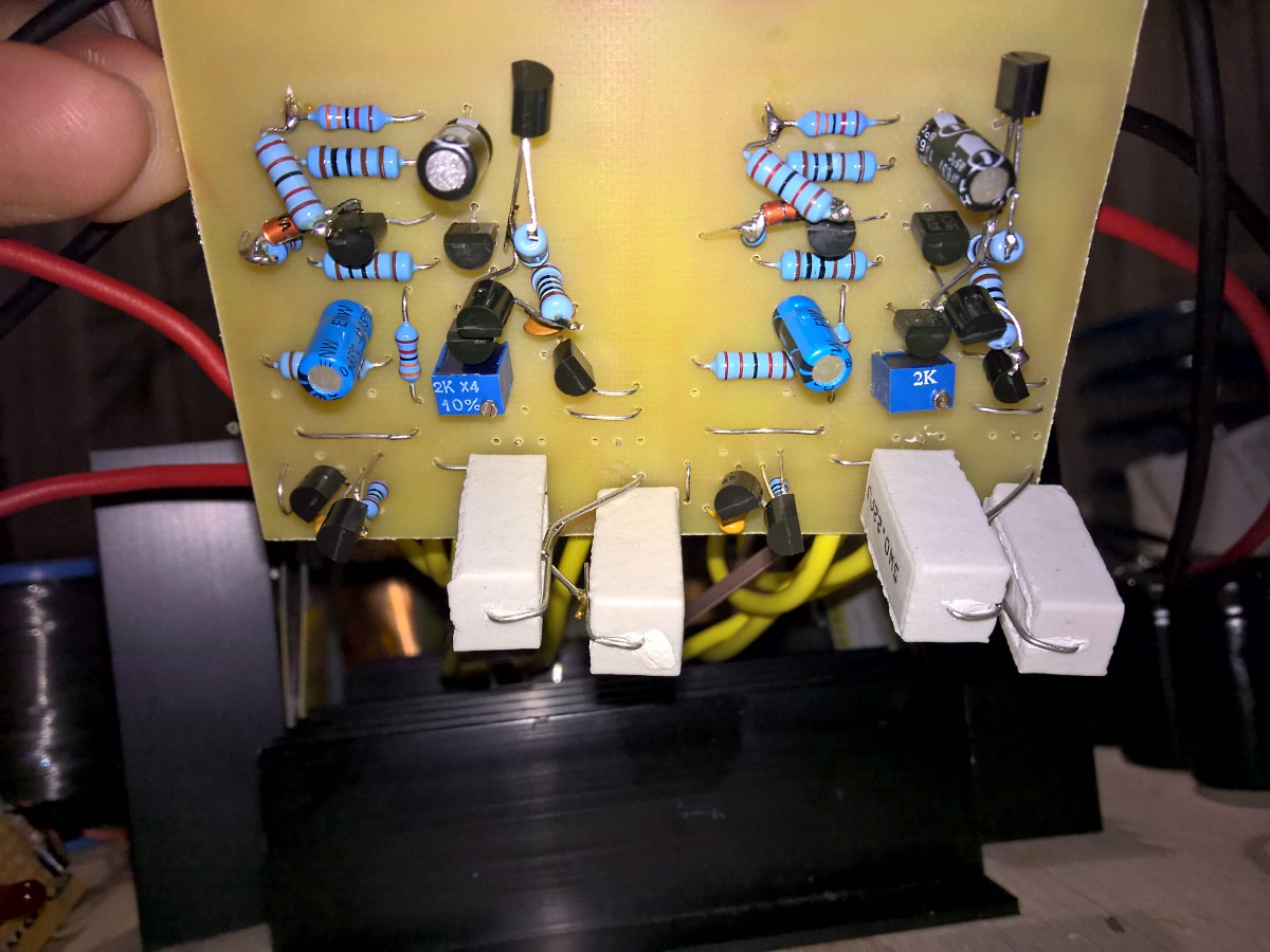

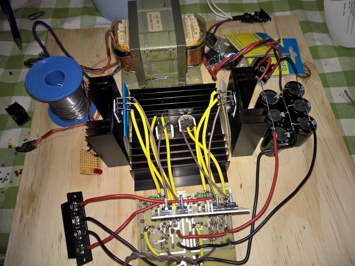

I've been working on this one in the background while I build other amplifiers. It's a constant project. I posted this in my 135W 8 / 270W 4 thread, but it doesn't reach those levels. It will in the near future. I'm getting there.
But this one is lovely - VERY quiet, and sounds good so far. Future PCBs will be neater. I like this design very much.

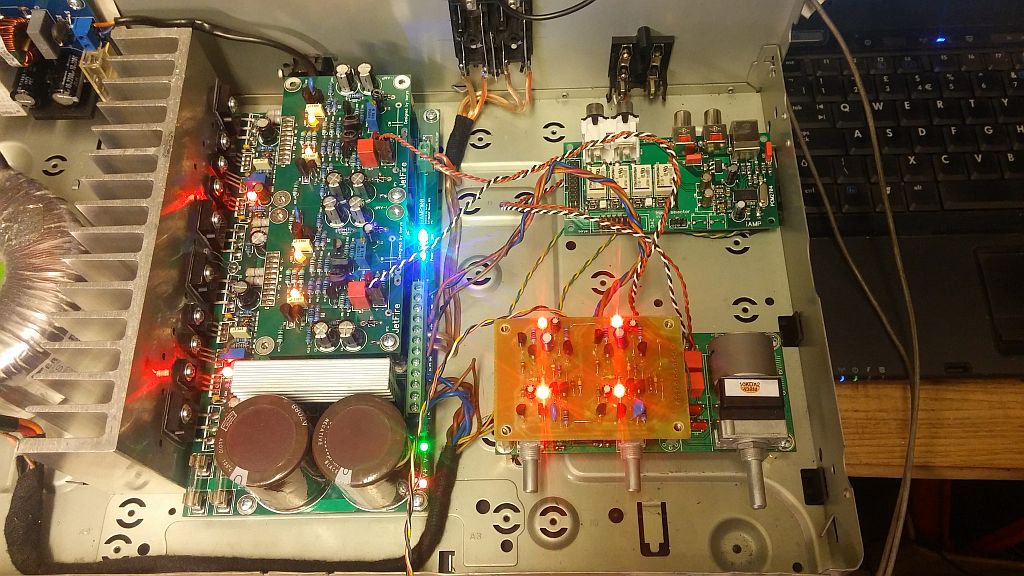

Sajti, let's see it in an enclosure.

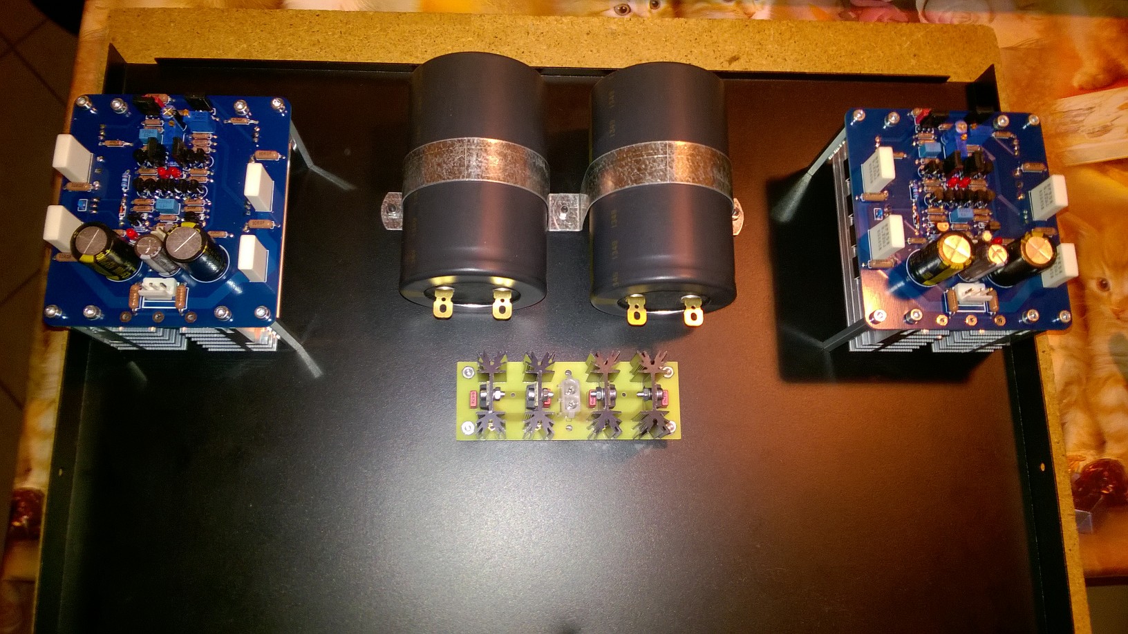

Under construction:
Since past few yeares I can not finish up any of my amplifiers, enclosure is open, amp not complete and I am digging in it.
But I have promissed myself that before end of the year I will finish one of them

this is standard 2U high rack box, made in Hungary. 400mm deep, and made by 1,2mm steel, with perforated front for fan cooling. The cost is about 35Euro.
Not really high end, it has industrial look, but I prefer it, especially the low height.

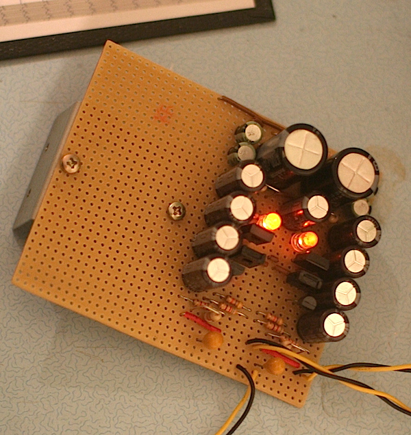

Best headphone amp I have ever heard. Finally in stereo with cross feed filter.
http://www.diyaudio.com/forums/pass-labs/271926-f5-headamp-72.html

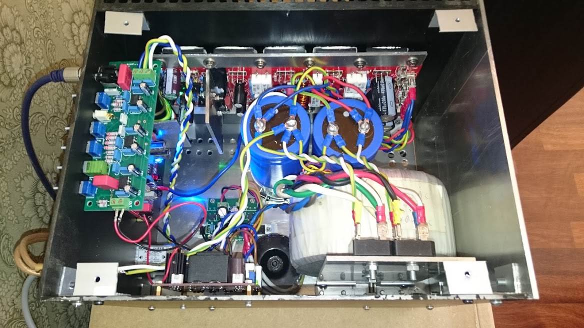

First, thank you, guys for the warm words.
My wife did not believe that I finish it ever
To be honest, I do not know how to add big images - I put them into gallery, but can not find link name. And case even small - inside 2x 1000VA James Audio transformers, 4x RIFA PEH200 100000uf x 80V capacitors, I wanted to put bigger Kendeil caps for driver rectifier, but had to put small (8x 6800uf 100V) - no place. And heat sinks are not enough big - I have 54C temperature (BIAS of current amplifier 1.2A, power +/- 60V)

Dear Mrcloc,
Thank you for the warm words - but if not me - modushop.biz made the case by my draft - and they made really good job. They only missing internal steel plate for 500 mm deep case - they offer 400 mm plate - I took it, no choice: 3mm aluminum bottom plate will tot be able to hold two 10 kg transformers.
I would like to hear opinion, is 54C heatsink temperature too high (room 23-24C) or acceptable - Erno Borbely wrote in his manual that up to 55. The amplifier schematic - Borbely Millenium 200W, output stage has 8x (K1058 + J162) matched.
