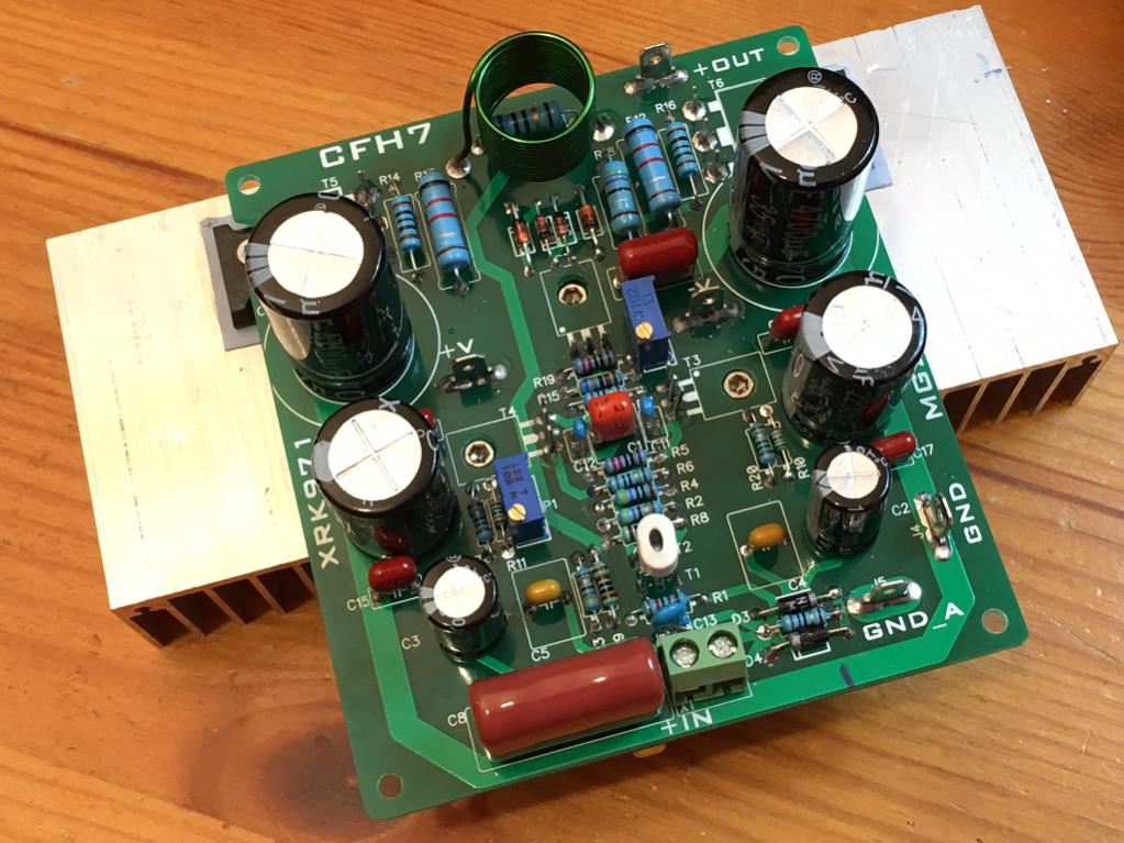

CFH7 Amp
Amp description here:
http://www.diyaudio.com/forums/solid-state/294834-cfh7-amp.html
Sound clips here:
http://www.diyaudio.com/forums/soli...y-simple-quasi-mosfet-amp-14.html#post4811896
Running several days straight now, No fan needed, bias is stable at 160mA, offset stable within 5mV.
Sound clips here:

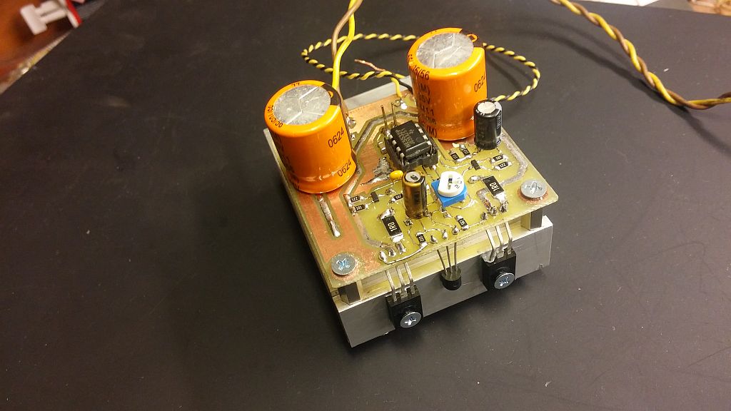

I think I will use CFP output stage next time, try to get 4W out of it
But to be fair, the 3,5W is plenty for all day listening, let me say 10W will do the job for sure.

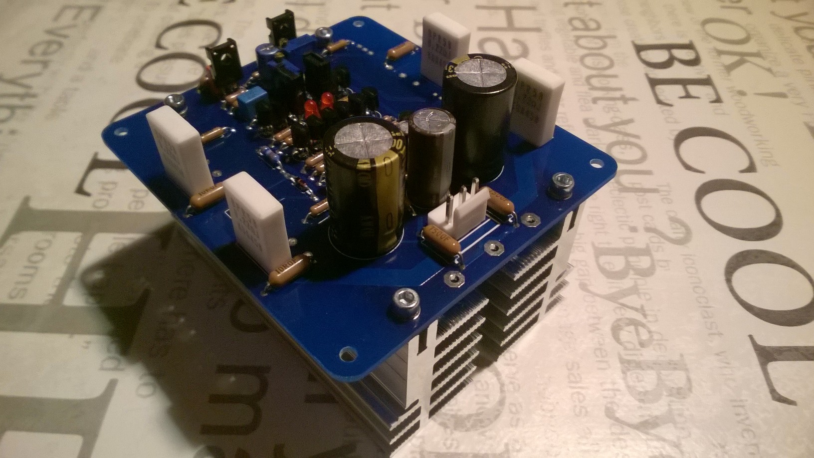

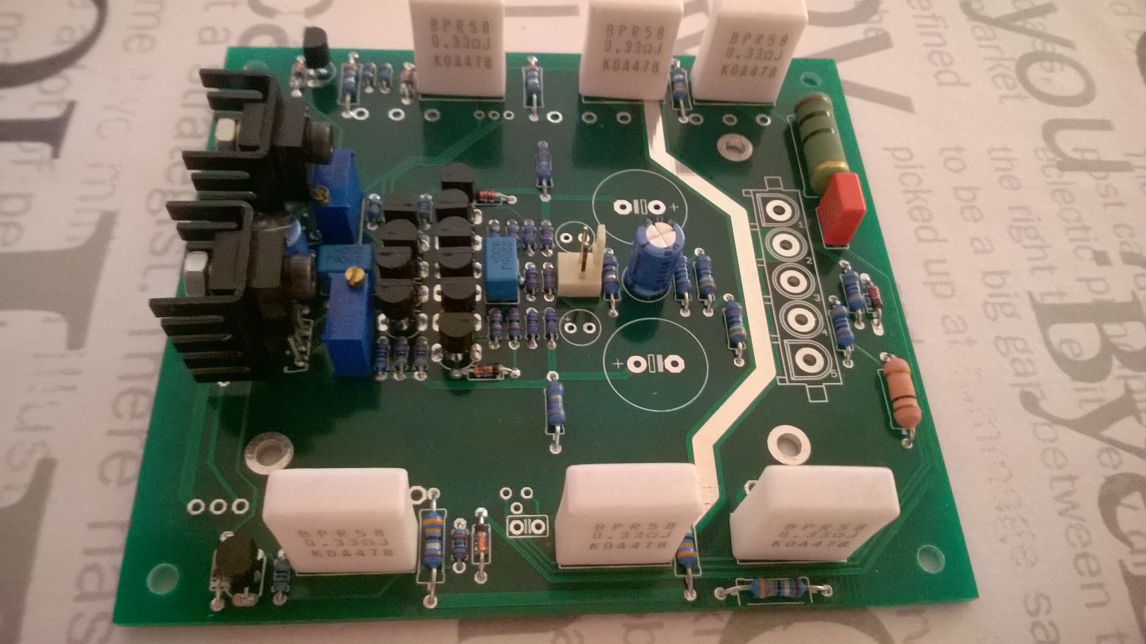

The boards look very nice !!
The 3 pair one looks fully symetric 2x LTP + current mirror on top of it VFA ??

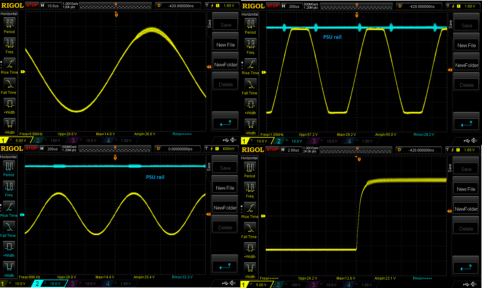

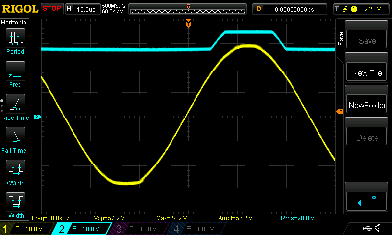

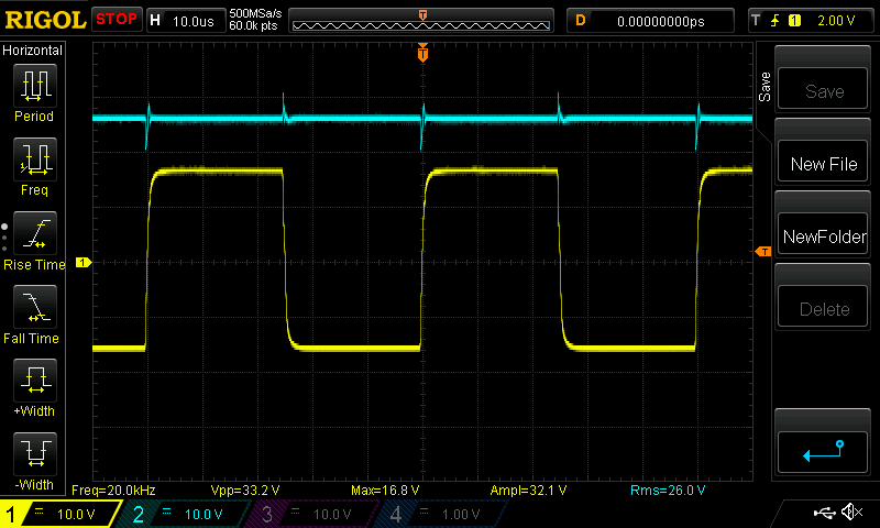

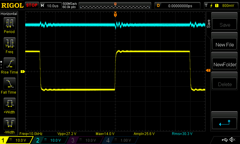

From my experiance it is very good to putt 47-100uF just by the drens/collectors to avoid ringing. Bellow my bad example how I have burned 20 pairs of mosfets while testing The fix was very easy, just a small cap by the each transistor. The last pic (Newfile 5) is the fixed one with 100uF by the drain + bootstrap.
