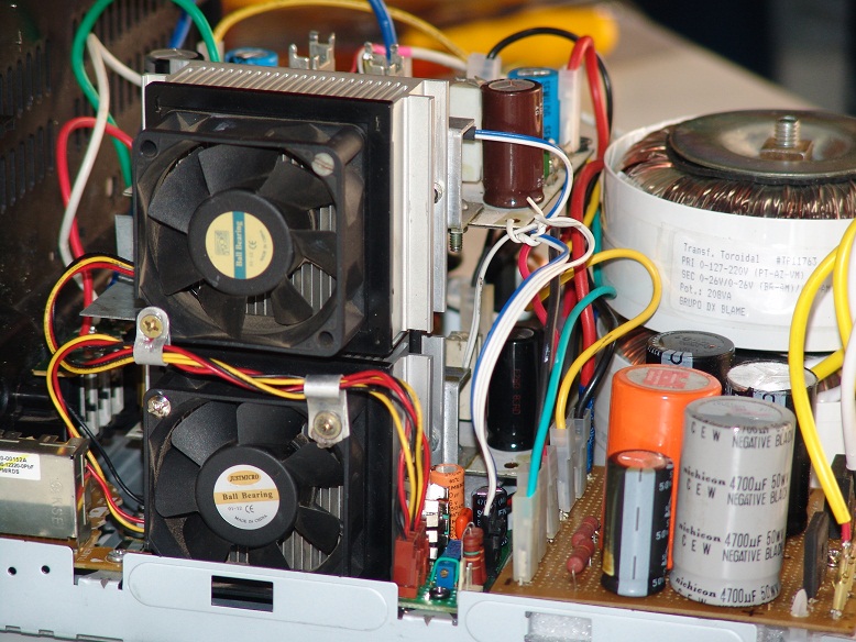

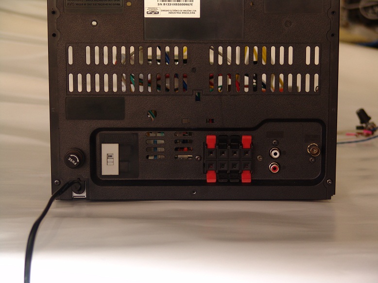

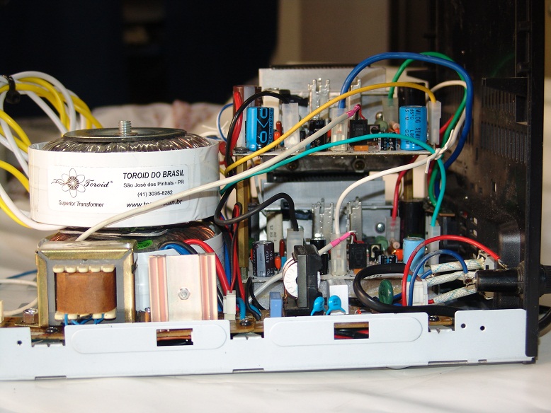

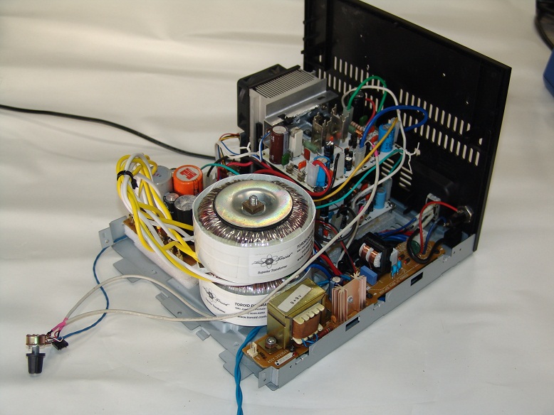

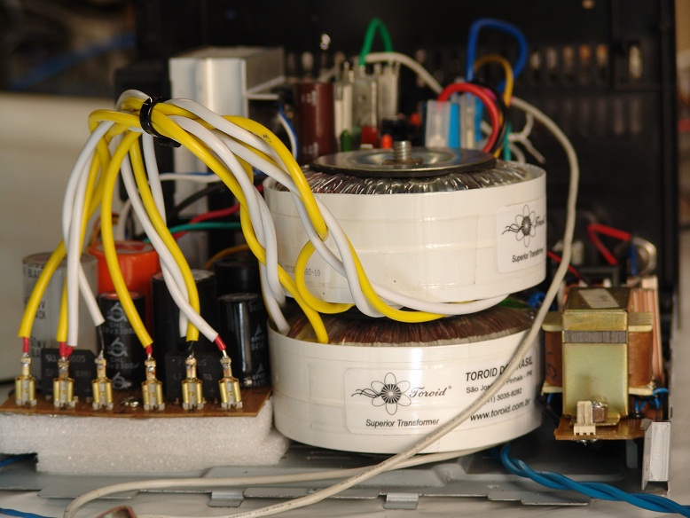

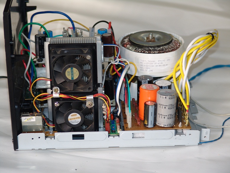

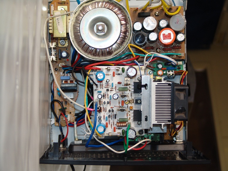

An amp built from junk parts deserves a recycled case!

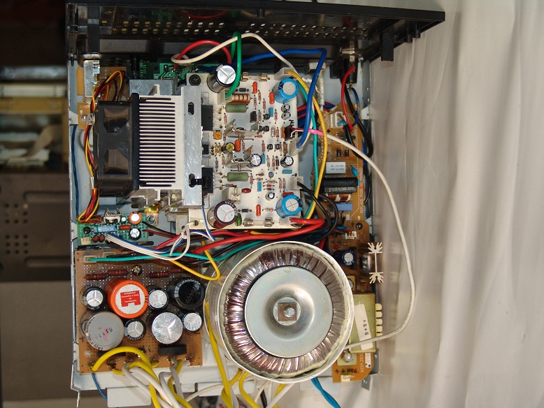

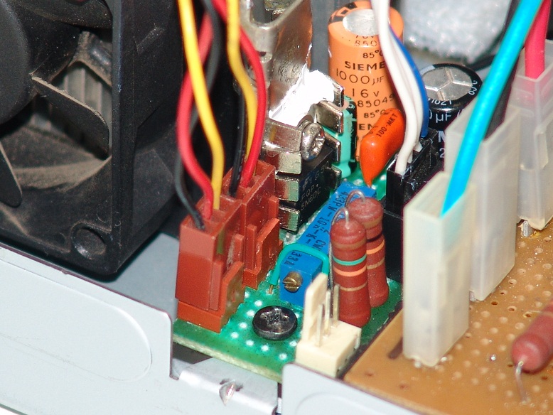

A friend of mine asked me to fix his stereo, and I decided to place a new stuff inside the case!
Circuit from http://www.diyaudio.com/forums/soli...d-amplifier-out-junk-parts-4.html#post2180731
Sorry, I forgot to take a picture after finishing the job!
Max.

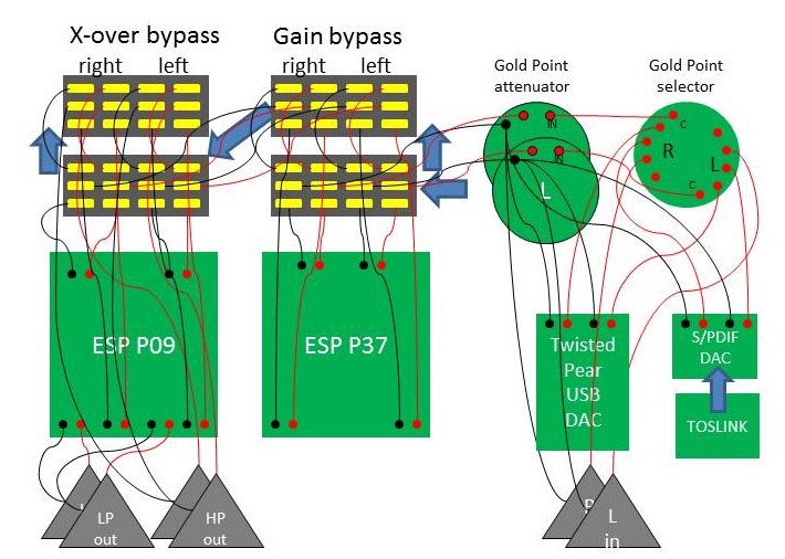

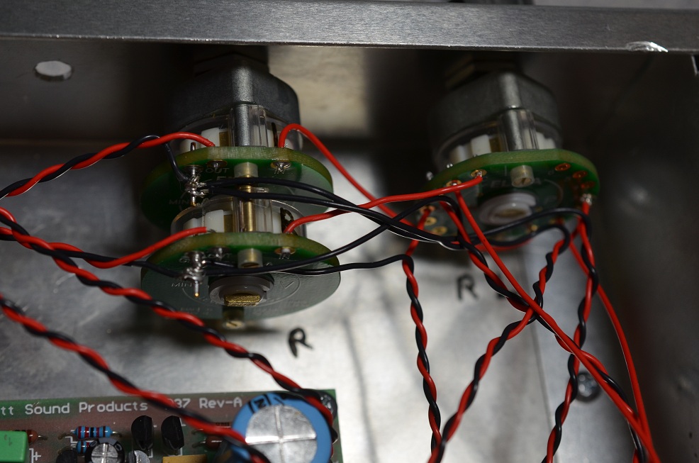

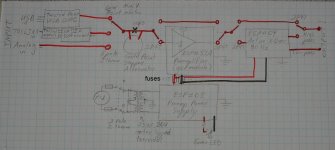

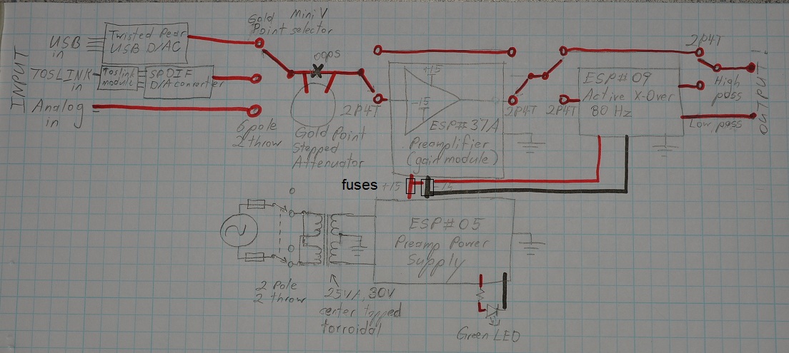

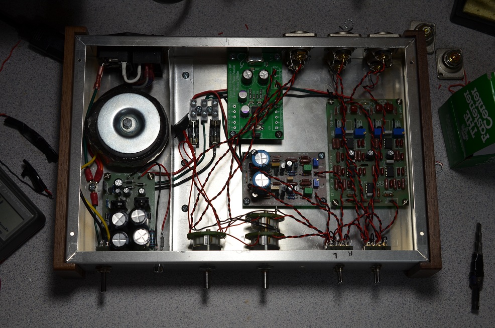

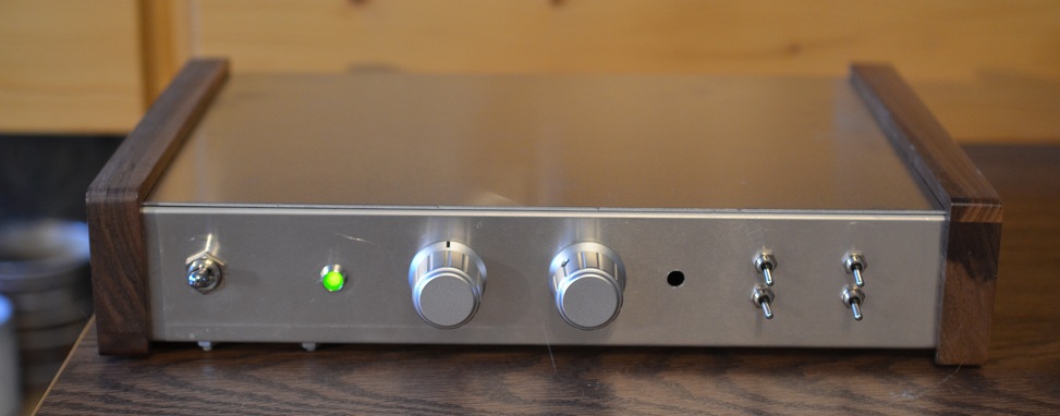

My preamplifier!
I've been working on this on & off since last fall, and it's still not finished!

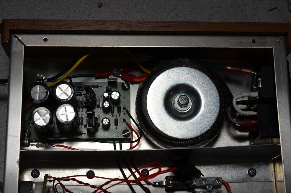

Power supply
· Schurter Power Entry Module. Mains input, dual fuses and power switch all in one convenient package!
· Triad Magnetics 25VA 30V torroidal transformer
· Another power switch, this one on the front of the chassis.
· Elliott Sound Products P05, Preamp Power Supply Regulated for 30VDC with a 30VAC input.
Inputs
· Twisted Pear USB receiver module
· SpeakerNet TOSLINK optical input module. This will probably operate off a 9V battery when it gets installed.
· ES9023 / WM8804 S/PDIF DAC. This is an active group buy on diyAudio being run by Unixdeveloper. I’m still waiting for a BOM and boards. It will have an on-board power supply, but I don’t know how I’ll power it yet. Space is available in the chassis next to the Twisted Pear DAC, above the barrier strip & fuses. The hole on the front of the chassis is for its on/off switch.
· One pair of good old-fashioned analog inputs. I don’t have room on the back of the chassis for any more RCA jacks.

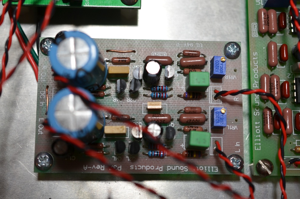

Gain Module
· Elliott Sound Products P37 Minimalist HiFi preamplifier.
· Bypass switches are the best I could find: NKK Switches M series.

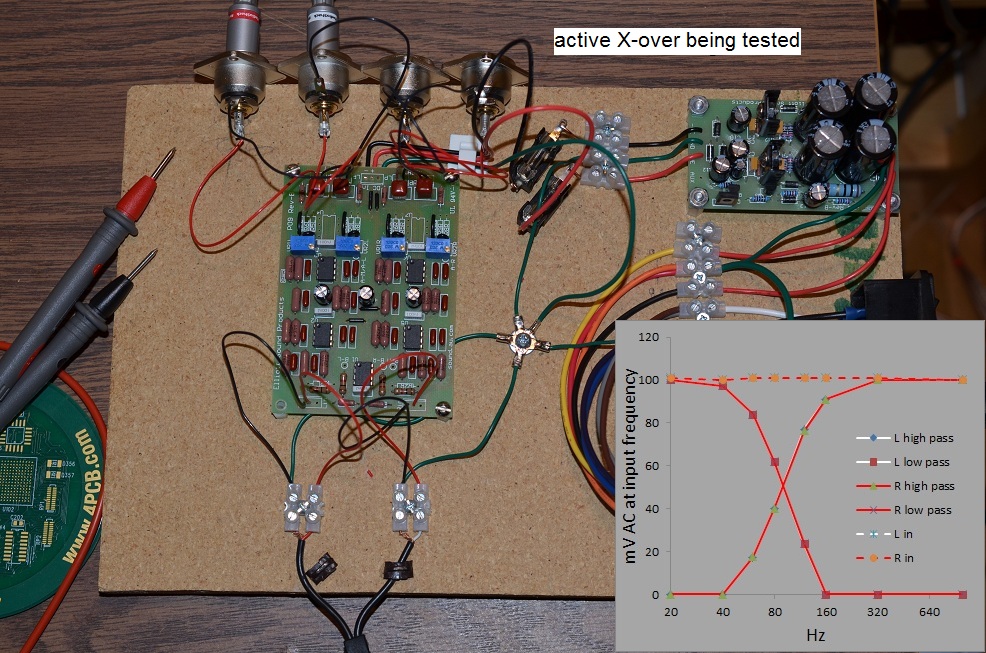

Active X-over
· Elliott Sound Products P09 Linkwitz-Riley crossover built for 80Hz knees. This has a long, sad, story. I built this using all polypropylene caps and Burr Brown OPA2134 opamps, including the optional buffers. The big polypropylene caps wouldn’t fit on the board, so I did things like soldering components to the bottom of the board, and combining series resistors with one 2X resistor to save space. I couldn’t get it to work using my oscilloscope to measure output. I tested and tested and replaced a bunch of components, and posted questions on the ESP forums, but no joy. I got nothing but very low voltage noise at the outputs. I gave up, bought a new board and built the second one exactly as Rod instructed. I used ceramic caps which fit on the board, Texas Instruments TL072 opamps (not as nice as the Burr Browns) and skipped the buffers for simplicity. Again – nothing. Out of ideas, and desperate, I hooked up a CD-player to the inputs, and a receiver & speakers I was willing to sacrifice to the outputs and . . . music! It turned out the outputs need some conductance between positive & ground for the module to work. My oscilloscope does not provide any conductance between the leads. I put 50K resistors across all outputs and ground and tested again with my scope, and it behaved beautifully. Because I took some parts from the first built for the second build, I decided to put the second build (with cheaper opamps and ceramic caps) into the preamplifier. In hindsight I wish I had gotten the first build working (again?) and used it, maybe without the unnecessary buffers.
· Bypass switches, also NKK Switches.

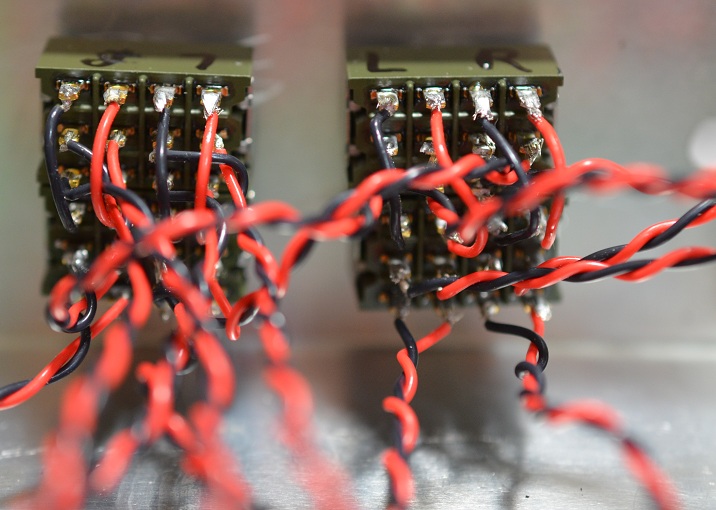

What’s up with all those switches?
· I decided to keep all signal wires tightly twisted with their respective ground wires as much as was possible. The theory (untested) is that this will minimize RFI coming from all those D/A converters, and also prevent unwanted voltages differences from arising as the signal wires went all over the chassis. This means that the gain module and the active X-over bypass switches needed to be 2-pole, 8-throw each!
I divided them up into two 4-pole switches, one for before, and one for after, the module/bypass. I’m actually bypassing 2 modules – gain stage and active X-over - so that’s four 4-pole switches. You can’t imagine what it was like to do all that soldering. Or maybe some of you can.
Miscellaneous
· Chassis by Hammond Manufacturing # 1444-22CWW.
· Signal wiring by Apex Jr. PTFE Silver Plated Stranded Copper Wire, 24 AWG I think.
· Power wire courtesy of Radio Shack, 18 AWG, single stranded.
· RCA phono jacks by Amphenol Audio. These are the best RCA jacks ever, and ground is shielded from the chassis.
· Gold Point Mini-V, 2 channel, 50K (input resistance of my amp) stepped attenuator
· Gold Point 6 pole 2 throw (2 channel) selector
I'm really tired of working on this,and I'm glad I'm finally finished.

pretty neat job ... i like the case ...eventhough hand made its a good job ...
only i see as a negative is the wiring and bypass switching ... i presume that the switch was costy but also the wiring from and to the board will increase crosstalk figures by far ( especially with this type of wiring )
One could go with a couple of relays and minimize distance and crosstalk ...
Just an opinion .... still its a nice "handy" job !!!
Yes. I had to weigh the distortion of the gain module (when not needed) against the distortion of the extra wires and switches. And same with the active X-over. I guessed the crosstalk/distortion of the extra wires and switches would be less than that of the gain module, and the active X-over. Relays may give me the best of both worlds. I'll look into relays, as I know nothing about them. I can also probably shield the wires, and hold them away from the boards and from each other. I also may decide to always use the X-over, once I get the subwoofer amp and subwoofers built.
Thanks for the suggestions.
