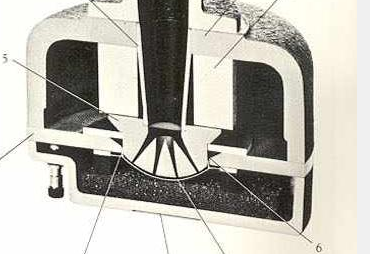

The diffraction slot on a Manta Ray horn makes HF sound hashy when boosted to provide flat response.
A conical horn does not have that problem, and still maintains constant directivity of the initial sidewall angle.
I have compared the same drivers on a "pinched throat" diffraction style horn (I had kind of copied the Manta Ray design, shrunk for a 1500 Hz Xover) and a conical using the Hughes Quadratic throat type transition, and the difference was quite apparent even to my old abused ears.
You could make a quick prototype to verify what I say, just make a round to square (or rectangular, depending on what pattern you want) adapter from wood, and duct tape it to cardboard horn sidewalls.
Since you are going to use 6 horns, you probably don't need over 50 degrees dispersion.
Copying the approximate dimensions of the DSL SH50 would be a good idea, cut four triangles 28" wide, about 24" deep, around 2" at the pointy end where they go to the round to square adapter.
Obviously the cardboard won't hold up at high power levels, but will give you an idea of how good conical horns sound.
Doing the Keele angle break for the last 1/3 of the horn (a good part of the Manta Ray design) improves the sound quality, that feature has been employed in the DSL conical horns.

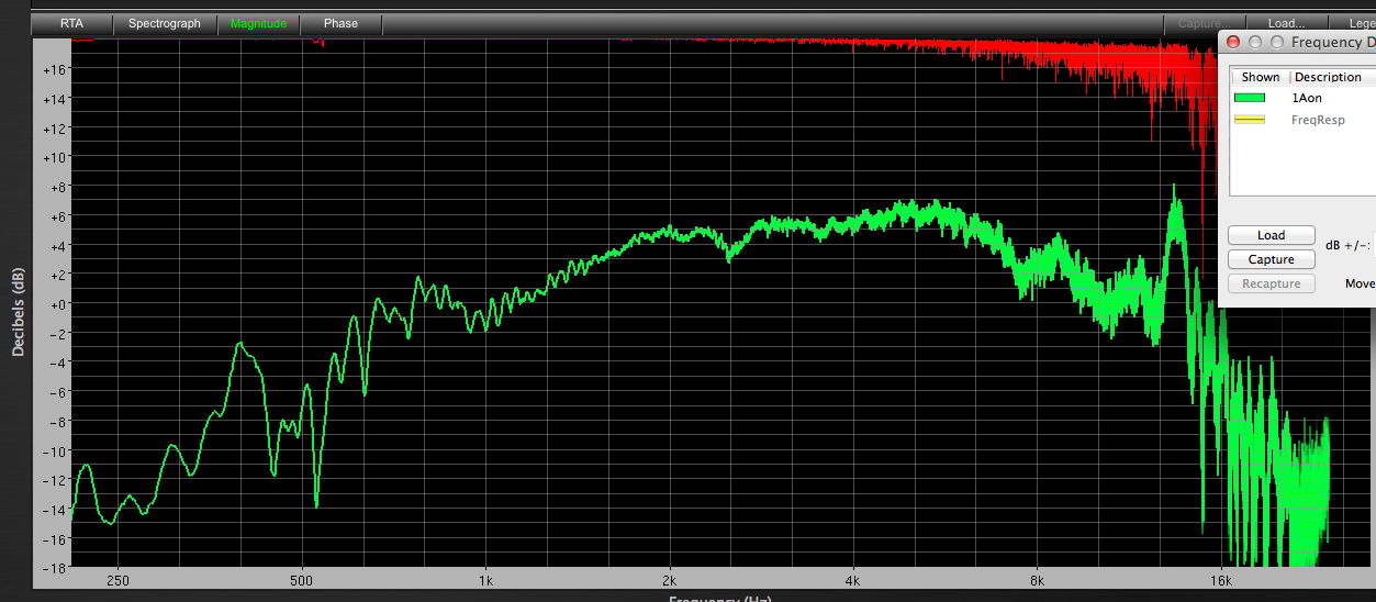

Kindhornman,
You are free to your opinions, but the fact is conical horns can be EQd flat even with passive components, as can be clearly seen in the frequency and phase response of the three way Danley SH 50 using a passive crossover below.
The other chart is of an EV DH1A-16 on a Maltese conical horn, no EQ.
The DH1A and the Altec 288 are similar, though the titanium diaphragm has an upper peak the 288 will probably lack.
The Altec 288 was designed in the days when most horns were exponential, but that does not mean it won't work fine on a conical, as long as the exit angle is faired to the horn wall smoothly.
Art

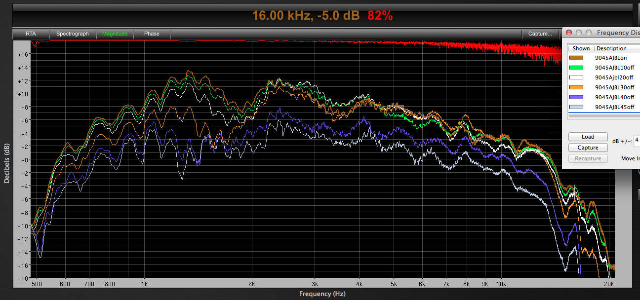

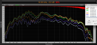

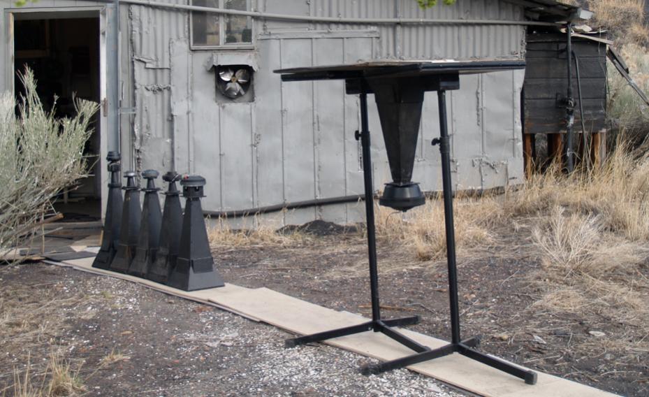

Bear,
You will be surprised by the chart below then.
The chart shows the horizontal response of a small (about 13.5" wide) 90 x 45 conical expansion horn with a Hughes type throat using a JBL 2420 with an aftermarket titanium diaphragm.
The measurements were made outside, on axis and at 10 degree intervals out to 40 degrees, then one at 45 off axis
The "traditional" 2420 throat is over 2" deep and about 11 degree exit angle, but as you can see, dispersion on the 9045A horn is quite uniform, only 2 dB less at 45 degree off axis at 16kHz than the rest of the uniform 6 dB down.
The horn shows a little "waistbanding" (as Earl calls it) around 2000 Hz, and goes omni below 500 Hz due to the small mouth size, but the HF dispersion is quite uniform.
And the horn just plain sounds good, completely lacking the issues we have both heard in the "pinched throat" CD horns.
An Altec 288 has a larger exit than the 2420, which will affect HF dispersion, but if Steve were to shoot for around 50 degree rather than 90 degree, I doubt it would be an issue at all.
Certainly would be less of an issue than the "fingering" HF lobes of a multicell ;^).

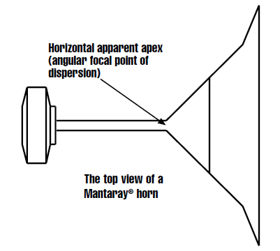

The questions raised by Bear and Kindhornman's objections were clearly answered in my posts #63 and 65, take a close look at the on and off axis response of a conical horn coupled to an "old school" driver.
You can look up Keele's work, and see comparisons of 10 cell horns and all that:
http://www.xlrtechs.com/dbkeele.com/PDF/Keele (1975-05 AES Preprint) - Whats So Sacred Exp Horns.pdf
What I referred to as the Keele break, simplifies all his math, but basically amounts to after 2/3 of the length from the conical portion of the horn, the sidewall angle is approximately doubled, ie, a 60 "breaks" into around 120 degrees at the end. Wider dispersion angles require less than double the "break" angle, as can be seen in the top veiw of a Manta Ray horn.
The exponential throat portion of the Manta Ray was responsible for good LF loading, the conical portion provided excellent pattern control.
Pattern control is of paramount importance in covering large audience with multiple horns, as overlapping patterns create interference patterns, reducing intelligibility.
Unfortunately, the hard break between the throat as well as the long throat section cause distortion problems (Earl's HOMs) and the long throat before the break causes an acoustical center variation with frequency.
Keele fixed one major problem of exponential horns, but introduced several sound quality issues.
Using a small offset horn midrange cone on the same conical horn eliminates the need to cross so low, so loosing the LF loading the exponential section provides is no longer an issue.
It provides a single point source, eliminating a big "elephant in the room" problem- large format horns won't be within 1/4" wavelength of the mid cone driver at the crossover frequency, so by design will have off-axis vertical problems, those problems come raining down from ceiling reflections.
You can build conical expansion 2 way cabinets using your 288s not much bigger than your multicells that will go low enough to cross in to the Gjallerhorn.
If you did decide that you still need supertweeters, you could stick them on top, with the same problems you'd have sticking them on top of any other set up.
You probably won't need or want super tweeters for surround, as it is normally band limited already.

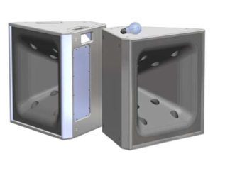

Weltersys,
I will not argue about the polar responses that you are posting but I will tell you I was there when all this Mantaray and other nonsense hit the pro-audio market. It was a marketing tool, these devices were not very successful in the industry, they clearly had problems in actual use. The real reason for the breaks in the conic sections were to somewhat approximate the expansion rate of an exponential horn. Without the last break or section the mouth was just to small to support the cutoff frequencies that were used at the time with compression drivers used without mid horns at the time. EV had their design, it was the fad at the time. I really think everyone needs to go back and read Webster and a few others on the design of horns or waveguides. There is much going on here that seems to have been lost. I'll stay out of the Synergy or Paraline discussion for now, but there are many design issues with both of these on a very technical basis. You may want to overlook those issues but they are there.
There are "design issues" with every type of horn design, I have pointed out many of those issues in this thread.
Like you, I have been around through the introduction and refinement, and abandonment of the pinched throat horns as they made their way around Altec, EV and JBL, and owned quite a few of the latter two back in the 1980s.
Each horn type has positive and negative aspects that must be weighed against each other for the desired application.
I would not advise the use of the Paraline for home use, the negative aspects outweigh the positive.
Any technical issues inherent in the Synergy design approach are far outweighed by the many technical issues it solves.
The simplicity of construction, saving in real estate, reduced midrange distortion, even dispersion, and single point source radiation pattern in my opinion make it a winner for the mid/high portion of what Steve is attempting.
Steve will hopefully make up his own opinion after making a listening comparison between horn types.
