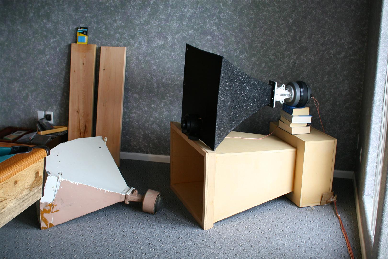

I'm not real fond of EQing the 288 flat in the manta-ray horns. I think if I were to go that route, I use that BMS? concentric HF driver.
The reason I want six of these speakers is for surround sound, so it's not like they will all be playing at once.

The frequency that I need to cover is ~300/500 to 60hz. So a folded horn wouldn't work. I should have more bass than I need with the tapped horns below 60hz down to 15hz.
Your molded horns sounds interesting - got any links?

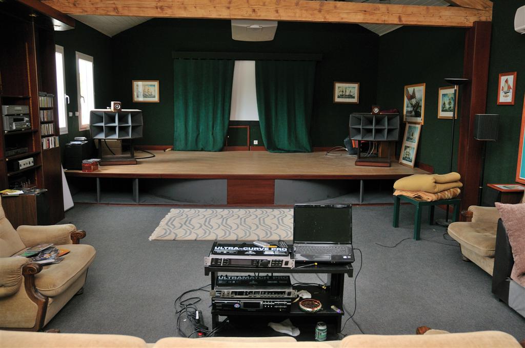

I have a lot of space, but I also want to fit in a 22ft wide screen + space for LR speakers either side of the screen.
I can't put the speakers behind the screen because acoustically transparent screen material has very low gain. It's going to be hard enough as it is to light up a huge screen. I'll need all the screen gain I can get!
Bass will be crossed at 60hz to 4 of Ricci's GJALLARHORNs subs so no real need to go too huge on the bass horns.
I've seen that pic a bunch - comes up every time I search for horn pics. Interesting idea to raise the floor and put in bass horns. That is dedication! Is it your room?
