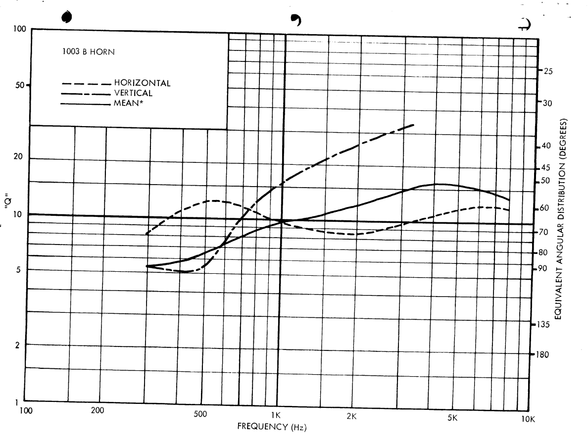

Thanks for all the info and the link. I understand the theoretical limitations of the multicells beaming when used above the point at which the individual cells break the 1/4 wave length rule. It's just in practice where there are peaks and nulls all over the room, how much of an issue is it? The multicells do sound great, but I would love to hear the SH-50's.
Anyway I might be buying a hand full of Altec A6's. At the very least they should keep things moving with the theater build and buy me time to study the synergy horn without holding things up.

FWIW, I run multi-cells but also like the synergy horns. They do different things well. Both are enjoyable to listen to.
1505's? Any incite into pro's & con's?
The 1505s are my favorites. Alas - too rich for my blood. I run the more humble 1005, which isn't bad for a small room. I also own 803s, which are nice, but not as nice as the 1005s.
The only cons I find is that it's hard to get the big multis to play high, ~7-8Khz is tops. But that may be driver dependent. I remember with Westrex drivers on the 1505, I really didn't feel the need for tweeters. They did add some "air" but I usually found it artificial sounding.
I'm a fan of the multicell. I just don't know another type of horn that gives me such a realistic sounding space and timber. Some folks don't like them, but I suspect much of that is on a theoretical basis, not from listening to them in a well implemented system.
