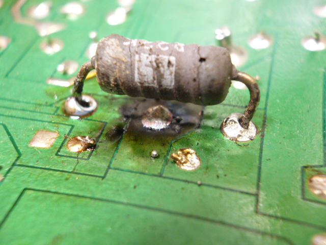

Here is the proof I'm so against PCB's.....this section of a power supply board, failed. The wirewound resistor despite being heat scorched still has the correct resistance; the fault occurred in the copper track which ran under it. After years of expansion/contraction from the heat, the track finally fractured.
Unsuprisingly, many computer aided pcb designs fall right into this trap.

Yes the issues with old cracked/bad solder joints and tube sockets does stain/burn the PCB and really just minor arcing of any kind anywhere is just not good on them, it doesn't take much to blow up and lift a trace lol as well as burning holes through the PCB itself. Some manufactures use a fairly thin board etc P2P has the the advantage as far as reliability in my opinion big deal if a turret eyelet/board blows up or some wires melting relatively inexpensive compared to changing a whole PCB, as far as sound goes it all depends, older P2P designs most had top notch components as well as quality copper/iron but yeah PCB amps are very capable of nice sounds as well, I like the integrated factor of PCB though just feels more organized to me P2P looks like a rats nest but a good rats nest lol.
I do agree though tube sockets should never be being mounted directly to the PCB, its the not question of if it will cause problems its more like when will it lol.
