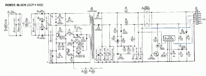

I enclose a picture of the PS1 PSU circuit and again note pin 5 is
active all the time for some reason. Diodes seem to be able
to handle 600v at 1amp.
What ideas have you all got for improving this standard PSU?

Thanks Anthony,
do you have a pointer to where you got the PSU schematic from ? I'm having trouble reading some of the values

If you look at the schematic for the Power block there is an IC at the right called a M51957BL. I could not find a sheet for this, but I did for the B variant.
http://pdf1.alldatasheet.com/datasheet-pdf/view/887/MITSUBISHI/M51957B.html
It looks like it might sequencing the powering up of the various stages as you suggest. The value of the Cap connected to pin 4 (of 5) determines the delay.
It looks like it delays the voltage to pin 7 until it sees a voltage on pins 1 & 3. If you hit the reset it. datasheet quotes a time delay of 100ms with a 0.33uf cap. the schematic shows a 1uF / 50v cap here.
So, I'm no expert but perhaps, as has been predicted, some players expect to see a voltage on pin7 a few hundred milliseconds AFTER the voltages on pins 1 & 3 ?
