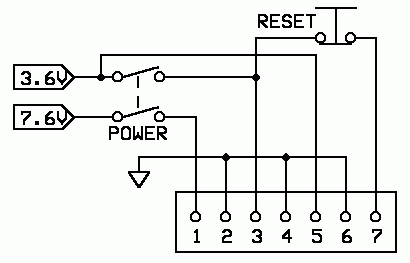

Hi
I was looking at the diagram for the
psu connections and see that according
to this pin 5 is always connected once
the power supply is plugged into the mains.
So if when making a new PSU for the 1002
would you say having a delay solenoid that
switches the other lines on once the new
custom mains switch for the LM317 based
PSU is activated? On the standard PSU
is Pin 5 always alive when the cord is
in the back of the player?
regards
AnthonyPT
Hi
If the SMPS PSU does sequence the power to the
pins at start up on some 1002/1001s, maybe it is
a generation thing. So early ones needed the sequence then
the later ones did not due to improvements to the Mother board.
NB Just a theory :)-)) The following maybe wrong!
_________
So plug SMPS PSU Pin 5 gets voltage (bypassed switch)
Then when you turn PSU on and Green Led lights first
3.6v connects then 7.6 volt connects moments after. This is for Ps1 1002/1002 early models
Pin 5 (on with cable 3.6v)
Pin 3 & Pin7 (when power switch is switched on)
Pin 1 7.6v a few millisec after.
So if we emulate this if it is correct all PS1 1001/1002s should
work no probs. I guess try it and see!

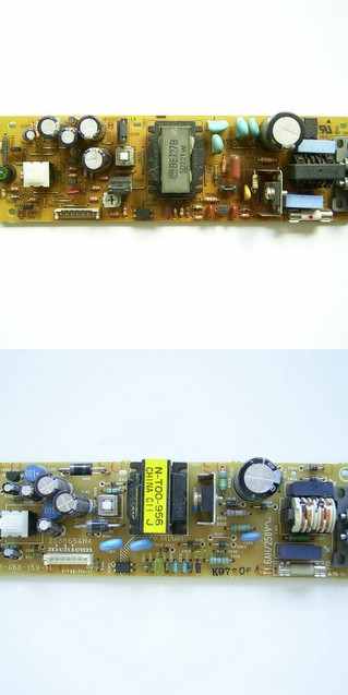

Hi Puffin
This PSU thing was very much a 1002 thing.
It probably does not happen with 5502_5552 etc.
At the moment I only have early Psu 1002s as I gave
away the ones with the later power supplies to other
friends etc as presents.
I cannot check the theory out and if I did would want
LM317 PSUs and old and newer PSu based 1002s tto test.
To identify the PSUs I enclose a picture. Old and hot
on the top and new and cooler underneath,
Hope this is of use.
regards
AnthonyPT
