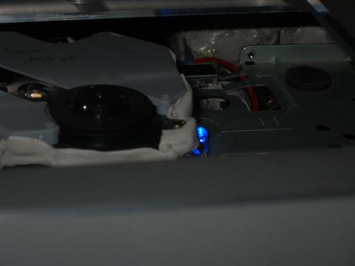

I have some sticky bitumastic damping material, and it crosses my mind that the metal casework that the CD transport sits on might be able to be damped a bit.
Anyone have a view on wether this metal is a significant heatsink. I guess damping underneath might be better, assuming clearance. I notice Dommi that you damp everything with a grey compound .

Good morning,
you are right, the gray compound is from car accessory, its a material for car bodys. Go into a car accessory shop and ask for. This is a verry good damping material to avoid resonances. I will post a picture with a blue led mounted. You can make some other modifications on the Laserunit. One is to remove the little black cap over the lense, and to paint the margin of the lense black. The other is to remove the complete black cap from transport. You have only to fix the copper cable in a way that it can move with the transport.
Regards Dommi

Thanks Dommi,
What is the reason for the blue LED ? :scratch1:
I assume i't not like the Car or PC case modders ("pimp my playstation") :D
I noticed that the transport is supported in 3 rubber tubes, but on one side this floating is damped by a plastic tab which rubs against a small rubber pad attached to the metal subchasis. I guess removing the tab and the rubber pad will allow the transport to 'float' better ?

Re: Re: Re: mass damping
I generally recommend to remove the small rubber pad glued on the metal internal cover of the PS1 indeed!
