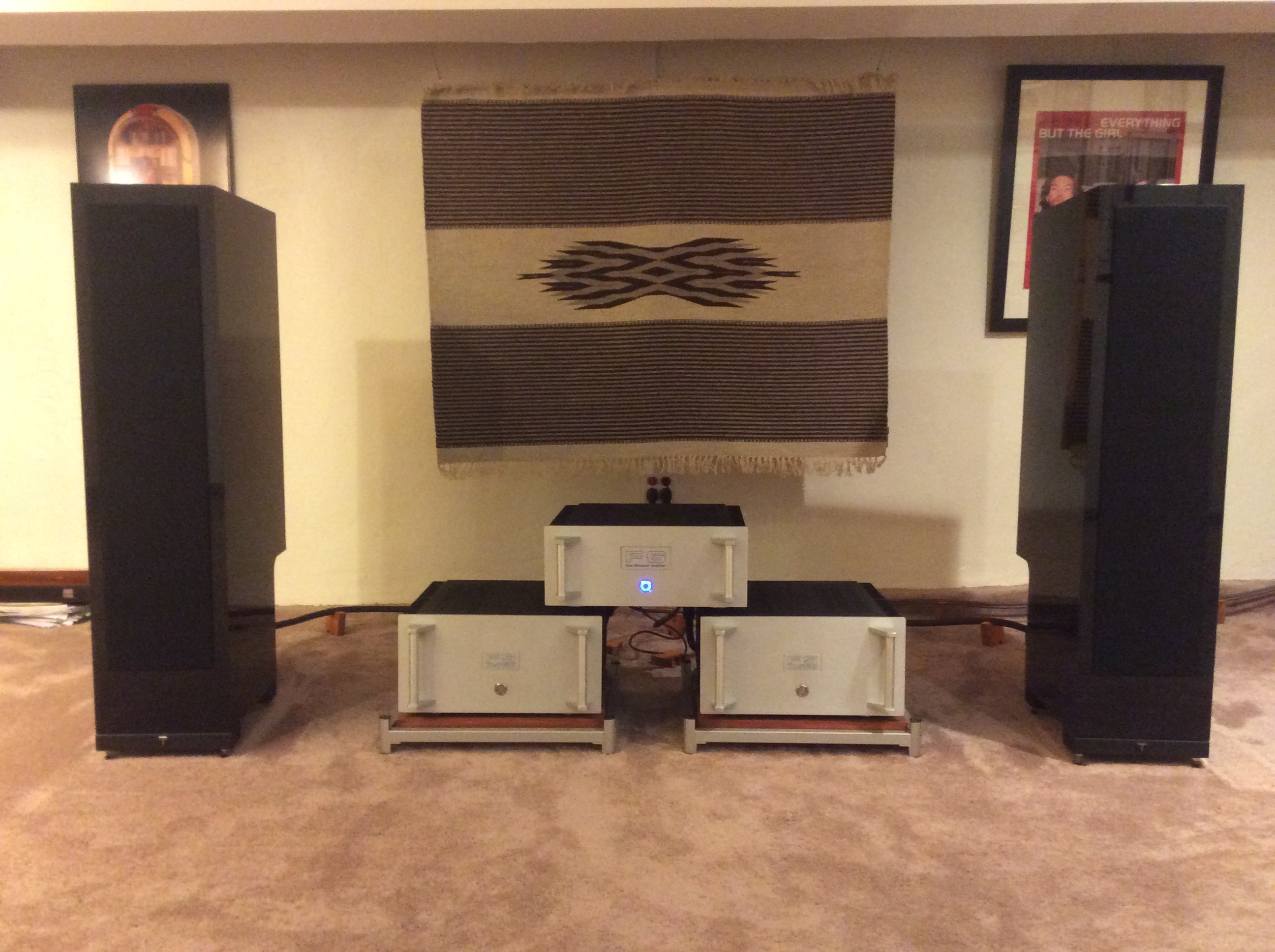

Folks:
Thanks again for the kind words!
My initial impressions are very positive; I let the F6 burn in overnight using my modified FryBaby2 as the source and now, about 11 hours later, it's playing in my main (basement) system. On the slightly warm side of neutral, wide soundstage, and a little forward. The F6 sounds natural, in the sense that with eyes closed, the presentation sounds real.
Oh, and my Elsinores are loving them. There's gobs of headroom.
Pretty damn cool.
I know most of you already have an F6 but, in a post-COVID world, you're all invited over for a listen.
Scott

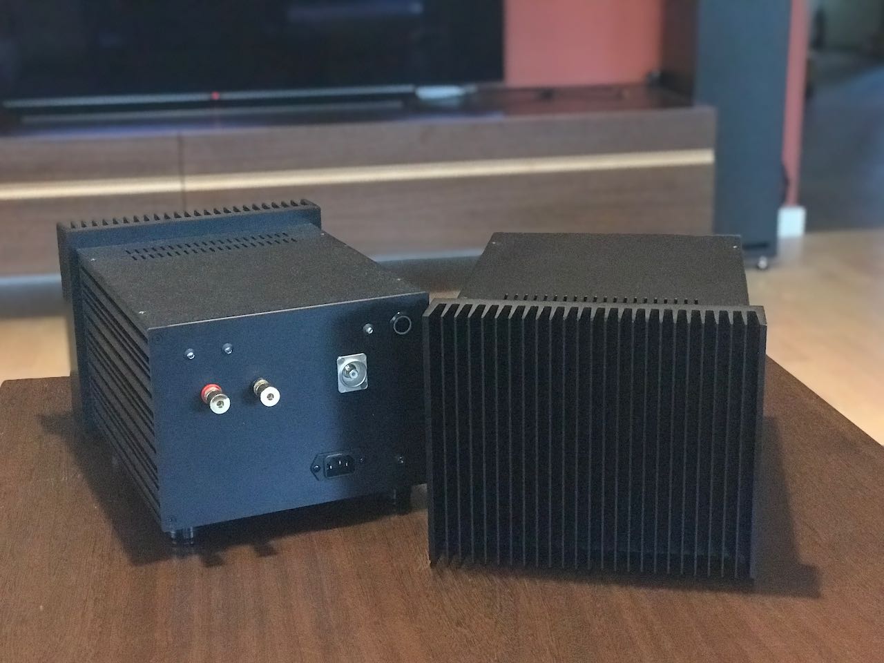

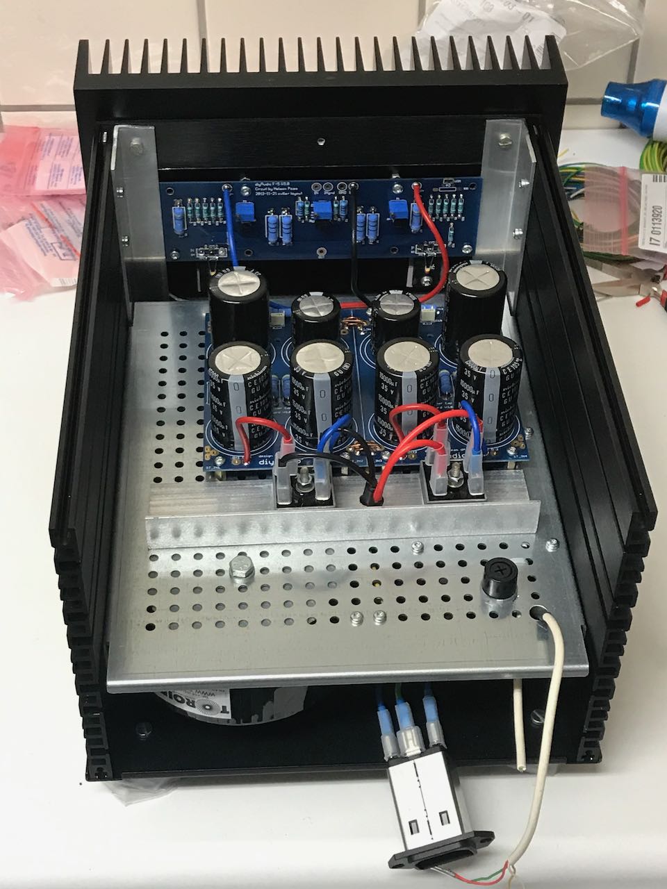

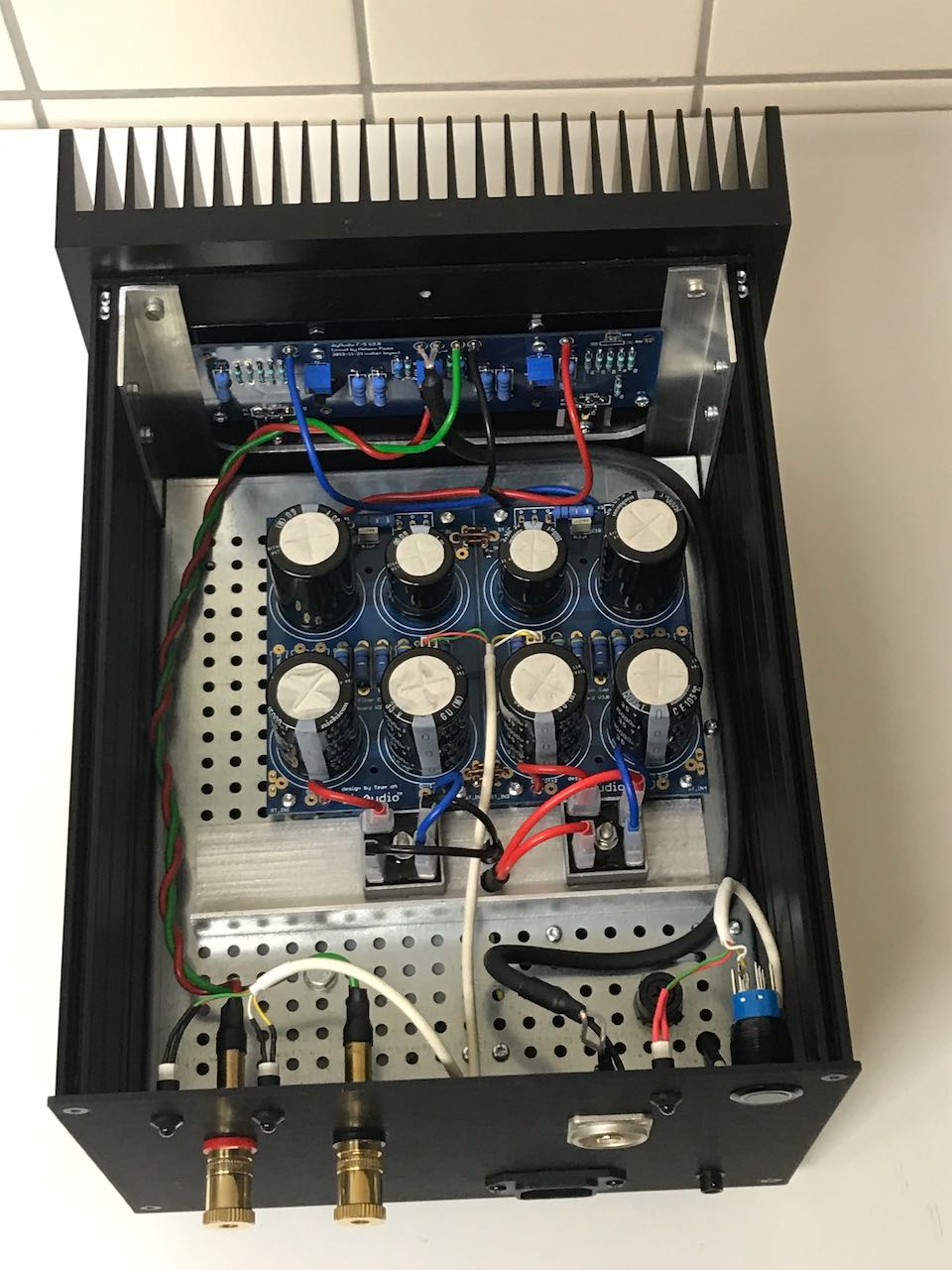

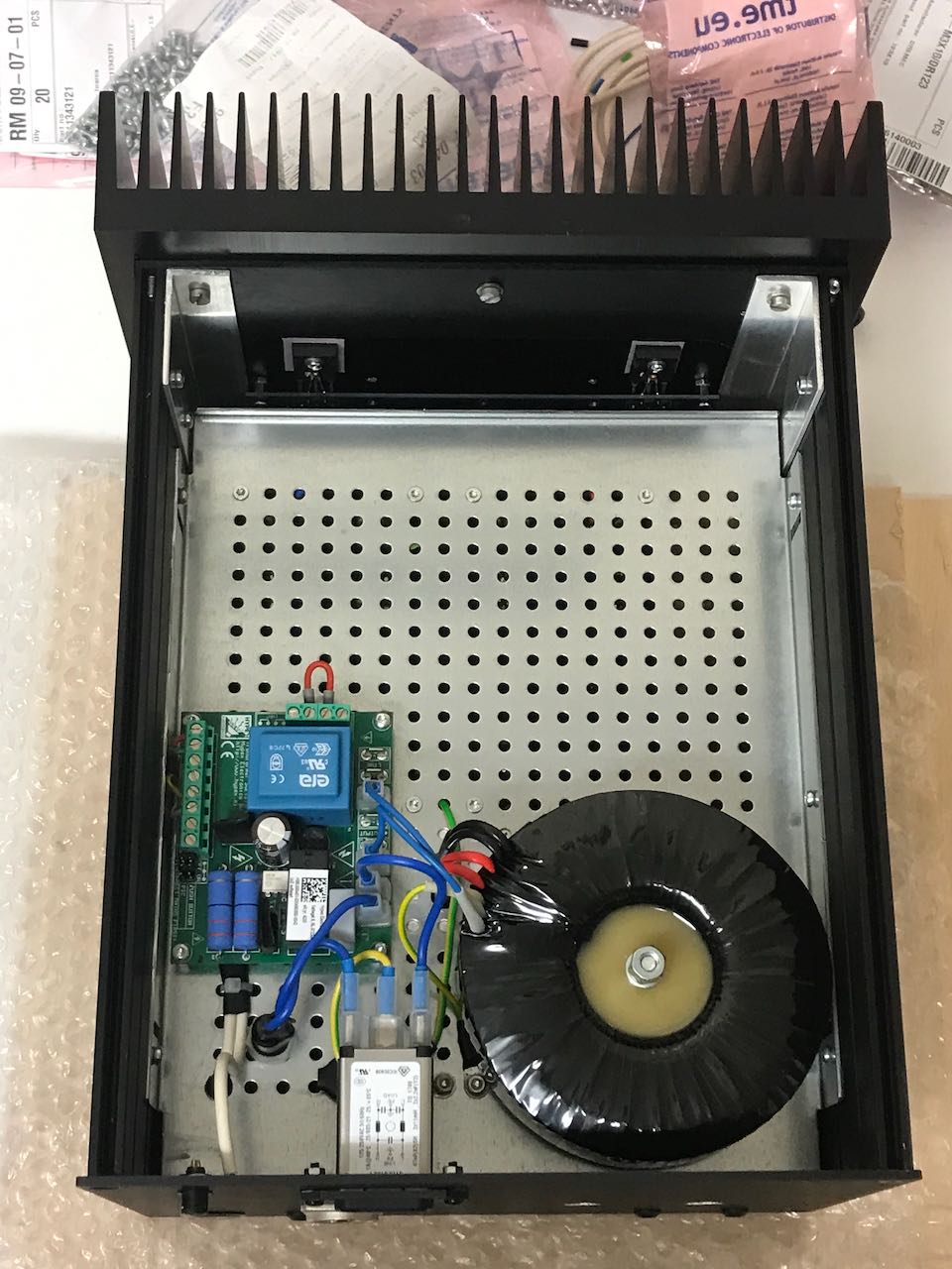

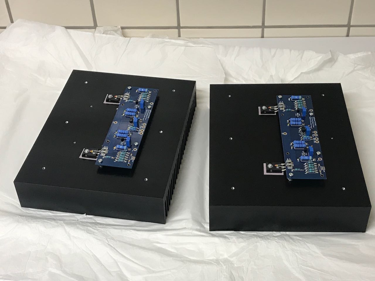

Hello everybody,
Posting some images of my recently completed First Watt F5 monoblocks.
It was a fun project. Still need to build speakers to properly test it :)

you made custom purchase at Modushop, as whole case, or you bought elements of your choice, to complete it?
I have purchased standard 4U 230mm wide Galaxy cases from Modushop and mounted 250x200mm heat sinks on the front panels myself.
It turned out not too hard to do. At least not harder than making back panel holes for AC socket or drilling and tapping heat sinks :D
