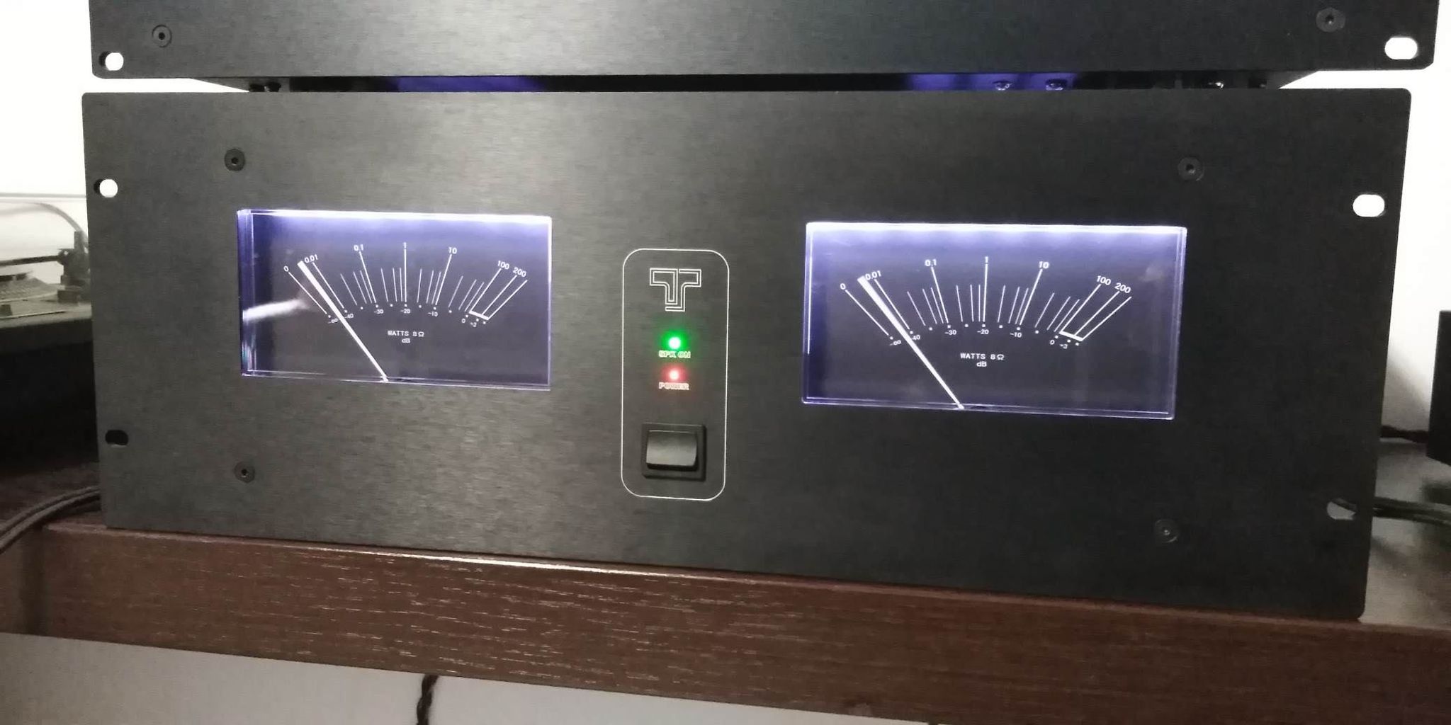

Nice work! Reminiscent of the original Aleph series amps (albeit from the front only). How do they sound?
They sound clear. There is no obvious technical problems, no humming, no noise.
However I do not have proper speakers at home to properly appreciate these amps (how lame is it!). I am thinking of making Troels Gravesen TQWT speakers to match them. But it will take some time.

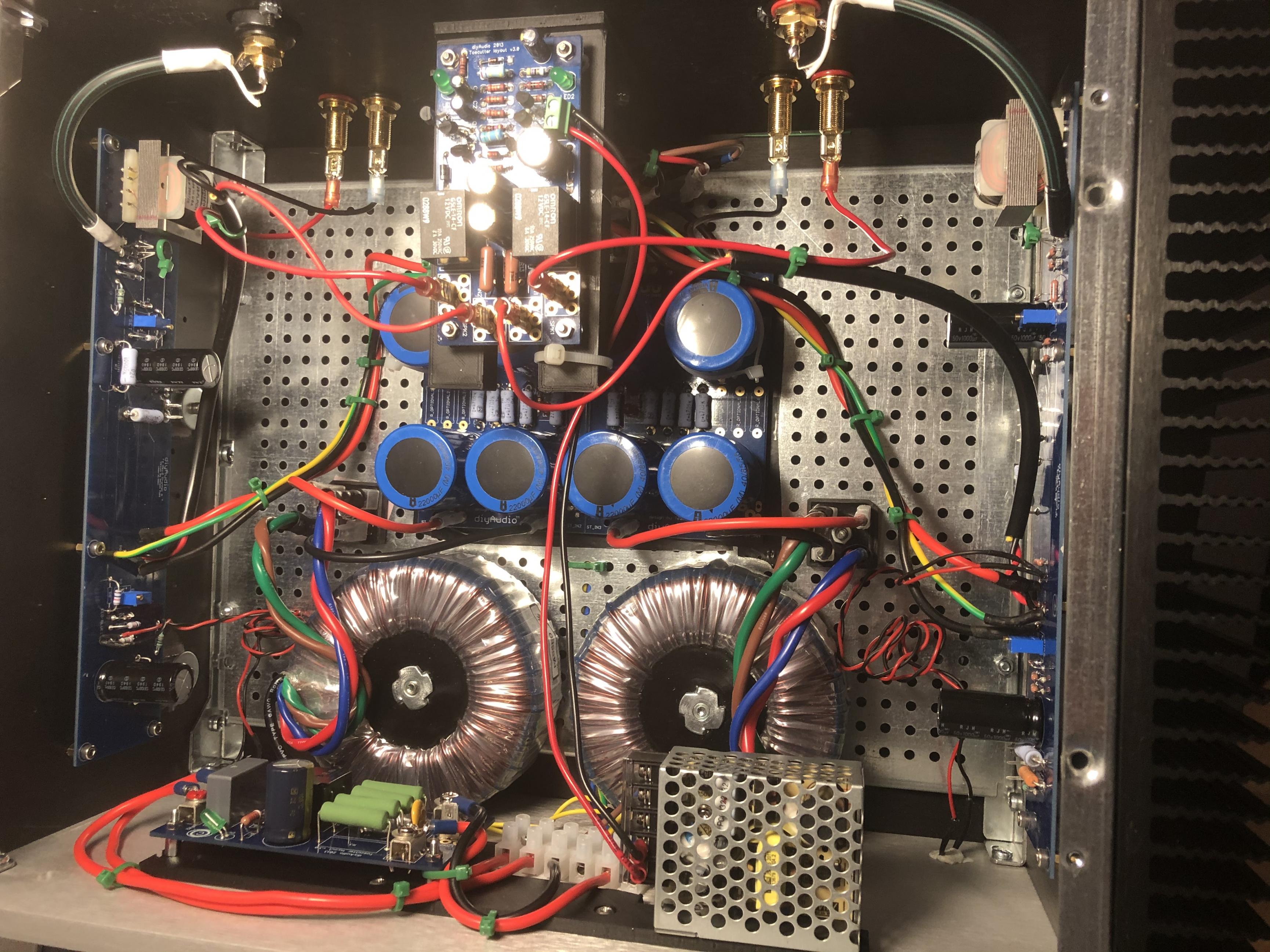

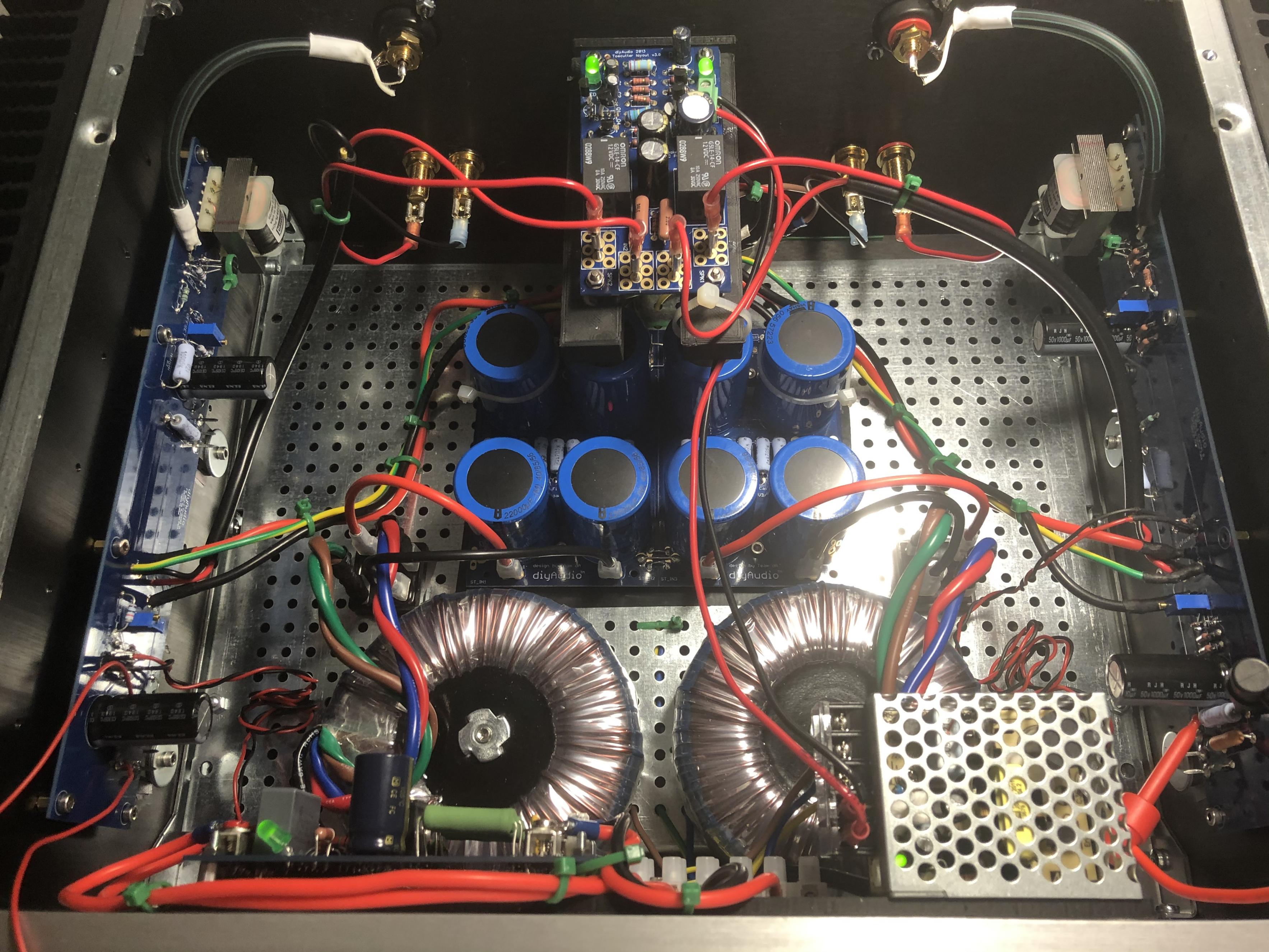

My F6
some fine tuning left :)

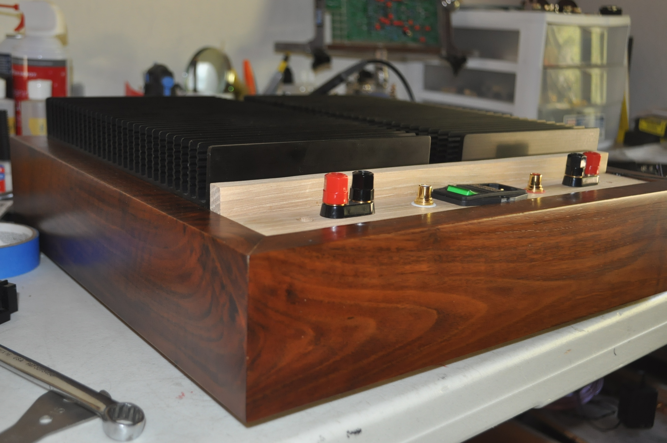

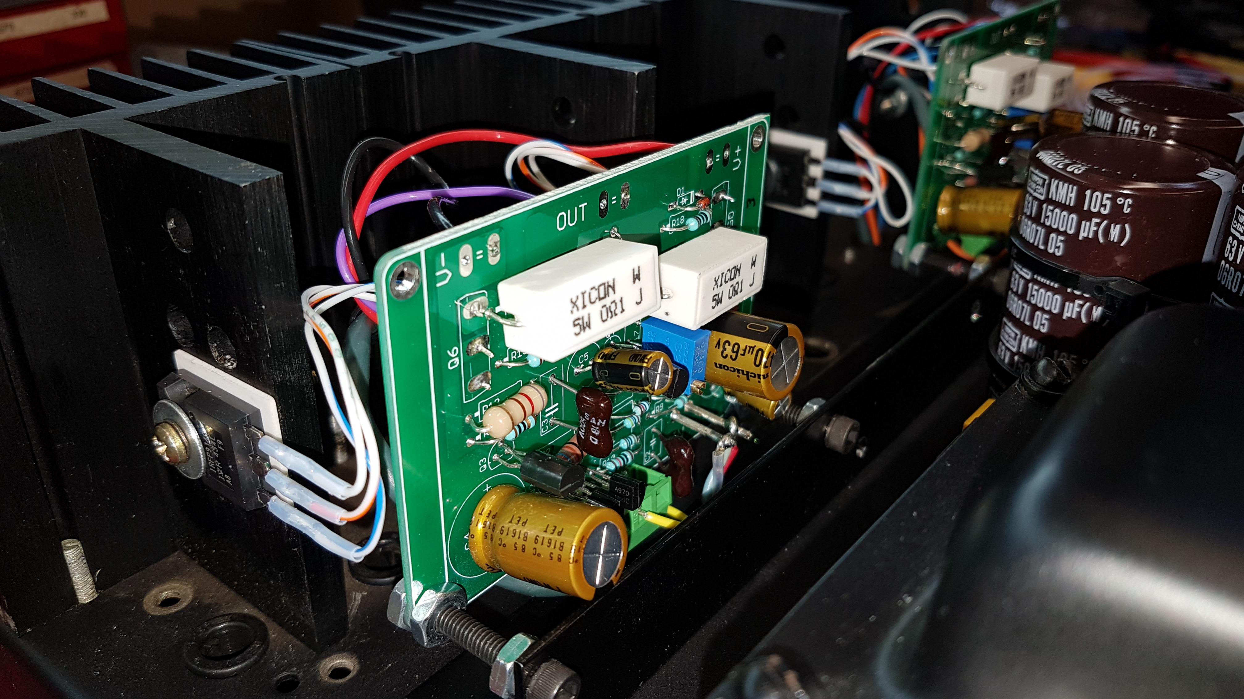

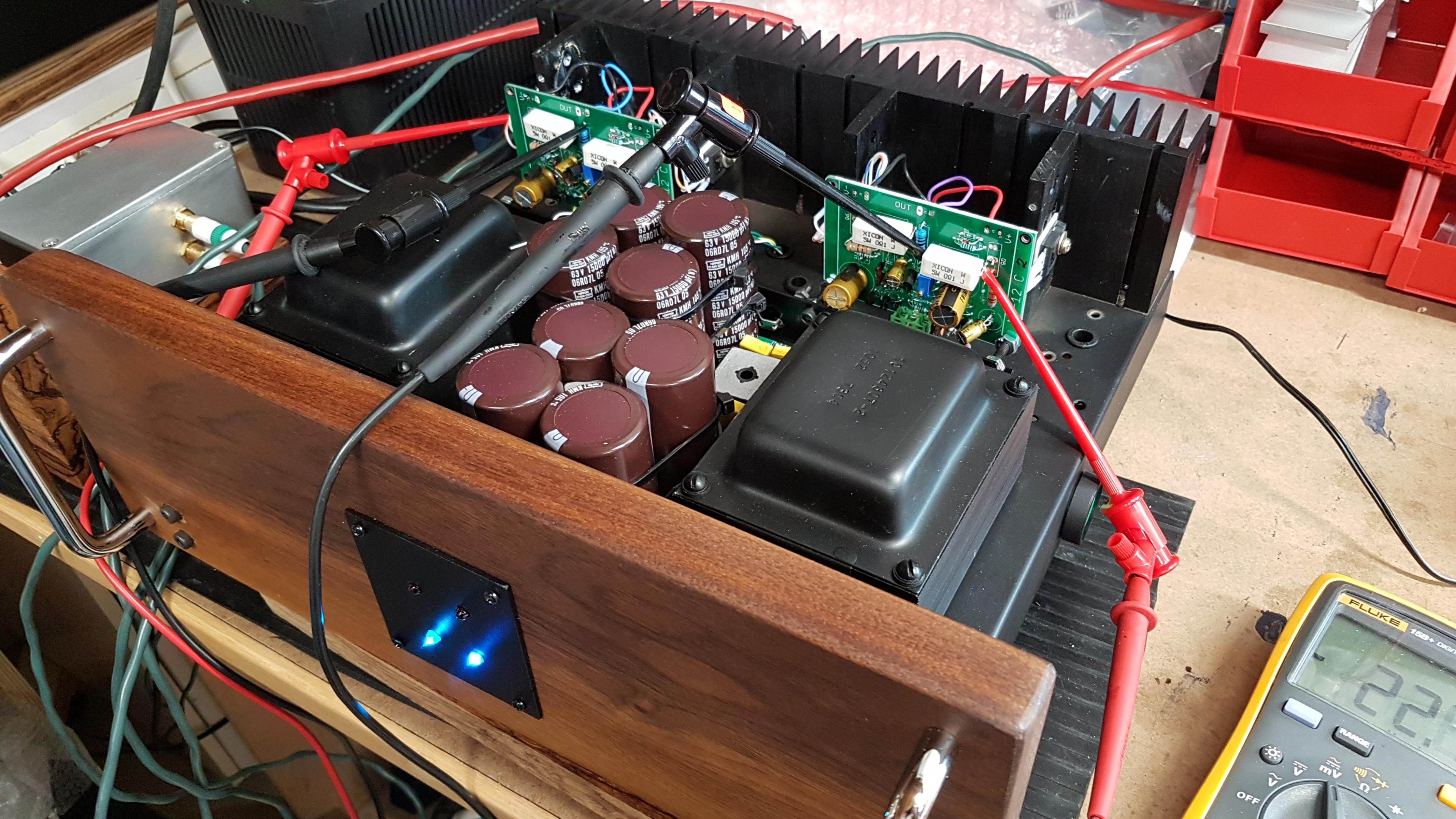

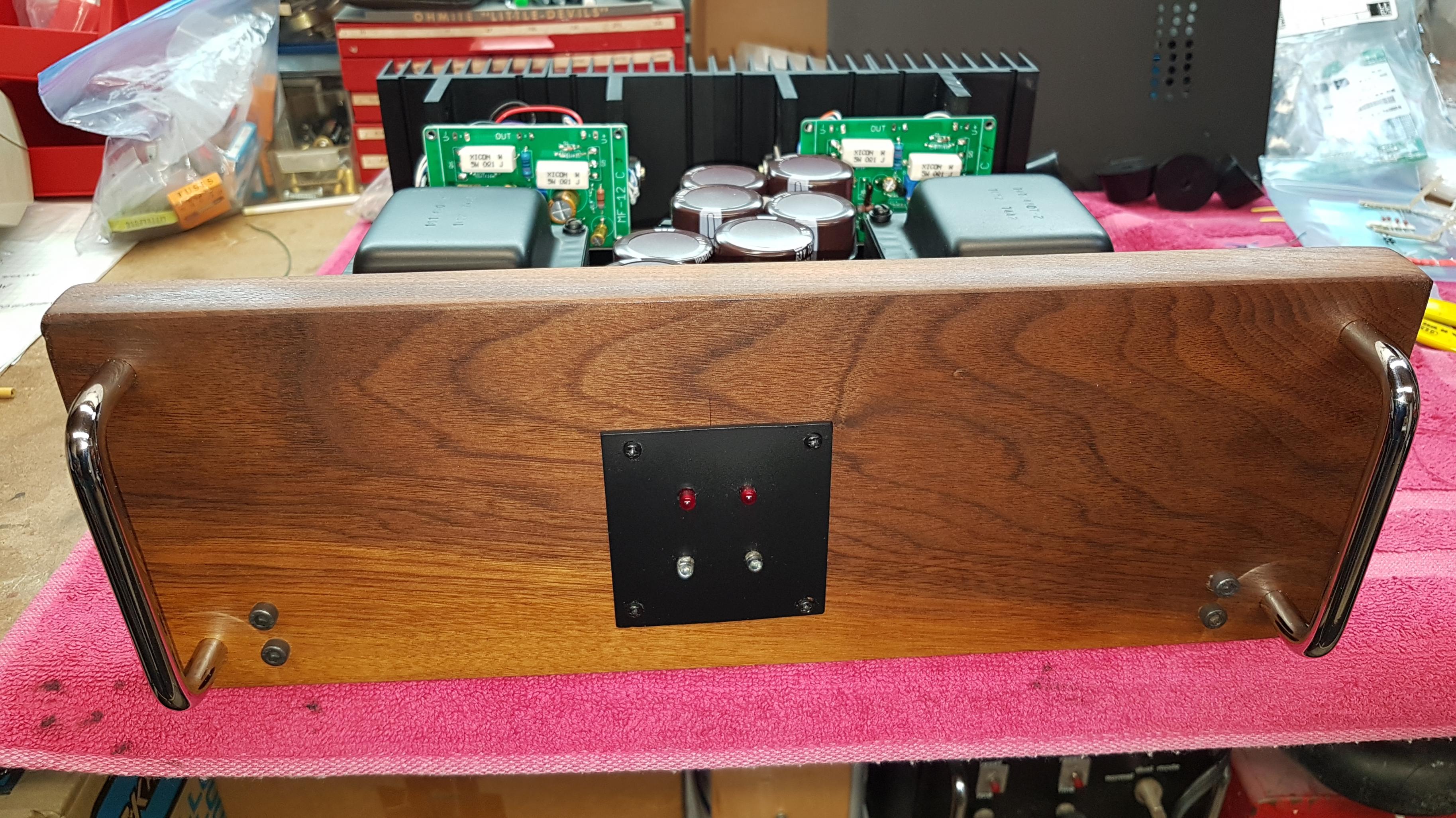

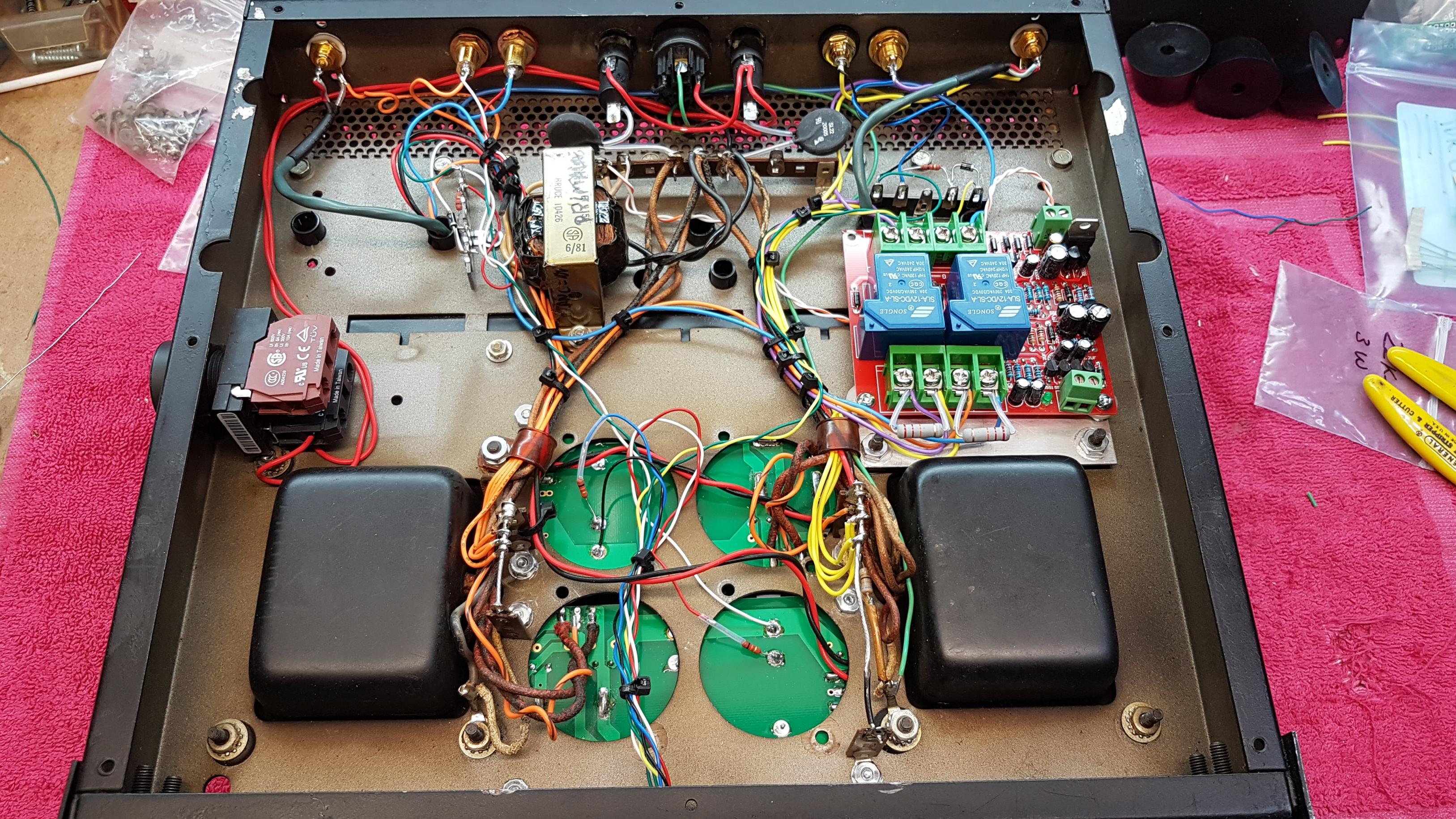

Here' s some pictures of two stereo power amp i did based on PassLabs Citation MOSFET complementary outputs IRF240-9140.
PCB is from member here TAZZZ.
I've had two of those HK Cit12 and i only kept chassis, power transformers.
Did exact as per schematics with some 1% resistors and bourns 15T trimpot for bias.
Both amp do have a relay delay turn-on feature protecting speakers.
Bias at 200mA and offset below 30mV.
Heat sink temp runs about 90F,
Front is solid walnut with blue LED for each B+ and clipping indicator.
I have 60000uF per channel and B+ is +/-40,5 Vdc.
Lots of clean power in 8 and 4 ohms load, great sound
Thanks to Mr. N. Pass !!
