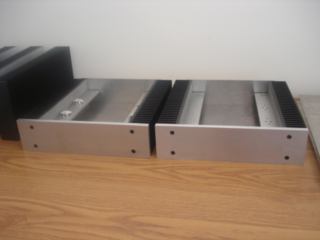

Do the central heat sinks dissipate enough heat mounted that way?
Yes, I use raised power supplies (32V) and increased bias (2,8A) for ~50W
Heatsinks are ~23C above ambient. Note: Also the front and back panel are dissipating as well as the 2 panels that hold the amp modules.
I made the whole thing in such way that I could add another 2 heatsinks in the middle.
3mm plate is cut on guillotine.
10mm was cut by saw. Any rough edges I sand back if required.
Originally I wanted perfection, but I realised 90% perfection is much quicker. To get the extra 10% it takes a lot of work, which means a lot of time.
I'd rather spend that time building and listening to more amps, hence the reason for building 7 cases (42 is too many). With 7 cases I can compare several designs at any one time, and in the process hopefully learn something.

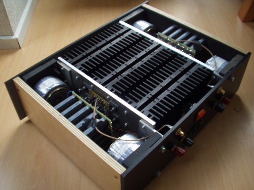

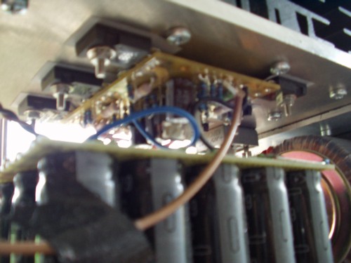

AX-200
HI
I build this AX-200 a couple of years ago.
The only thing I changed are the resistors replaced with coils between the capacitors in the power supply.
Rob
